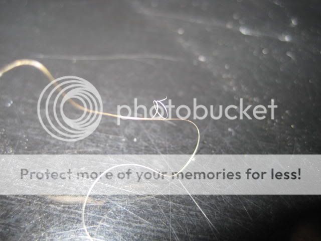

Finally got the S110V to whittle hair! And it did so with a steeper-than 42° inclusive angle! It very barely whittles hair with my limited skillsets, but it does it. Here's the pic:

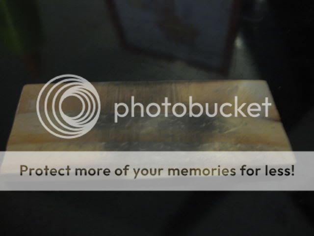

Needed two secret weapons: 1. Instructions from knifenut1013 and 2. A piece of wood smeared with diamond paste:
