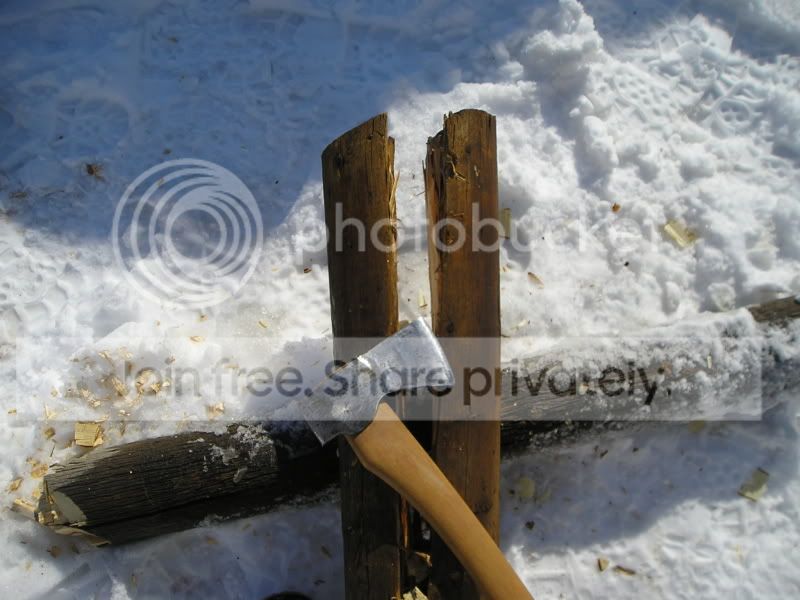

Next you need to split that log in two, making a quick wedge will make some fast work of it, so first you need to make the wedge.
Next you need to work your way down with the wedge, splitting the log. The thing is, you need to make sure your wedge is the thickness of your axe head, that way your able to keep hitting the wedge when its deep into the log.
Split the top a little to make it easier to insert the wedge, then work your way down.

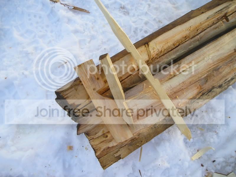

After your done this, your going to need to start making the components of the trap, by the end you should have five pieces in total, that means the two parts of the log, and the three innards parts. Here is a look at what they should look like.
continued.

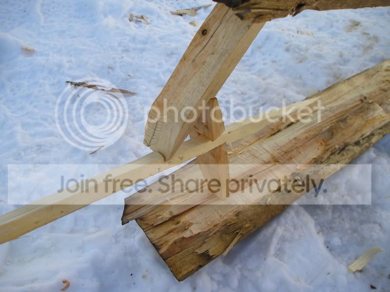

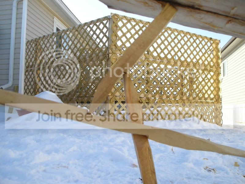

Next, you need to work the whole thing together. This can take some time depending on your skill level, but after making a few of these you get the Idea pretty quick, some extra notching is usually needed in the final product, but eventually it will look something like this.
So there you have it guys, if you have more questions feel free to ask, BTW this is what I caught.:D

That trigure looks pretty wicked bro!
How hair is it?
its not bad, I would like to make one a little more thin and twichyer, but this wasen't bad at all.
What if you notched the top part of the trigure stick to meet with the 90 degree part of the center pole? The heavy weight of the log should apply enough resistance to keep the trap up, and all the squirrel would have to do was lightly touch it too set it off.
Just an idea to play with....
nice trap! just a thought, but maybe tie a string to the trigger stick and then tie the other end to the other end of the trap, that way it could be triggered throughout the entire length.
Both great Ideas, Ill try it out tomorrow and put the pics up here.
And HT that is a great looking figure four, that is one trap I don't try enough of, might have to make one tomorrow as well.:D
I'm no expert on traps but here are two suggestions for your consideration: (1) I like to see the falling weight relatively close to the ground so that the animal has less time to escape (or be injured but not killed). What do you think about shortening the two vertical pieces of wood somewhat? (2) In the event that one or more of the trigger pieces remain between the two log halves after being tripped, it might be better to have thinner trigger material. The thinner any trigger material trapped between the logs, the less likely it is to interfere with the most lethal impact on the animal.
