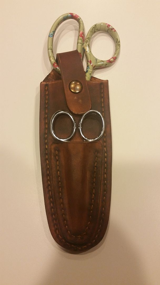

I wanted to thank you for all of your posts and responses to peoples questions. I found them to be extremely helpful and the deciding factor when choosing to invest time and money in learning to work with leather. I just made this two scissor travel case for mom when I was home for the holidays. It's not perfect but every time I make something I learn and improve.
Thanks sir, Nicely done, innovative too!
