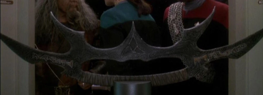

My wife bought me a Bat'leth for my birthday, specifically the Sword of Kahless:
As you can see it is kind of intricate and I'm not very good at sharping even a pocket knife as it is. Is there anyone in the Little Rock area who would sharpen something like this?
Thanks a lot in advance
I don't think those things are meant to be sharpened,aren't they just more for show then actual use? And if you did sharpen it what would you use it for?
Well technically no, they are "display" items. But why have a sword/blade that isn't sharp and couldn't be used? That just doesn't make sense to me. I would use it for anything, it would probably just sit on the wall and I might slash some cardboard every now and then to impress my friends. Anyway, know anybody in central Arkansas that would do something like that? That thought of doing myself makes it just makes me cringe.

Depending on the alloy and the heat treatment (or lack thereof) it may not be possible to sharpen it effectively. Heat treating (i.e. hardening) a piece of that size and complex shape would be expensive, so I wouldn't be surprised if it is actually not hardened.
Now, let me add that I obviously am speculating here; I don't know anything about your specific piece. I have seen this exact design copied in high-quality steel, hardened, and sharpened. But, because of the size and complexity, I was expensive; I don't recall the exact price since my interest was a passing curiosity, but I seem to recall several thousand dollars.
Do you know who made your piece, maker's name or brand name? That would help a lot toward determining it sharpenability? So you know what material -- hopefully, what specific alloy -- it's made of?

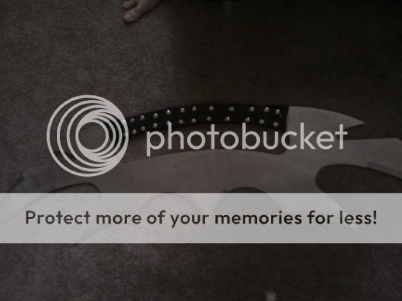

I like the look of these better. And I don't think mine is of a quality to make it useful as a weapon. It's pretty thin.
P.S. Here is a picture of MY bat'leth.
