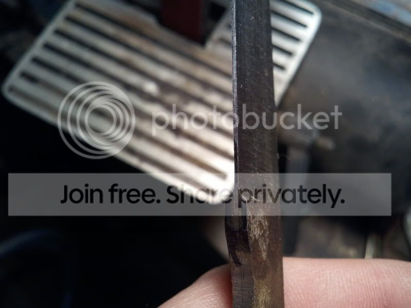

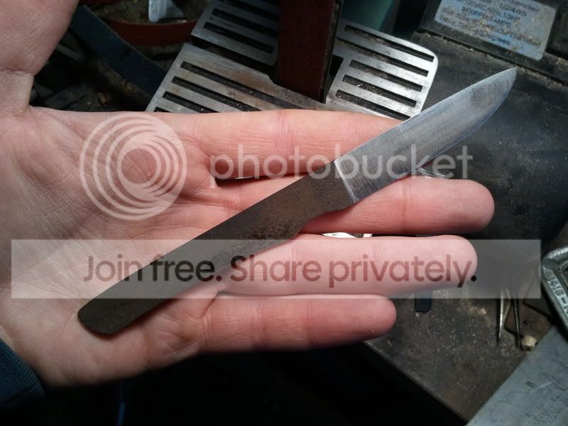

I had this scrap of 1084 kicking around the shop and I got to looking at it and just started grinding. No layout, no plan, just freestyle grinding. Sometimes its more fun that way, just to see what knife is inside that piece of steel.

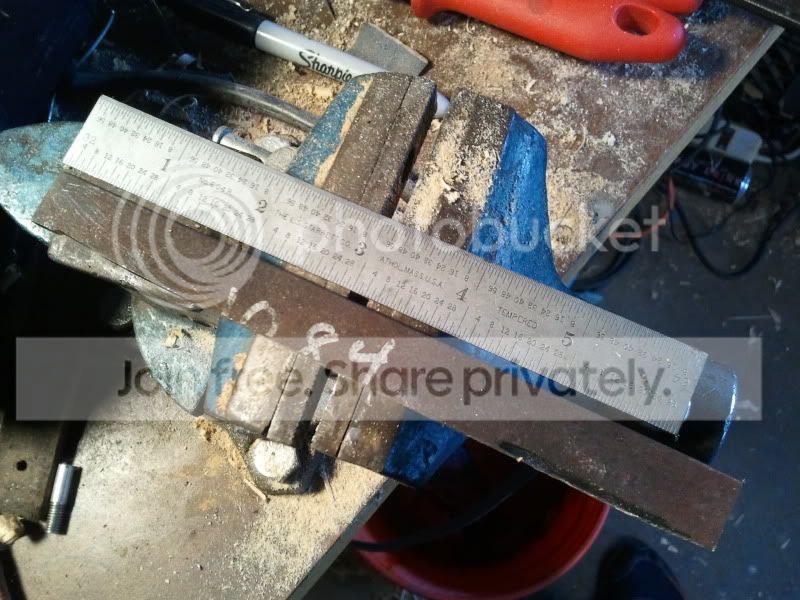

It started as a 5/8 wide, 6 3/4 long, 1/8 thick piece of rusty and pitted 1084. I envisioned a small B&T, hiding in it. This is where it went from there...
As you can see I ground the bevels off the top of the spine, this was intentional so when I ground the ricasso and tang flat it would bring the grind down just to the edge of the spine, hopefully!

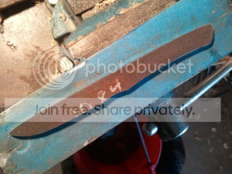

This is also the first knife I have ever marked! Big step for me. Nothing fancy, just basic letter stamps of my initials.
This knife was ground with a HF 1x30, and cleaned up the details by file. Just a bit of sanding to get to a good 320 before heat treat and then to finish it up. Still thinking about what to scale it with.

That's looking good Xander. I make paring knives that are pretty similar to that minus the choil, they are great little knives. What are you thinking of for handle material? Wood, micarta?
Thanx Matt! I have been trying to figure out if I should give it to the wife as a parer, but its about .117 thick right now, so just a little fat for a a paring knife. Plus it gives me an excuse to carry it myself!

That is looking good!
I really like the sleek lines. The stamp looks great too, those are tough to get right!
Nice little scalpel! Graham's first knife was a scalpel. I hope this doesn't mean you're going to stop making minis.
Thanx Charles! I like small knives, this was fun to just start grinding on to see what it turned into!
