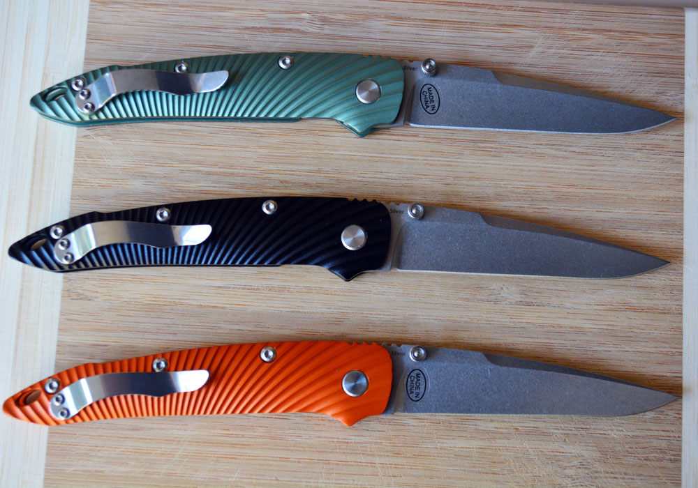

The Sliver is okay if you get it cheap enough. I thought the pocket clip was one of the worst Kizer has done, the aluminum handle is slippery even though it's grooved and it's not a flipper. Other than that it's a well made knife.
Apparently it sells quite well in Europe.

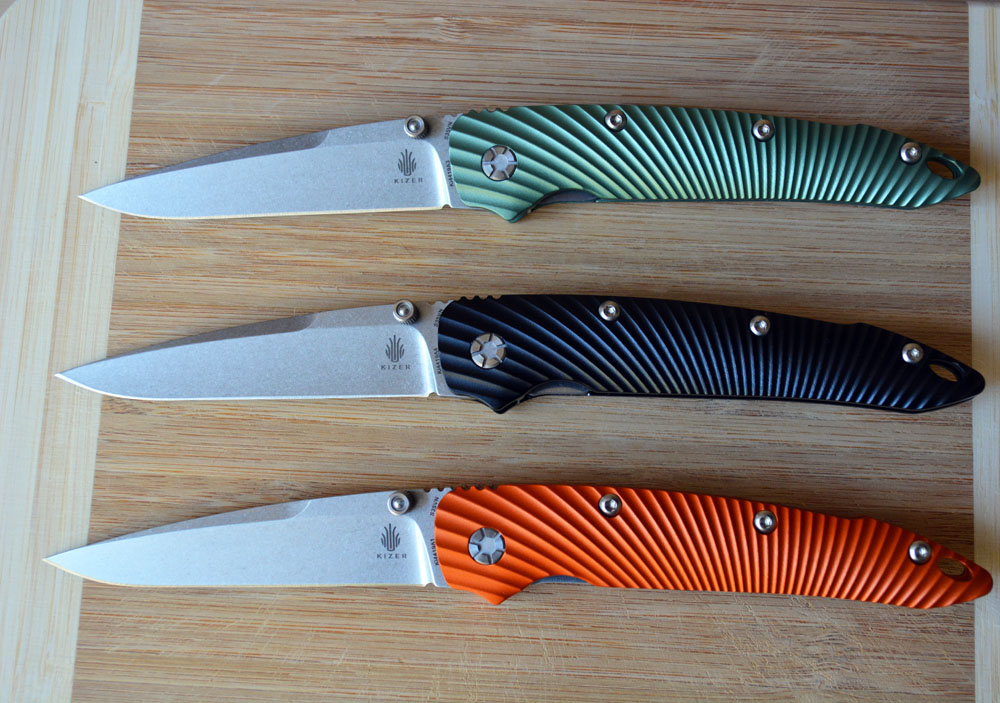

While handling the Sliver, almost non stop for the past day, one of the scale screws fell out. I then took all of the screws out and put loctite on them. However, I didn't try the pivot yet. Does Kizer loctite their pivots, and if not, what do you recommend using to get the screw out? It seems like a (very thin bladed) flat head screwdriver or an allen key. What's the recommendation?
KIZER does NOT Loctite their pivots.
Do not use a flat bladed screw driver. There’s no size that fits.
I can’t remember the size off the top of my head (and I’m travelling this week) but it’s a Star Driver that fits that old style pivot. It’s a bigger one like a T10 or T15 size.
Thanks for the reply. I watched a youtube and the guy said it's a 4mm hex key and sure enough, fits like the proverbial glove. Yes you are correct, there is absolutely no loctite on the pivot or the scale screws, just on the clip screws. I put loctite on the scale screws last night and teflon (plumbers) tape on the pivot. Works like a dream. This is a sweet little (big) knife.

Kizer definitely uses loctite on pivots and screws but not very consistently... one batch they do it the next batch they don't.
For the old type pivot screws (there are three different sizes used on different models in the past!) it is possible to use a modified flathead screwdriver. One that is wide enough to bridge the gap between two opposite grooves will be too thick but grind it down a little and it will be the perfect tool for the job. It is also possible to use a Torx bit and for the Sliver the correct size is T27.
