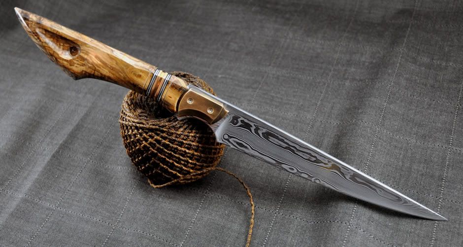

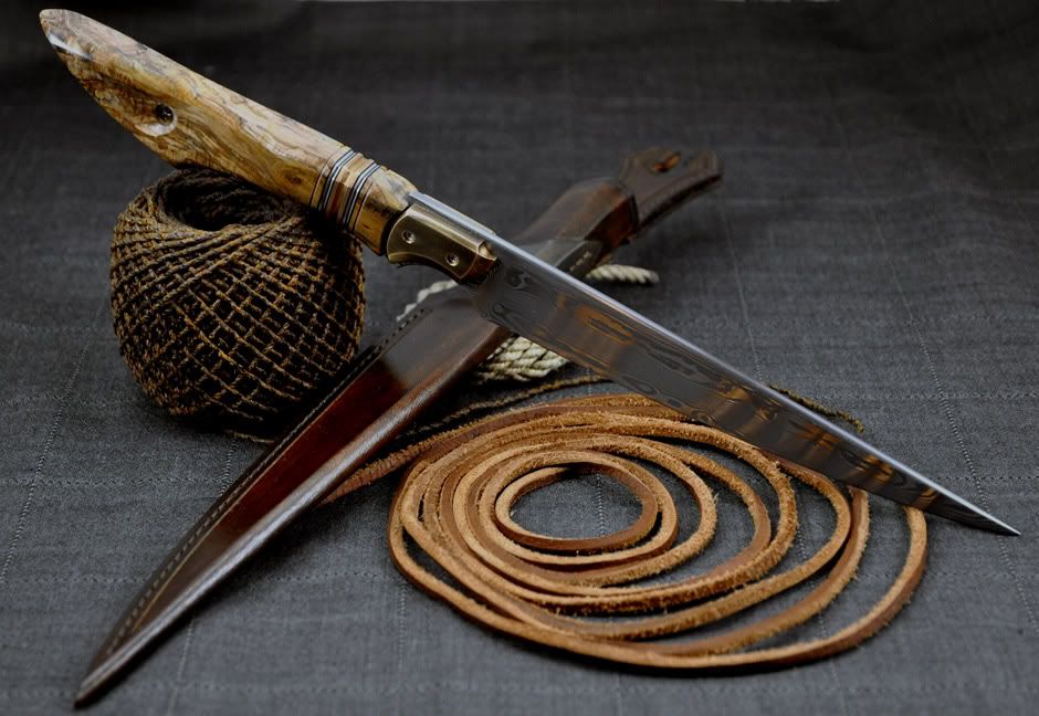

This latest knife is sort of a cross between a hidden tang and a fulltang I guess.
I have been planning on making one for a while now and this is what I came up with:
The blade is Random Damasteel with hollow grind and a rounded spine.
The handle is stabilized cherryburl, pewter and the spacer, bolster and pin are all oxidized bronze. The pin is engraved with my makers mark by Mahikel Eklund.

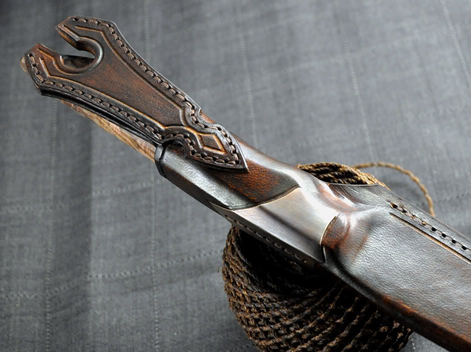

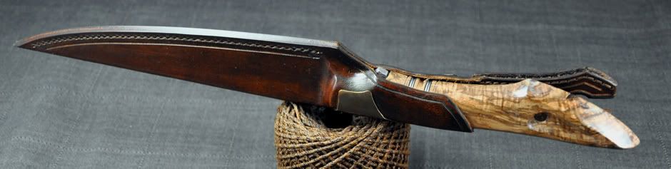

Sheath is wetshaped and has a thin bronze "clamp" that helps keep the sheath thight.
Overall: 310mm (12.2")
Handle: 150mm (5.9")
Blade: 160mm (6.3")
Thanks for looking!

I'm glad you left the bolsters plain, the rubbed edge patina looks really nice:thumbup:

WOW!! A study in design and execution. I keep coming back to the shot of the sheath. The 'bolster' looks to be metal. Is this an illusion or not? Curious.

The thing on the sheath is a sort of "clamp" in oxidized bronze, it helps keep the sheath tight around the knife.
