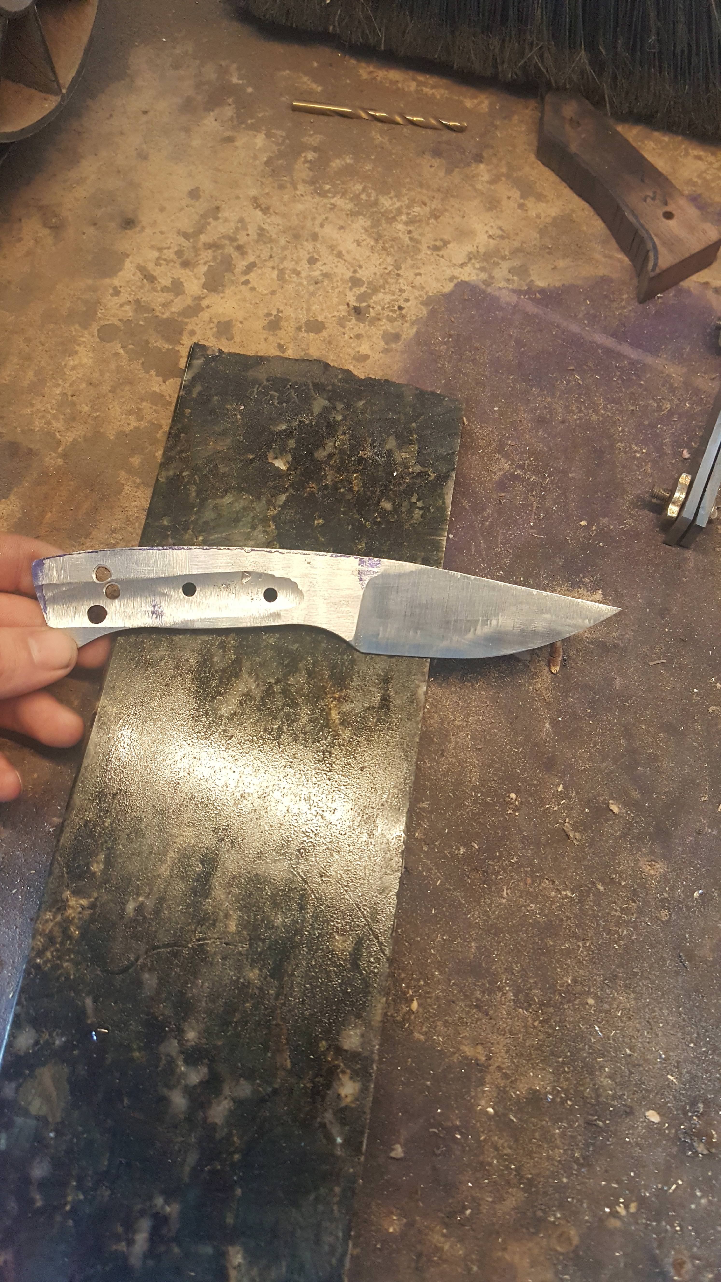

So I'm working on this 7.5in hunter/utility EDC knife and there's just something "off" with the blade shape. It was supposed to be a clip point. What do you guys think?
Fixed it but idk I'm still not happy with it. And I kind a jacked the grind up attempting to grind with a very dull belt. So I'll just toss it and start over this is probably why I haven't completed a knife and I've him through so much metal (Well over 15') it's just never good enough to send to HT
My recommendation for you is to design on paper the exact shape and size you like, then I would actually file the bevels instead of starting out with the grinder.

Cant u just do a full grind on both sides. I thought knife making was about making mistakes and fixing them. Keep going.
Oh for sure I could. But it's just not quite good enough. And for me to have to hand sand up to 400 grit then pay to get it heat treated. It's just not good enough for me

One of the best pieces of advice I got on this forum is to always complete your knives when you're starting out. It's not just about the blade design and how it looks, but learning the process. Just like shooting an arrow isn't enough, you need to follow through.
I would suggest you complete these knives and consider this as a learning experience. That way when you design a knife and love the way it turns out, you have the rest of the process figured out.

I agree the best thing to do is finish making the darn things, and keep making more of them. Most people's first knives aren't very good... Every time I look at mine I realize how totally crap it is, LOL. In fact, my first five are embarrassing, and I wouldn't give those away now. But I learned and am still learning from every knife I finish. And I use my first knife all the time, just did today to make a sandwich right before checking the forum.
Also, some things you can read about and think you know but never truly understand and get good at doing unless you actually do them and practice until you get good.
I hope you have 1080/1084, that way you can backyard HT with two propane torches (aim them at one another and pass your blade inbetween) or forced air charcoal fire, then quench into canola oil. No need to send out to HT. The insight that you gain into the processes of making, as well as in design and geometry, is well worth the time you invest making knives that "aren't good enough".

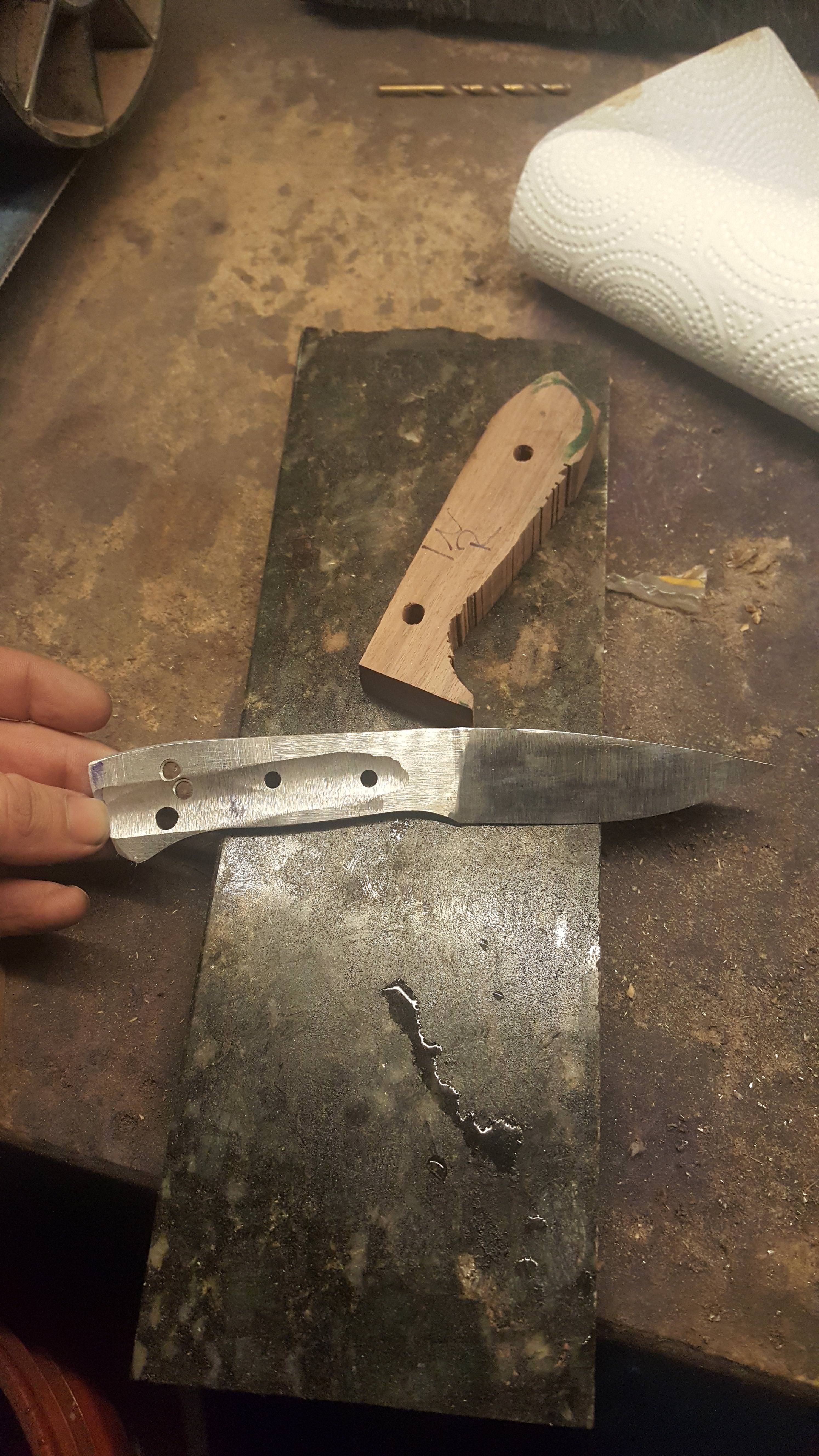

I wasn't worried about the bevels on this knife I could have fixed it with 120g and hand sanding. And I still might. But I went back to the drawing board and studied some of my favorite makers designs (TK Ssteingass in particular) and came up with this.
Hopefully my belts from combat Abbrassives show up tomorrow and I will grind in the bevels and hand sand to prep to send it off to hear treat.

Id say do more on paper before you hit steel just because its much cheaper to scrap a page then steel.
Then make a scrap "template" that you can refine
I like plexiglass cause i have scraps in diff thickness. Then a few drops of super glue and some cheap pallet wood to handle the plexiglass.
If you do this you can pretty much get a design 93 percent "tuned" then pop your fake scales off and you have a nice see through blade template, and a set of mocked up handle scales without ruining anything.

That shape is awesome! Keep us posted if you wouldn't mind.
