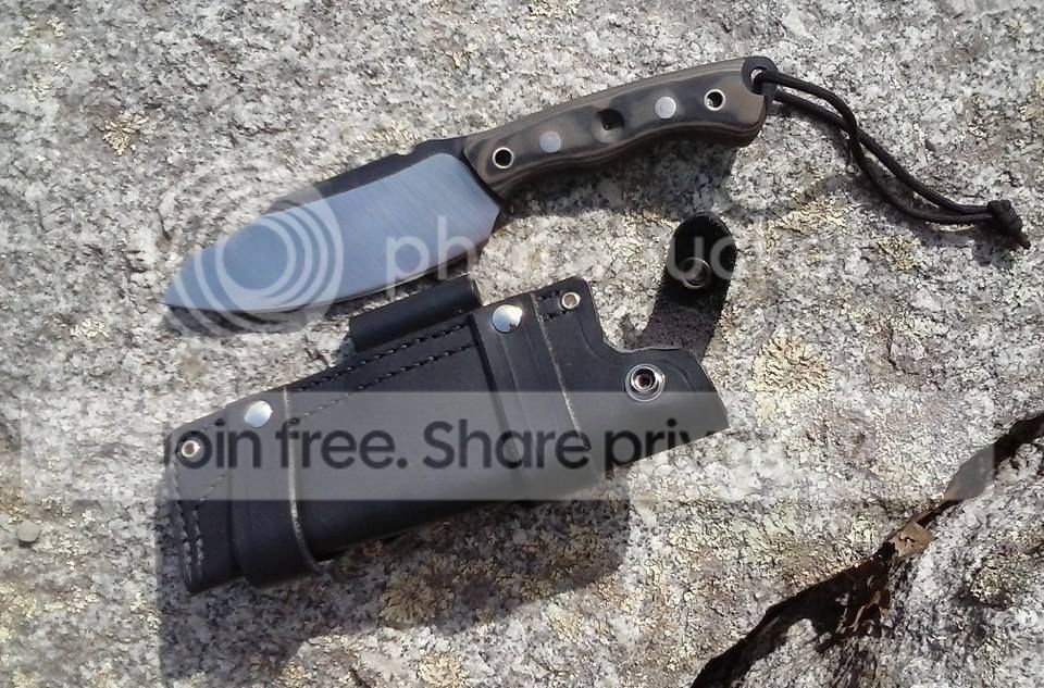

Does anyone know of a knife like the Halibus bush tool in shape with a much higher grind? Maybe without the deep notches right across from each other as well? Thanks
I think I found them. a little bigger than I want and not quite the shape. I used one another fella had when camping. It really was a nice shape, but it needed a higher grind. His has some odd notches in it that really narrow the blade and seem to create a weak spot. He has no issues, but that just seems like a weak spot.
Regrind them and they're not too bad. Still a bit pricy for what they are in stock format, in my opinion.
