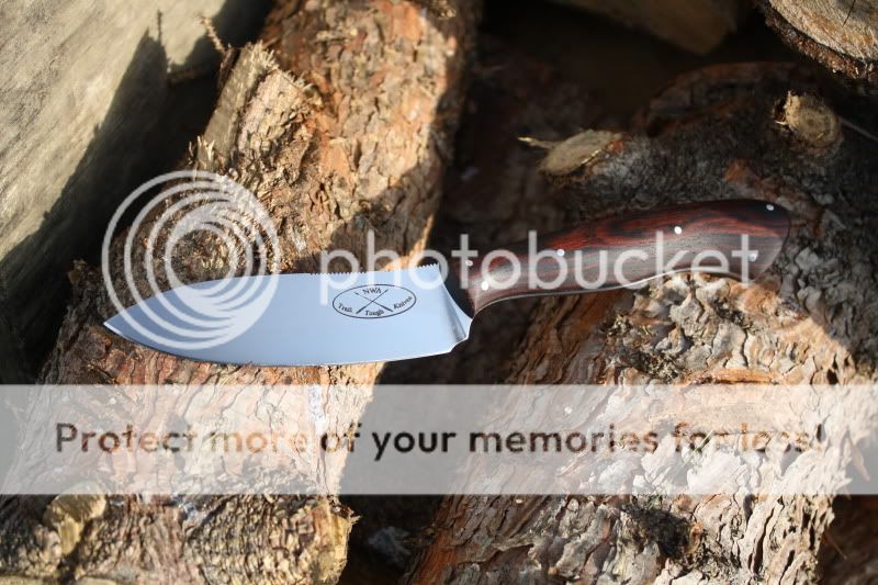

Here is one I have been working on for quite some time. It took me seemingly forever to finish this because of my back. But I got it done yesterday Along with another Cub knife for Paul. Which I will be shipping out next week.
The specs are 1/8" D-2
4" cutting edge
9 1/4" OAL
1 3/16" wide blade at the widest point
Handles are Cocobolo with Stainless pins also in a different layout
I know some do not like the etched name on these, but with this style I have no choice as there is no flat spot to use my stamp.
Thanks for lookin
Nick:)

Have you ever considered making a smaller and simpler etch design? What about using the design in your stamp on the etch? I think, perhaps, what may get to people about the current design is the real estate it takes up on the blade, and the number of words in it. I know that on blades like this, I would prefer an etch designed like your stamp, and located just under the first set of jimping. Just my thoughts.
Thanks Russell, that is a great idea! I will be making a call to have one like that made up. I guess sometimes "more simple" looks better. Thanks dude.

one more question regarding the specs: how thick would be the bevel ground at the cutting edge on such a knife?
can you make it around 0.012"-0.013" thick for better slicing ability?
thanks :)
Shipping would probably be around $30.00 I can grind it that thin if you so desire. My normall edge runs from .018"-.020" before sharpening anyway so making it a little thinner is no big deal.
