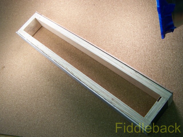

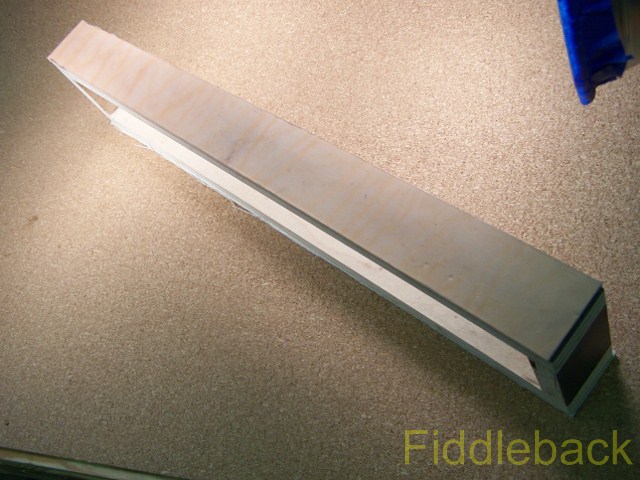

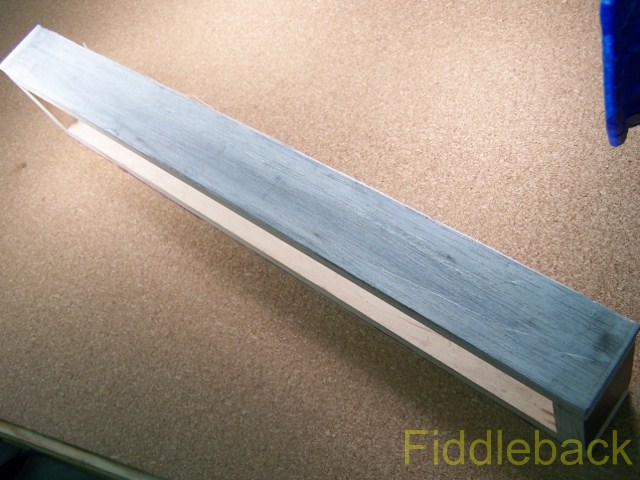

When I came home I built a new sharpening system for myself. Its plywood, ripped 2" wide and joined into a long rectangle. The top and bottom sides are 24" long and the sides are 3". This allows you to clamp it to the table for stability, and to clamp sanding belts to the faces for sharpening. The long length lets you have a very long stroke with the knife against the abrasive, which, I find allows for great control of the angle by hand/eye. I don't use an angle jig in my sharpening. One face is covered in thick leather, for convexing, and the other side has a strip of balsawood glued to it. The compound I bought is roughly 600 grit, but you can really go fine with this stuff! In this picture you can see the fixture, and the layers glued to each face.

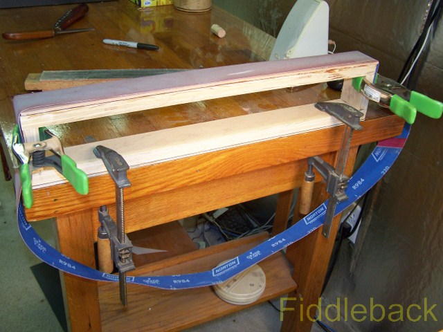

In this pic, you can see the fixture clmaped to my desk, and a 2x72" 240 grit belt clamped tightly to the sides. Ready to start sharpening. Before I start, I've gotten back into the habbit of coloring the edge of a knife with sharpie so that I know I'm removing metal from the right place. This allows the knife to set the proper angle. The angle where you are working metal to the edge. I think a lot of folks get fed up sharpening because they're removing metal behind the edge with their rods set at a specific angle and working metal off in the wrong spot. I had gotten cavalier about this for a while, but have gone back to it, and it never fails. After 240 I go to a 400 grit belt, then switch to the balsa side to finish, then strop. For Scandi's, I've been just using the balsa side and strop. It really excels at Scandi's.
Leather side:
Balsa side with compound.

Great looking setup but I'm a little confused: is your sanding belt over the leather and you're stropping on the balsa w/ compound?
The sanding belt is over the leather. Then I strop just to get the wire edge off of there. Then I hit the balsa for just a few swipes to polish the edge. Then strop again.
So are u using a stropping method throughout when using the belts, or are u pushing into the belts then following with a stropping method?
Its a stropping actiion. Pull the knife toward you with light pressure on the belt. Check to see that your angle is getting to the edge. Once you have an edge, hit the shoulder with a pass or two.
