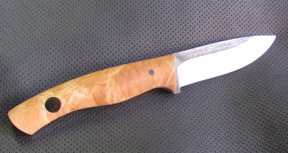

Many moons ago, I picked up one of Nick's blade blanks off another forum. I am usually busy doing other people's projects, so "my" project took years to finish;)
I do mostly high tech carbon or lightning Strike handles for folders.
But my heart is totally into carbon steel and wood.
I had a piece of burl maple and thought it would look great on Nick's fine ground piece of carbon steel!
Here are a few pics:

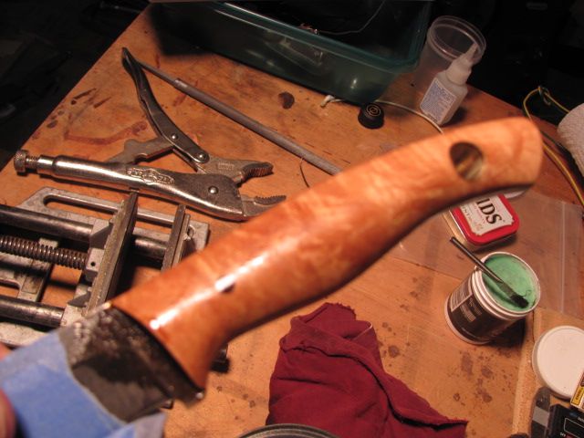

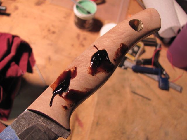

If you're wondering about the finish, I'm totally old skool with that. I'm of Scandinavian heritage. Something that's been used for 1000 years in Sweden and Norway is pine tar. There are old Churches over in the old country that have wood shingles impregnated with pine tar that still work today!
Pretty easy to apply, just a glob on the handle and use a heat gun to make it flow onto the wood
Why pine tar? Because when you sweat or work with a knife in the rain or snow, the grip gets BETTER, it does not slip! Plus, you are less likely to develop blisters if you do a lot of cutting. I've sanded down all my Gransfor Bruks hatchets and axes and have applied pine tar. Believe me, stuff is AMAZING!
How did I do Andy?
That thing is beautiful, and looks like a Ladyfinger. Who's Nick? Did you mean Andy?

A question about the pine tar. If I applied this to a knife handle and was carving with it later and then opened my hand palm down would the knife fall out easily or sort of stick to my hand at first? I understand grip...but have personal issues with "sticky" things lol. And yes, that does make being a father with young children interesting...
You'd really have to glob it on in large gooey lumps for it to stick to you hand. Any of you guys pro baseball fans? That blackish looking stuff on their bats is pine tar. to answer your question, the knife would fall out of your hands if you wanted to drop the knife, or ax or baseball bat, for that matter.
