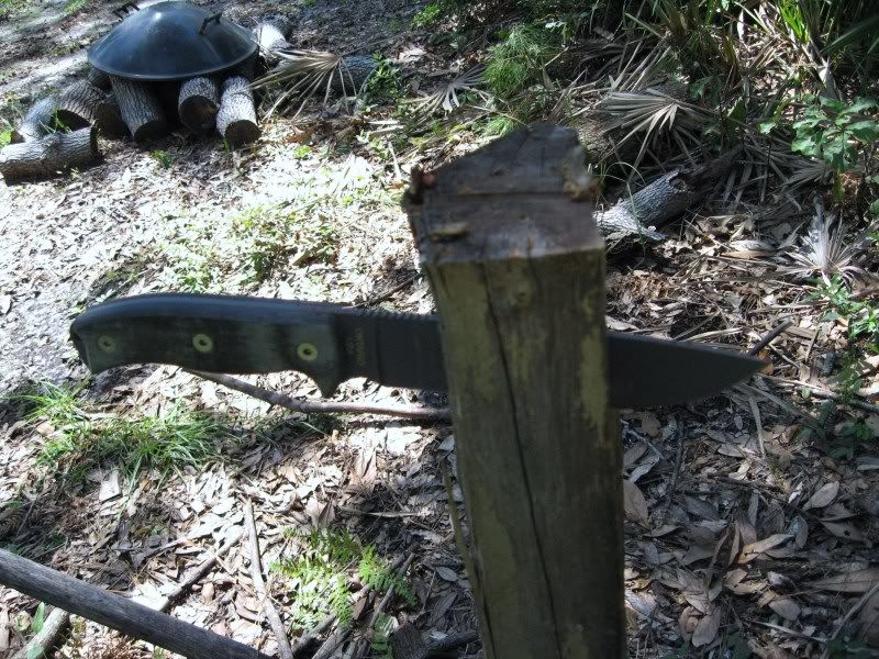

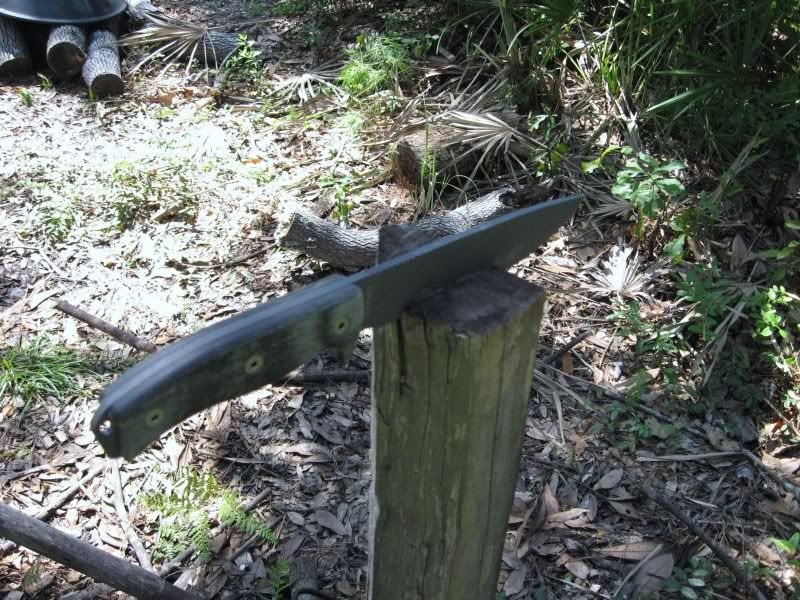

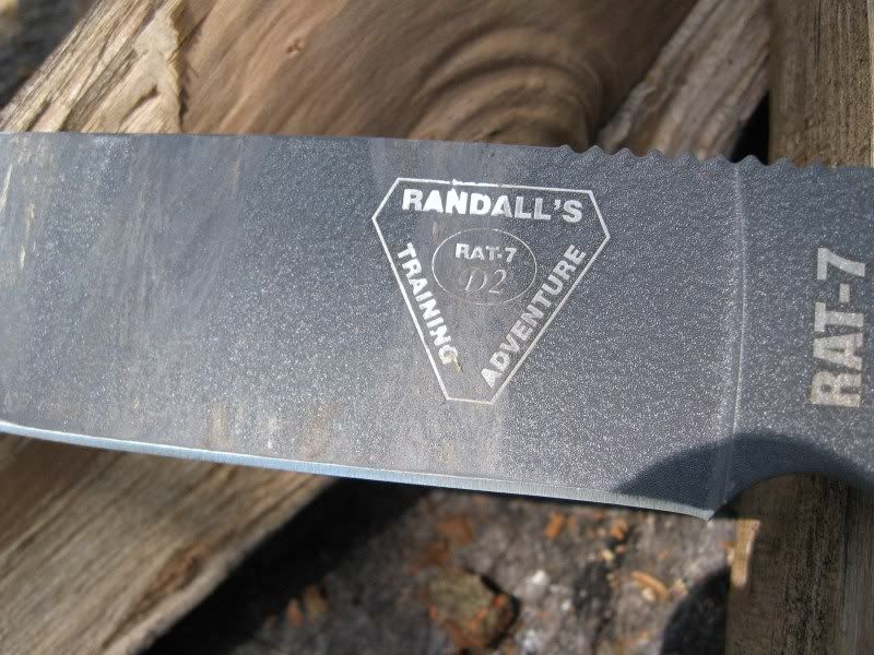

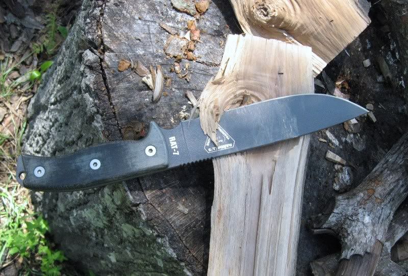

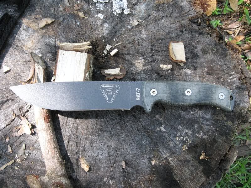

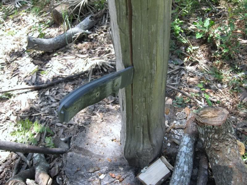

This thread actually kept me awake last night. The sight of that RAT-7 snapping like a dry twig bothered me. Back when Jeff and Mike were affiliated with Ontario I bought a RAT-7. I used the heck out of that knife, and it proved to be plenty tough. So I got the "nicer" one in D2. It would be a backup or a nice gift for some fellow outdoorsman. About the time I decided to get a RAT-5, the big stink with Ontario and the new RAT Cutlery erupted. So I held off getting that knife, waiting on the RC-5 which I just ordered. But I am not getting a RC-6 because the RAT-7 is close enough. I know, the Rowen made RATs are better, but why get rid of a proven performer? But what if my D2 RAT-7 is a pos? I have used knives in D2 before with no problems. One is a chopper. So today, I took that pristine RAT-7 in D2 and beat the heck out of it. This is tough, hard, dry, aged maple. Just because Ontario screwed up the heat treat on a batch or two, that doesn't mean you guys with old D2 RATS need to throw them away. But I would suggest testing them out at home before you pack one into the boonies.

I have seen 1095 do the exact same thing. My friend's 1095 machete snapped in two abut 6" from the handle just hitting a pine sapling. My identical machete does just fine. If the heat treat is good, the D2 is pretty tough, as I clearly have shown. That maple I split was so hard I had to use a 4" thick log as a baton to hammer that D2 blade all the way through. As has been noted, Ontario has had some bad batches. From what I hear so far, Rowen seems to have better quality control on their heat treating.
