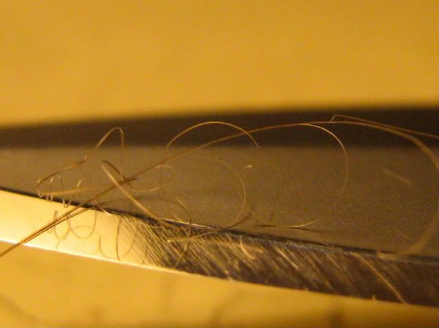

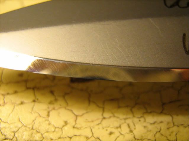

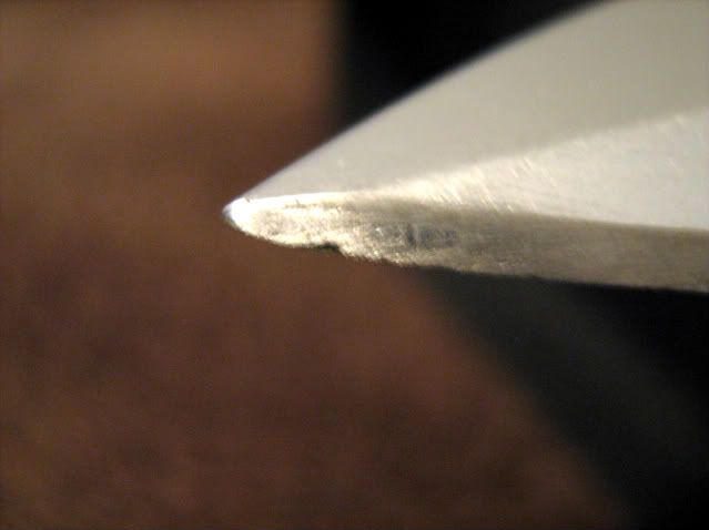

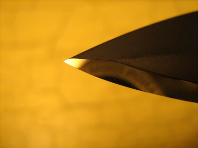

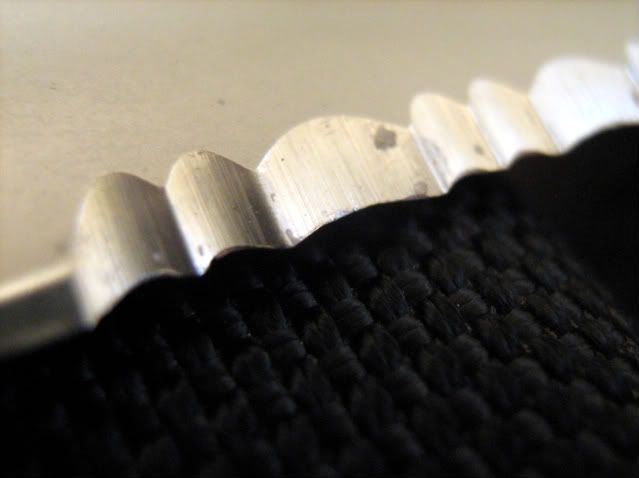

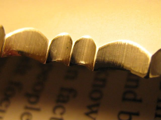

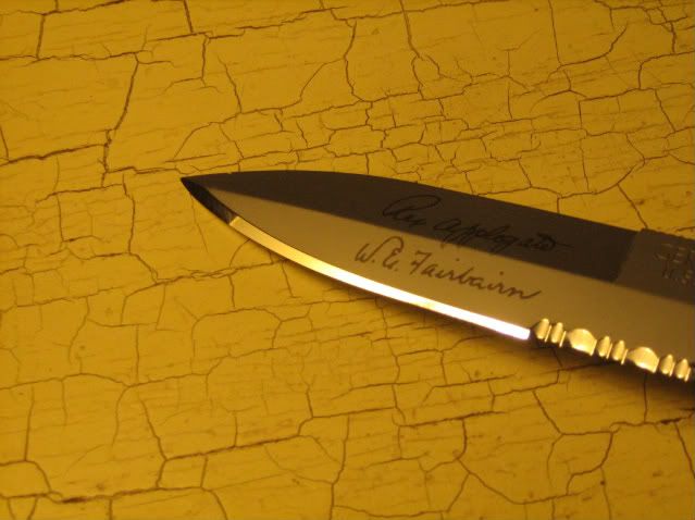

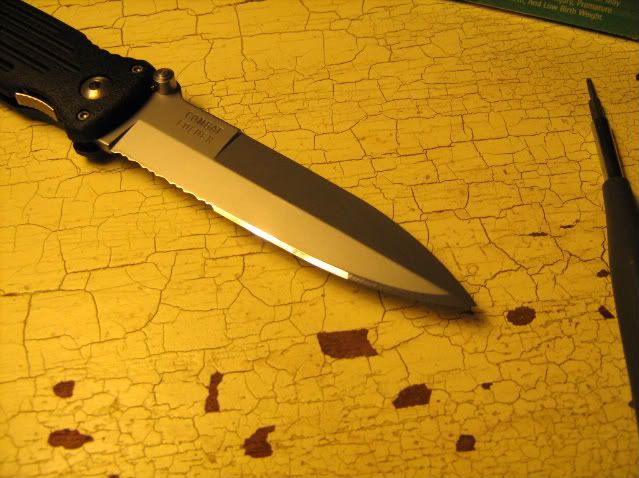

There was a little damage to the tip and the main edge felt like a butter knife. The serrations were in good shape and after a good polishing were slicing paper and shaving some hair nicely. I lowered the bevel angle a few degree's and suprisingly it took a while to grind it down, I used my DMT stones with the aligner tool and 1 micron diamond paste. I think I might polish it some more but it has a nice "tooth" to the edge so I might leave it.
Before:
After:
Sorry not paste but spray, I got a sample bottle of 1 micron handamerica diamond spray. I use it on my leather and MDF strop's just like other compounds but its sooooo much easier, two sprays and start stropping, plus it cuts really fast.
That is the nicest/most polished bevel I have ever seen. You did an awesome job.
Thanks for all the comments I really appreciate it. I have a feeling he will be happy with it but hope he will never need to use it again. I decided to keep polishing it so I will get some pic's up later of how it looks now.

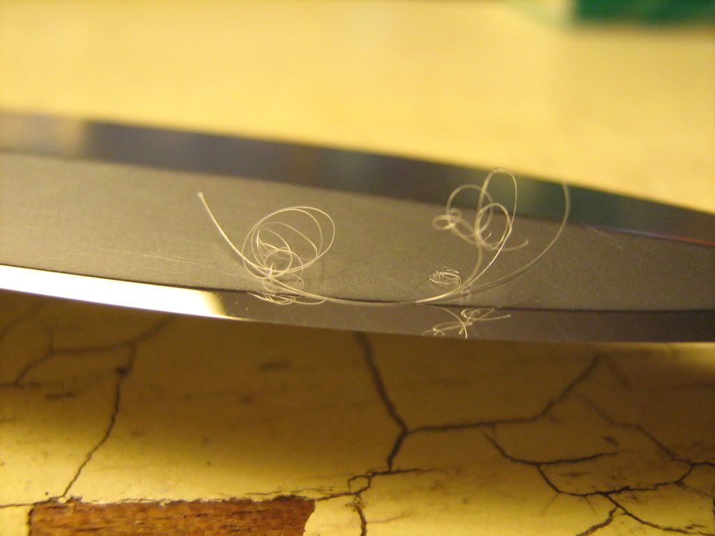

I continued to polish the edge at 1 micron, the edge got sharper but the surface polish did not improve much. I finished with some 0.5 micron diamond spray with only a few passes and called it quits, its sharp enough.
After the 1 micron
The diamond stones work very good but leave scratches that are almost too deep to polish out. This next pic looks bad but its just the lighting, in person it looks more like pic #6.
0.5 micron for that extra curl :D
