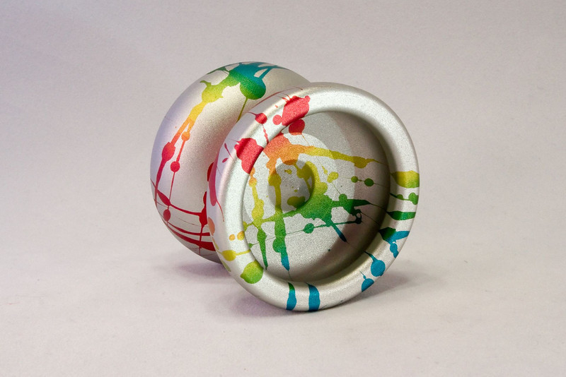

I did a google search and found a photo of a Sebenza with the 'splash' anodizing that I mentioned in your other thread...

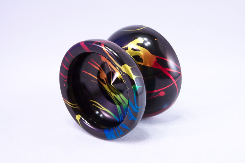

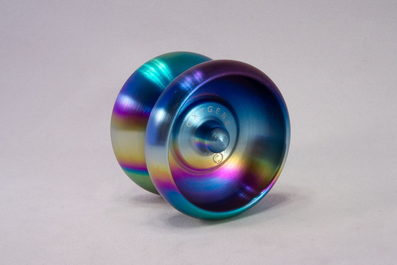

If you do a google search for anodized YoYo and anodized Titanium YoYo, you will find some incredible anodizing jobs involving multiple vibrant colors.
Here are some examples anyways.. the first two were done on aluminum and the next three were done on titanium...

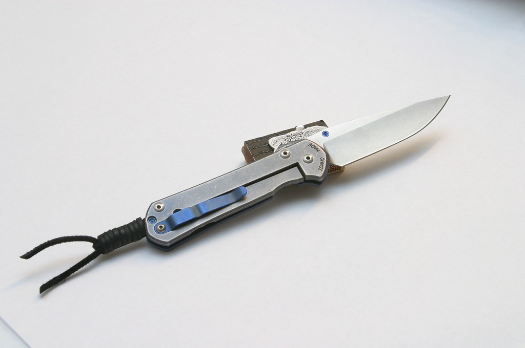

And here is a Sebenza that was anodized and sharpened by Tom Krein (It looks very similar to the technique used on the titanium yoyos pictured above)...

I've seen it done on aluminum YoYos but not on titanium.
From what I have seen, it looks as though it is very hard to do and it seems that it can get very messy/hard to keep within the lines. That would be incredible though!
