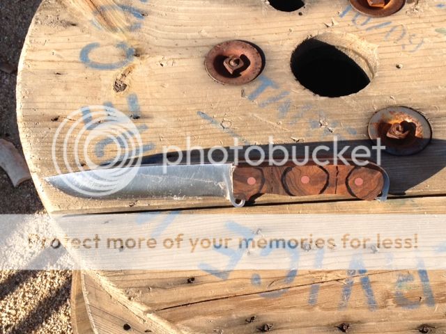

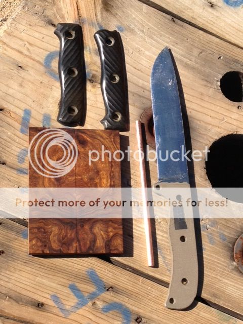

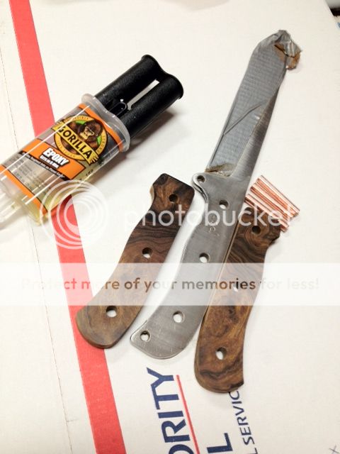

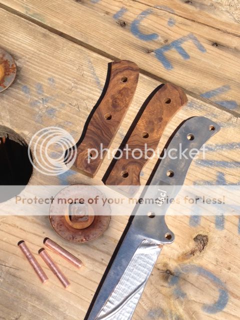

Hi everyone, I wanted to make my Boss Jack into an Arizona edition. So i purchased some Arizona desert ironwood burl scales.

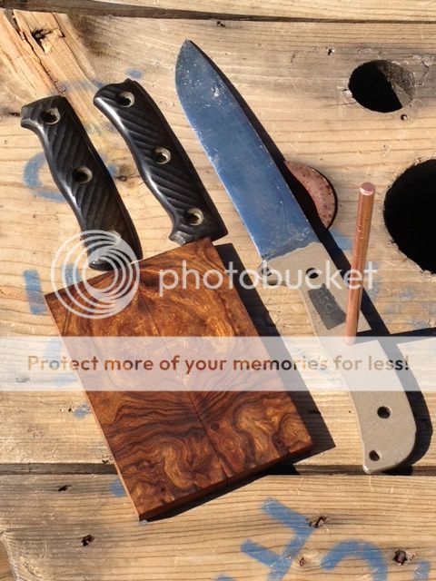

They started as 3/8" x 2" x 5" matchbooked. Since Arizona is the copper state, I also wanted to incorporate some copper with my ironwood and INFI:cool::thumbup:. So I purchased some 1/4" copper pins.

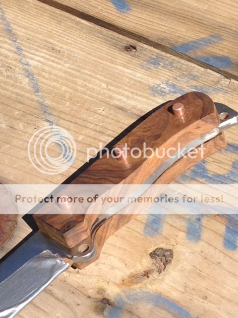

Here it is with the scales off ready to strip.
This is my EDC, so I wanted something robust without being too flashy.

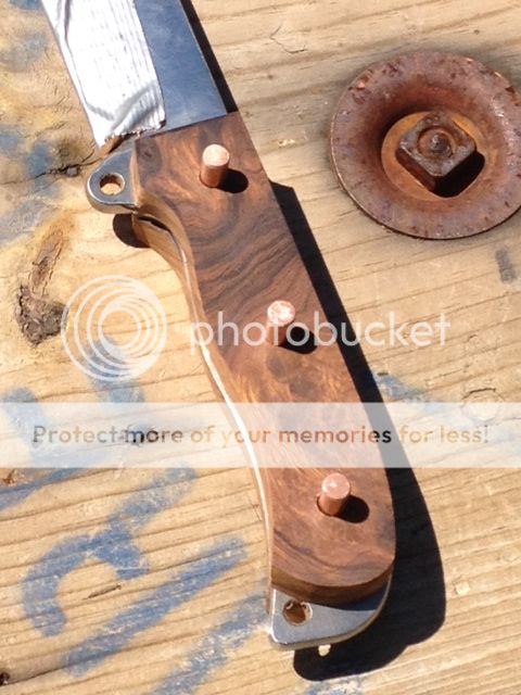

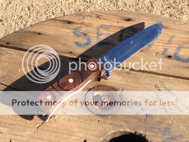

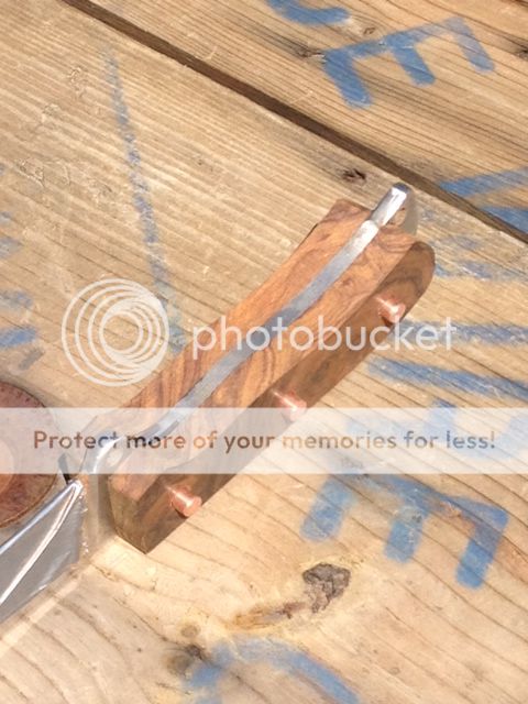

Here it is with the scales getting fitted.

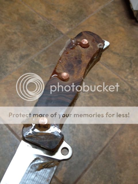

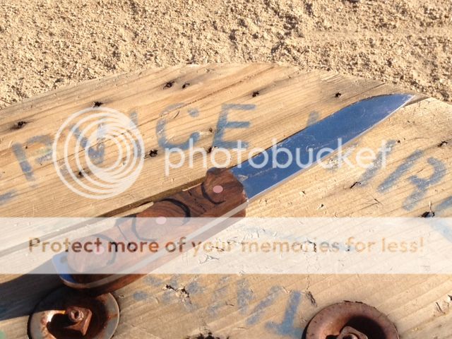

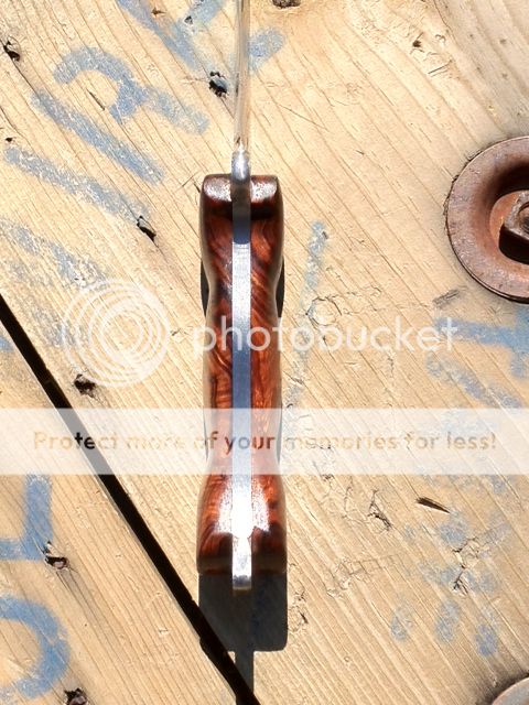

Here it is ready too glue. I rough sanded the tang, pins, and the inside of the scales. And I used 3300 pound outdoor gorilla epoxy.

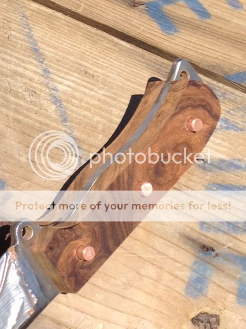

Here it is after clamping all night, with the pins scales epoxied on.

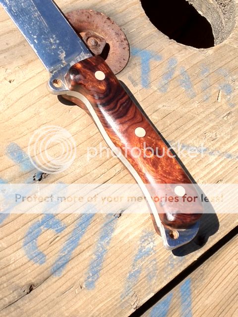

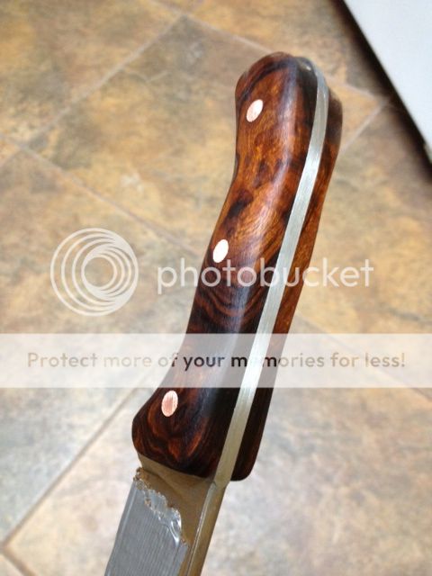

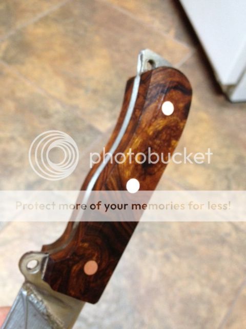

and a little sanding.

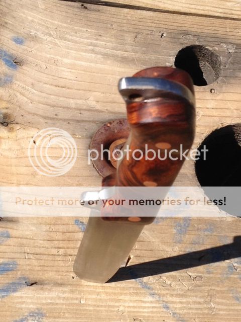

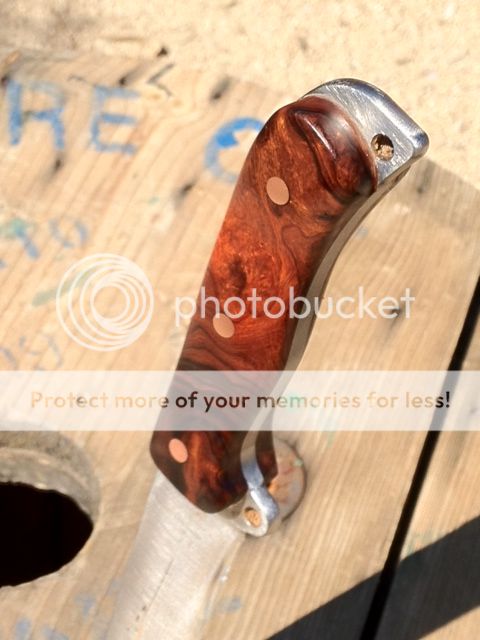

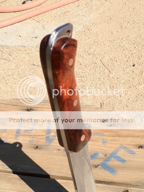

Here it is marked and ready for sanding

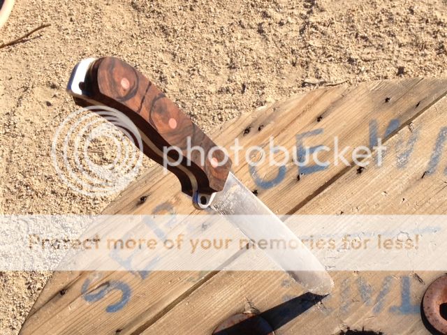

Here it is at 400 grit sanded and shaped. Fills my hand like a dream come true. Still need to go to 2000 grit :)
Have a great day !! I gotta get to work :)

Thank You, I guess Ironwood doesn't need to be sealed. It can be sanded then buffed to a high polish. I'm looking for higher than 400 grit sand paper right now, and then I am going to look into that some more :)
