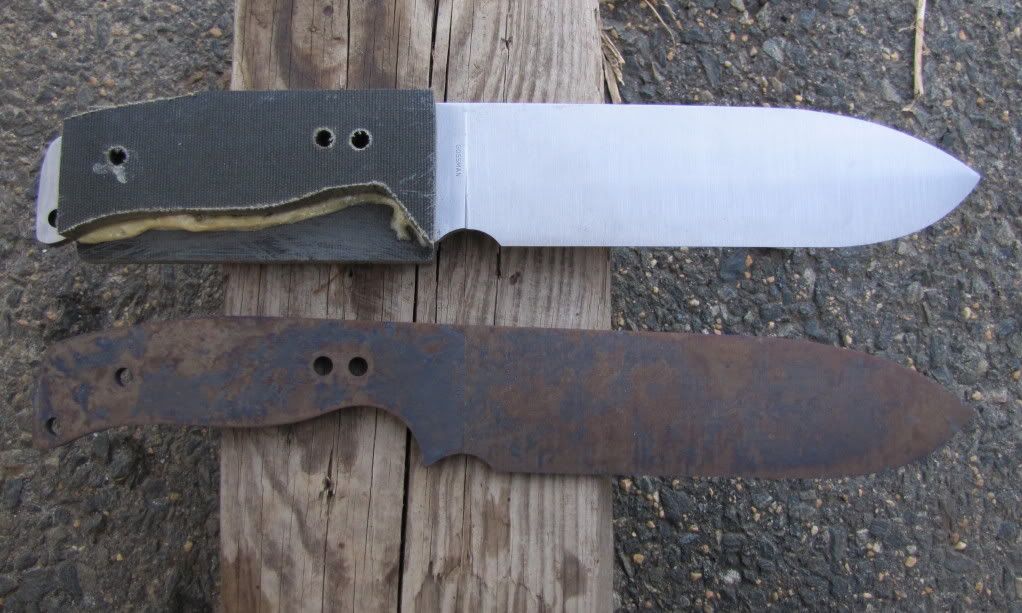

Here's the start of the two Tuskers. First are the profiled blades.
Next, the blades rough grinds, drilled ready for HT.
The Tusker is done totally freehand, no template to follow.
Scott
They look great Scott -- thank you for the update!
I am continually amazed at what your hands can do!
-Stan

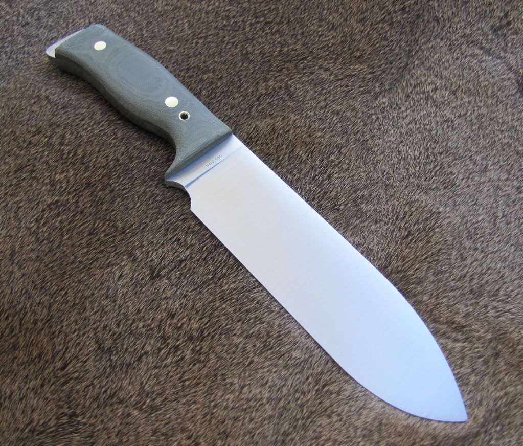

Here is one out of heat treat and temper the other with scales attached ready to finish.
Here is the above knife finshed. Just need to clean up grinds and sharpen.
Scott
Wow!
That's about all I can say Scott!
The one that is finished -- is that the green or brown handle? My color vision isn't the best so you will have to forgive me.
The exposed tang came out GREAT!
-Stan
That's the green canvas. The brown one has the scales attached as of today. I should be getting to that one by hopefully Tues. I use 5/16" head corby bolts and thick walled tubing. I Gorilla glue the bolts together when I put them in.

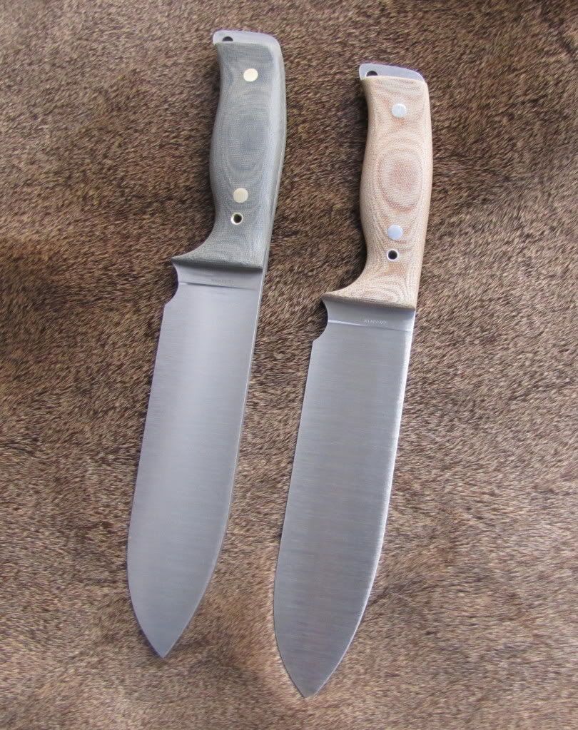

Here they are. Just need to do grind clean up and final sharpening.
Scott
Those look great Scott! I think the green one will be the user! Where abouts is the balance point?

Normally with a knife this size, the balance point falls right in front of the plunge lines. Right where the cutting edge starts in front of the choil. I will double check on the exact area.
Scott
I checked the balance point on both and it's about perfect for this size knife. The balance is right in front of the handle scales at the ricasso and plunge line. The extended tang brought the balance back a bit.
Scott
