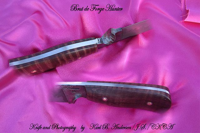

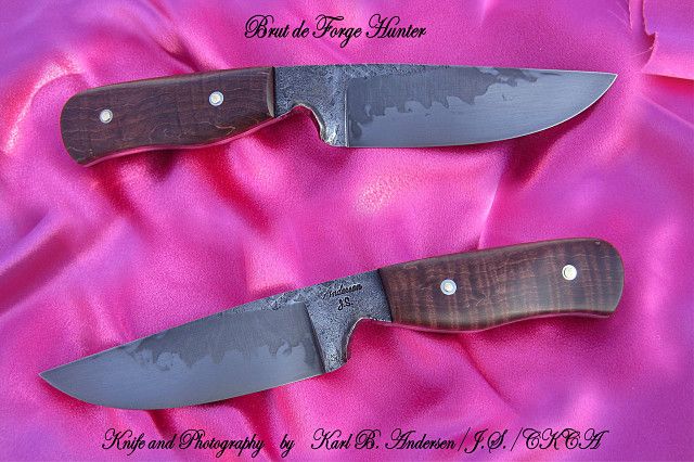

Shannon, are you looking for something like this? :)
or this?
