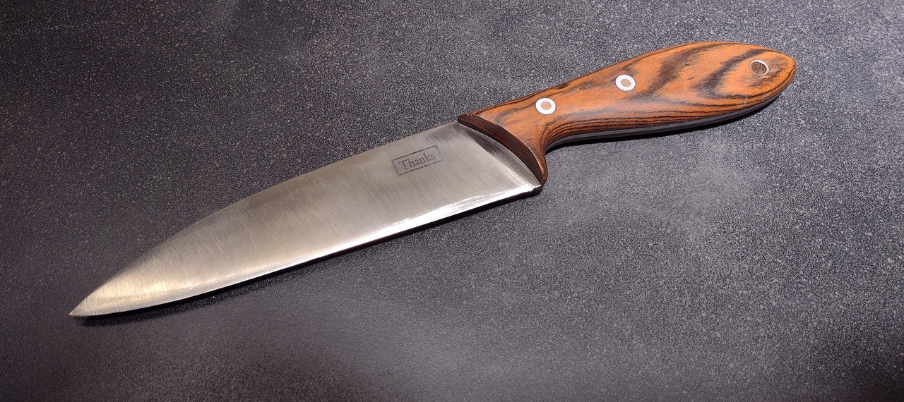

Most of the phb knives I made are in the kitchen. Made a chef knife for a culinary trained chef and it is his favorite knife and he has used it for 4 years.

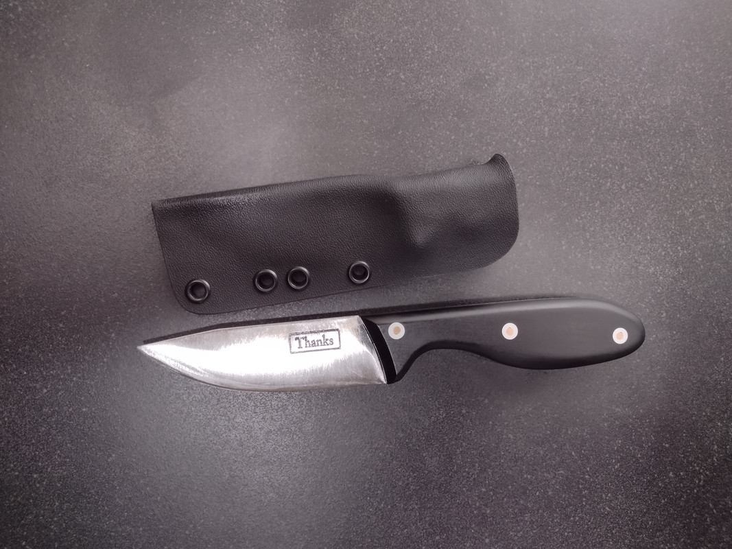

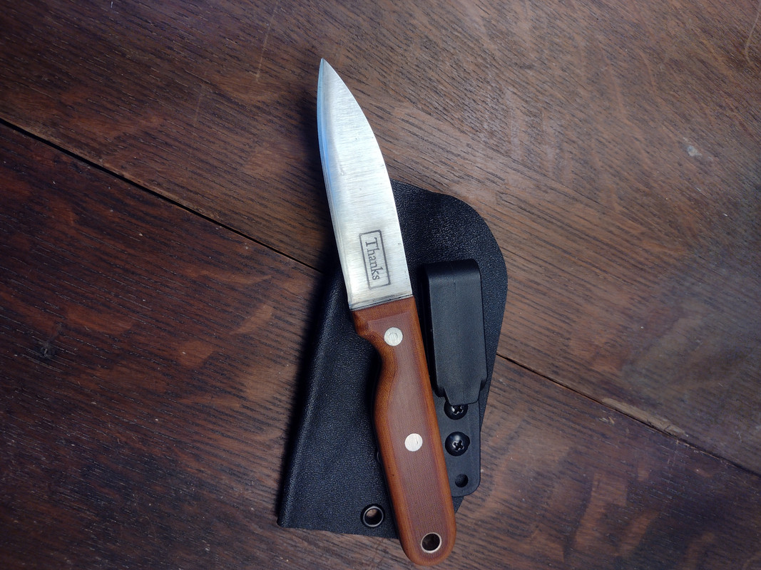

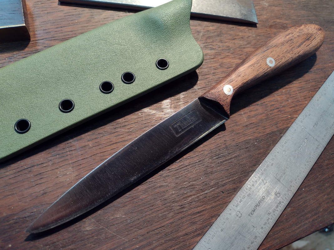

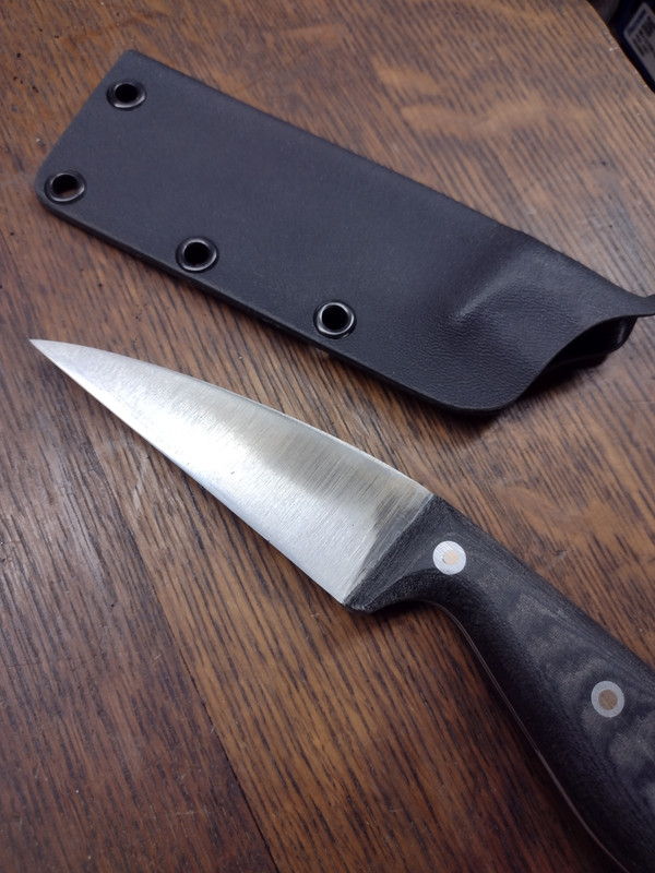

Just recently a hunter/trapper requested a small detail knife for cutting around skulls and into bone. Even though I use "higher end" steels such as CPM Cruwear, he insisted I make it with the same steel as his first knife that I made for him, he loved it so much.... Even though it wasn't designed for it, he used it to clean the bear his wife shot. He said he was carving away for over 5 hours and it still stayed sharp. Wow.
Here is that knife, and a few others made from Starrett power hacksaw blades.

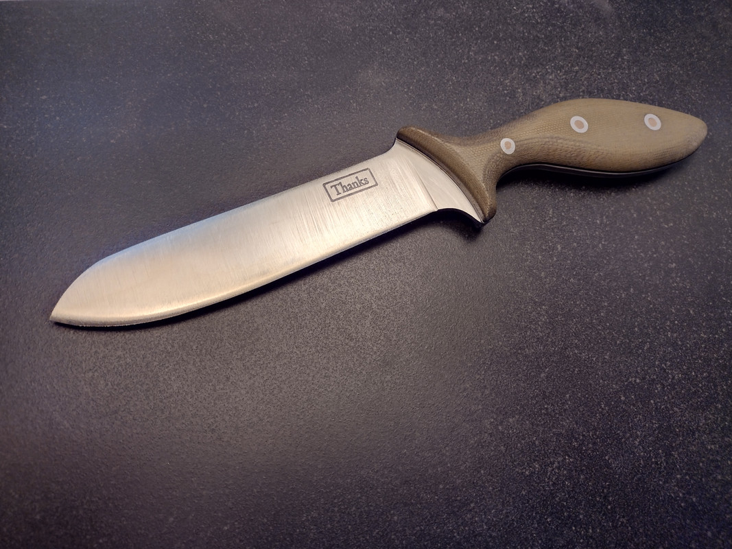

This one above cleaned the bear meat. (second pic with the black handle)

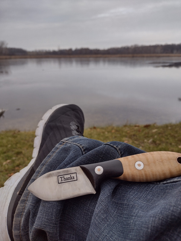

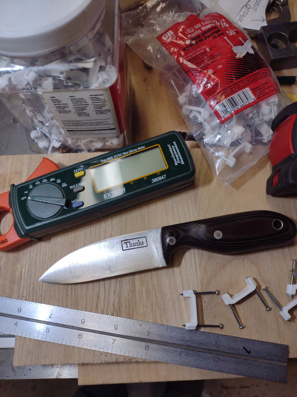

This last one is my current edc, it's like a glorified steak knife.
The issue most makers don't use PHB material is that it is crazy hard steel, difficult to drill, and that it doesn't finish up well, leaving the knife kinda Ugly. And that it takes 2-3 times as long to make. Me personally, I find them wonderful, and will continue to make from that material along with the other steels I use.

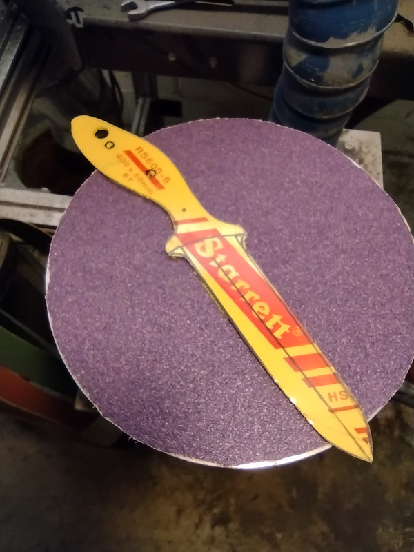

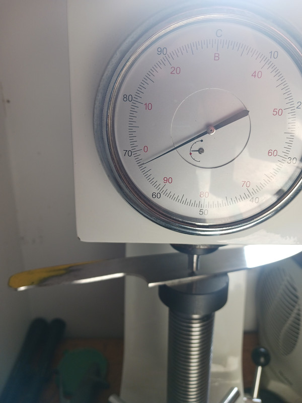

Since this conversation about phbs got me fired up I found my last piece of saw blade and started a knife. Surface ground and tested hardness across the 7 inch blade.
11 tests.
2- 65.5 Rc
3- 66 Rc
5- 66.5 Rc
1- 67 Rc
I did use test block to make sure readings were good.

Thank you for doing that! I asked because the comment about a hard-to-regain edge made me wonder if the blades were HTd evenly or whether it might be some idiosyncratic induction or other electrical thing that wouldn't heat it evenly. Differential heating, if you will, or, for that matter, tempering.
