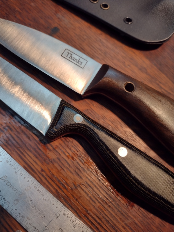

Yes, like S Seedy Lot said I like using Startett blades. I've worked with a good variety of steels, and have vastly different opinion towards them.
I think the heat treatment Startett does to the HSS is unequalled. They do a great job.
I always recommend them for new makers, or any maker, really. I feel they make a great knife.

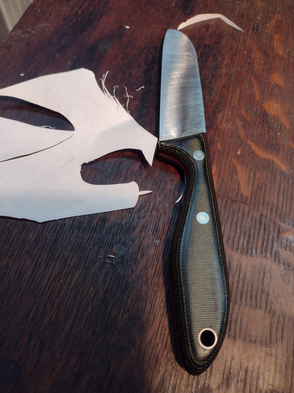

Just recently a hunter/trapper requested a small detail knife for cutting around skulls and into bone. Even though I use "higher end" steels such as CPM Cruwear, he insisted I make it with the same steel as his first knife that I made for him, he loved it so much.... Even though it wasn't designed for it, he used it to clean the bear his wife shot. He said he was carving away for over 5 hours and it still stayed sharp. Wow.

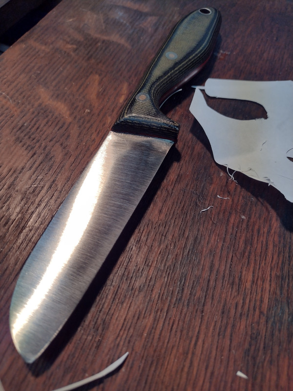

Here is that knife, and a few others made from Starrett power hacksaw blades.
This one above cleaned the bear meat. (second pic with the black handle)

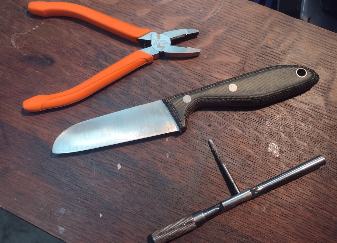

This last one is my current edc, it's like a glorified steak knife.
The issue most makers don't use PHB material is that it is crazy hard steel, difficult to drill, and that it doesn't finish up well, leaving the knife kinda Ugly. And that it takes 2-3 times as long to make. Me personally, I find them wonderful, and will continue to make from that material along with the other steels I use.

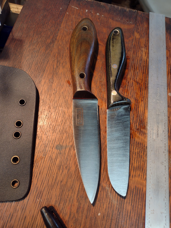

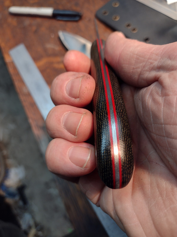

Thanks for the comments ... I feel I specialize in comfortable handles. Handles are my thing. It's what I think about most, and the reason I actually started making knives. Because I don't like what was out in the market. My handles are Better. It's what we first touch.
My first picture with the bocote handle, and the wonky dagger shaped one with the OD green handle were Both made from .125" thick blade.
