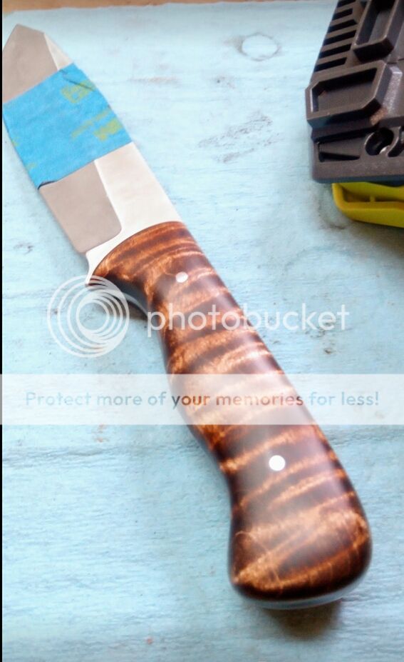

Warren, have you tried the Fiebings British tan on some of that maple? It took me five years to remember that stuff. I could never get that color right with the light brown, yellow, etc.
I agree with others’ posts. Padauk is one of my favourites. Cocobolo is nice but a sensitized. Bocote and tulipwood are nice. I’ve even found some nice curly maple locally. It really pops with an amber dye.
I need to get some. I like the amber analine dye from Lee valley.

I love those maple handles with the dark highlights. I have some really nice soft maple that I would definitely have to stabilize. I brought sime of my nicer wood out from the west coast when i moved.Can you stain stabilised maple?
