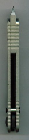

Ok this one has been challenging because of some specific requests regarding the rear spacer which is also a glass breaker/flat head screwdriver combo.
What I'm hoping to gain here is some input from the owner of this folder so we can discuss more on this spacer since I really have not done one like this before and am kind of moving forward in the dark a bit so to speak. So far so good but I recognize its not refined yet. Thats where you come in my friend. The flat head works and the grind is done but how were you wanting this shaped when you had it in mind? Any input, even if you print off one of these scans here and draw on it to scan or photo copy after showing what you hope for in final size and shape will help. I can get it via email if you don't have a way of loading the pic here.
Oh, and by the way. As seen here this little guy weighs in at 3.1 ounces and thats not refined or trimmed down yet with bevels or final shape for the barrel in the pivot, the stop or the spacer or a lock cut to spring the lock so hopefully the pocket clip added and the final trimming and cutting will cancel each other out or won't do much to that to change it and it will hover around that 3 ounce or just over weight when done. If you are wondering I used .110 thickness slabs on this in an effort to both keep it slim and reduce the weight for you because I know that was a concern. Looking at what we see here I don't expect weight to be a problem at all.
