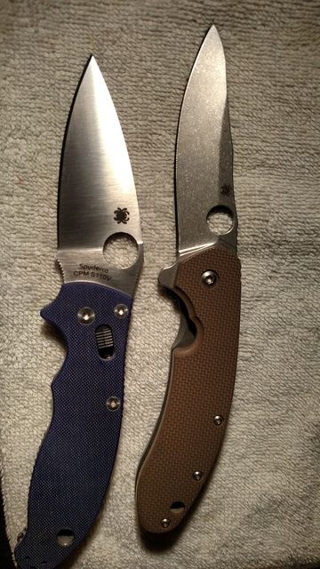

Have a southard. Love it. I saw the same video on over tightening the pivot screw, but honestly is only an issue if you disassemble it and then over tighten putting it back together. Knife has a really good detent though, so I doubt you'd have an issue with the pivot tightness. Overall fit and finish is excellent. I just love the blade shape and functionality. I'm about to swap in some carbon fiber scales to replace the brown, but if you like the all blacked out look then not something you'd do. Honestly, the only real issue I have with the knife is the pocket clip which is too pointy and just seems wrong in my hand. I have a new clip arriving tomorrow. :)
All that said, I'm also drooling over the blurple manix. I love my standard g10 manix and the steel upgrade would be awesome. Plus the blurple is kinda mesmerizing for some reason.

The s110v manix and the southard are great knives .... To me they have a different feel
Southard feels a bit more upscale and the manix feels like a knife ready to work ... If that makes sense
And here is the tricky part, the manix 2 actually fits my hand so much better than a pm2
So if you send up with either and don't like it, I bet the other will fit better
