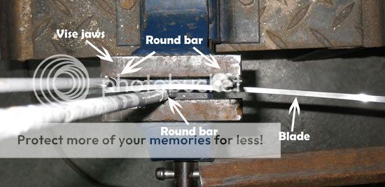

Mathinus I'm impressed with the elasticity of this steel at high hardness. I replaced my EDC blade with a piece of this steel a while ago because the original blade was badly worn through 4 years of constant sharpening. My EDC really gets abused since I don't feel sorry for it and the blade is holding up very well and keeps an edge through wood scraping work, opening tins, cutting cloth to name but a few abuses. I'll do a thread soon on the Kershaw Vapor with 'revised blade'. No better way to test steel as to put it on an EDC you don't feel sorry for.
Here's a pic of the bend test of the 14C28N, clamped between round bar in the vise, the vise is then cranked with a pipe extension wearing leather apron, gloves and eye protection in case the blade fails. These broad chef's knife blades showed no sign of deformation after testing when checked again on the marble slab, they returned to straight after my test. My point is that the blade should give enough without snapping for the user to feel he's bending it before it breaks. Bad hardening and tempering will see the 'accidental' snapping of a work blade before the user was even aware he was abusing it. My tests are worst case scenario.
And some testing done to its predecessor 13C26 or AEB-L in a larger knife.
