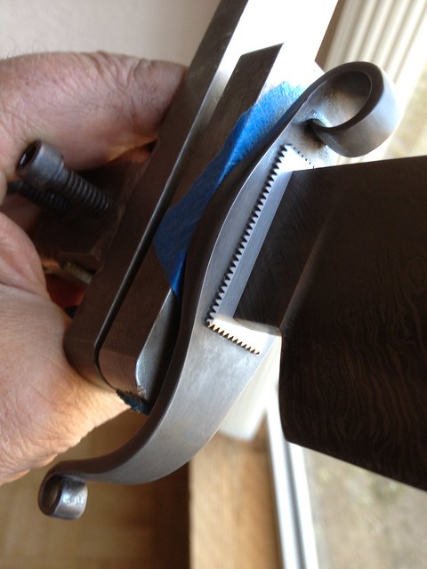

I used a Damascus bladed knife last year that had a forged guard and butt cap forming a "D" shaped guard. The ends of the pieces had closed curls so I tied my lanyard to the front one.
I am thinking of another guard that has a piercing in it's design that would also serve in a similar way. The object of these "rules" is to get the makers/users of these knives to design a knife around traditional materials, specific to the competition, maintaining the traditional feel and look of a Bowie as most would recognize. This would also require the user to use techniques unique to his knife depending on the design.
