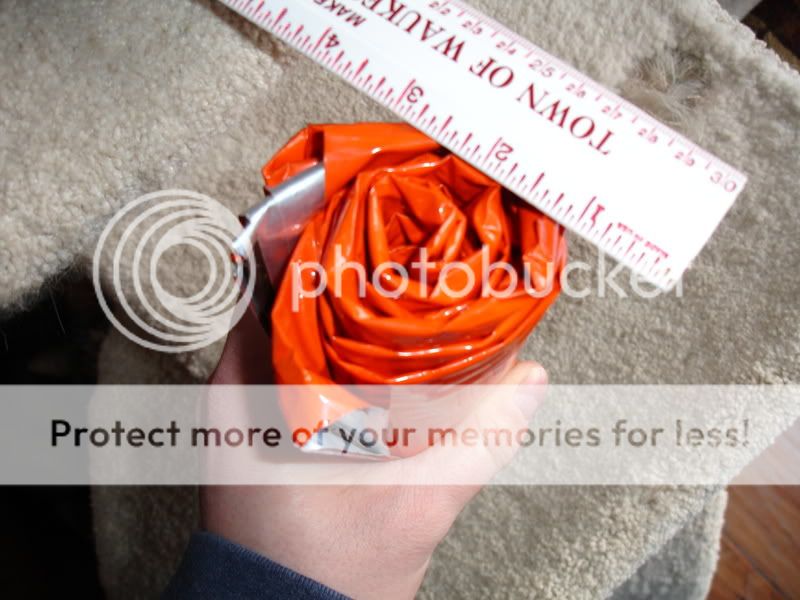

When you guys talk about the higher quality more expensive versions, what brand are you talking about? I am looking to get one and don't know exactly which one to buy. I want one that is not going to take up too much more room than the cheap version and is going to be more durable. How about the AMK "heatsheet", does anyone have any experience with one of these? How big is it folded up compared to the cheaper ones? Thanks for your time.
The AMK Heatsheet packs into a small package. Folded up dimensions are approxiametely 6.5"L x 4" wide and 1" inch thick. Overall weight is 3.5 oz. They claim that it is big enough to be used by two people.
Probably talking about something like this. I have a few, they work and seem to hold up well. Made by Thermos. Here is a description:
Heavy duty, compact plastic lined foil 84'' x 60'' blanket will reflect and help retain over 80% of radiated body heat, providing warmth and protection, even in sub zero temperatures. Similar to the Army's Casualty Blanket, this is excellent for emergency use, camping, hunting and viewing sporting events. One in the car for winter travel could save a life! Waterproof, light-weight, and durable.
