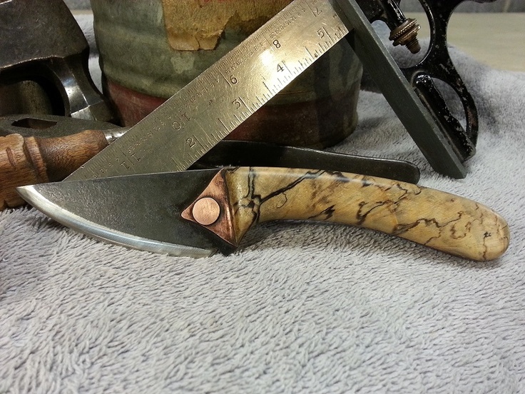

This is maple:
I would resaw into thicknesses no thicker than absolutely necessary than what you need for your projects. Then you can cover the ends of each piece with whatever material you use to prevent cracking, put the pieces in your oven for a couple of days @ 130 degrees. Check it often for cracking. Ideal stabilization moisture content is 5% or below. Depending on the length and thickness you need, cut one of your pieces in half after 24 hours in oven. Check moisture levels. Thicker pieces obviously take longer than a couple of days, but if you are doing knife scales, blocks 5"x1.5''x1.5" dry for me in approx 39 hours. Denser woods, such as maple and walnut, dry slower and are more prone to cracking. I have found that wrapping them tight in aluminum foil helps with the cracking.

I love that knife btw. have looked at it several times lol.
