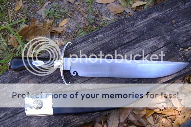

This is my version of the Spanish notch. Drill a starter hole and file.

I tried it with the 1/8" center cut end mill chucked up in the press, and
it worked great. Thanks for tip, Michael. LRB, that is a truly beautiful job
on the big Bowie.
