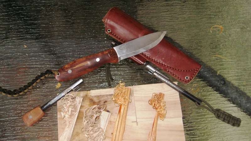

I just made a quick video showing fatwood taking a spark compared to regular dry wood taking a spark. I hope you enjoy.
[youtube]6OTrqA0vfss[/youtube]
Good video Tony, I definitely need to get a couple of the larger ferro rods like those, I really like those. Did both of those come from going gear?
Thanks buddy. The mich metal one is from Going gear. DJJ made the handle for me. He likes throwing things like that in when you order a sheath from him:thumbup:
The other I got from Marty Simon of The Wilderness Learning Center.
He sells them I believe http://weteachu.com/merchandise1.htm
They are both 4" by 3/8ths thick.
Nice video Tony, you make it seem so simple ... now if I could only make fuzzies like that :D
You need one of those Tony style bushcraft knives to do that:D
Tony made some great fuzzsticks, but it bears mentioning:
Fuzzies are easy to make. I can make fuzzies to light my fire in under ten seconds. You don't even need a sharp knife. Just scrape the edge against the wood to make a pile of even finer fuzzies than Tony's fuzz sticks, like the pics I showed, earlier in the thread.
It really is that easy.
