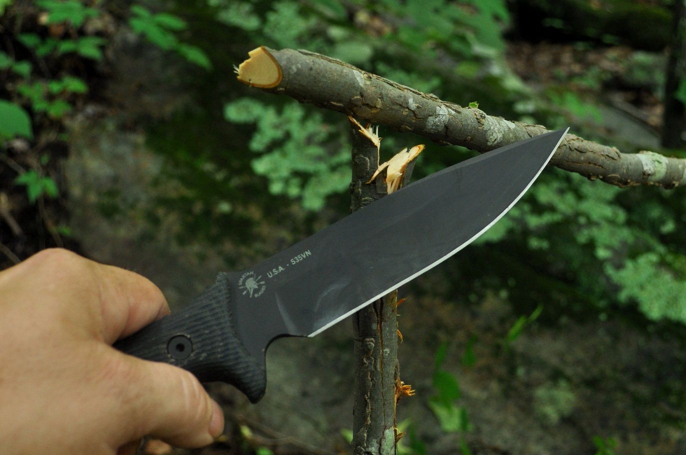

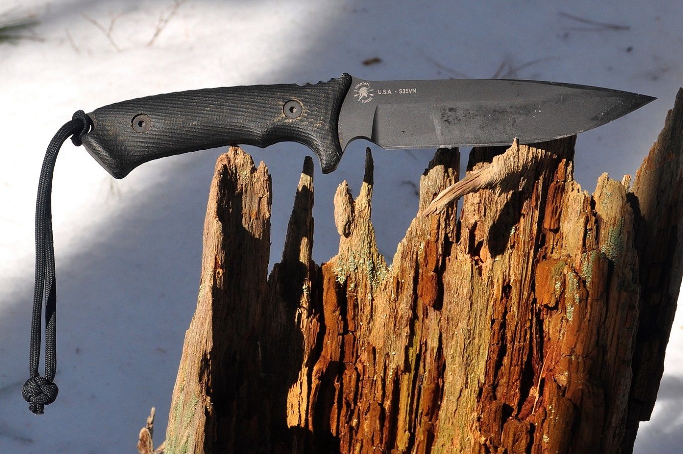

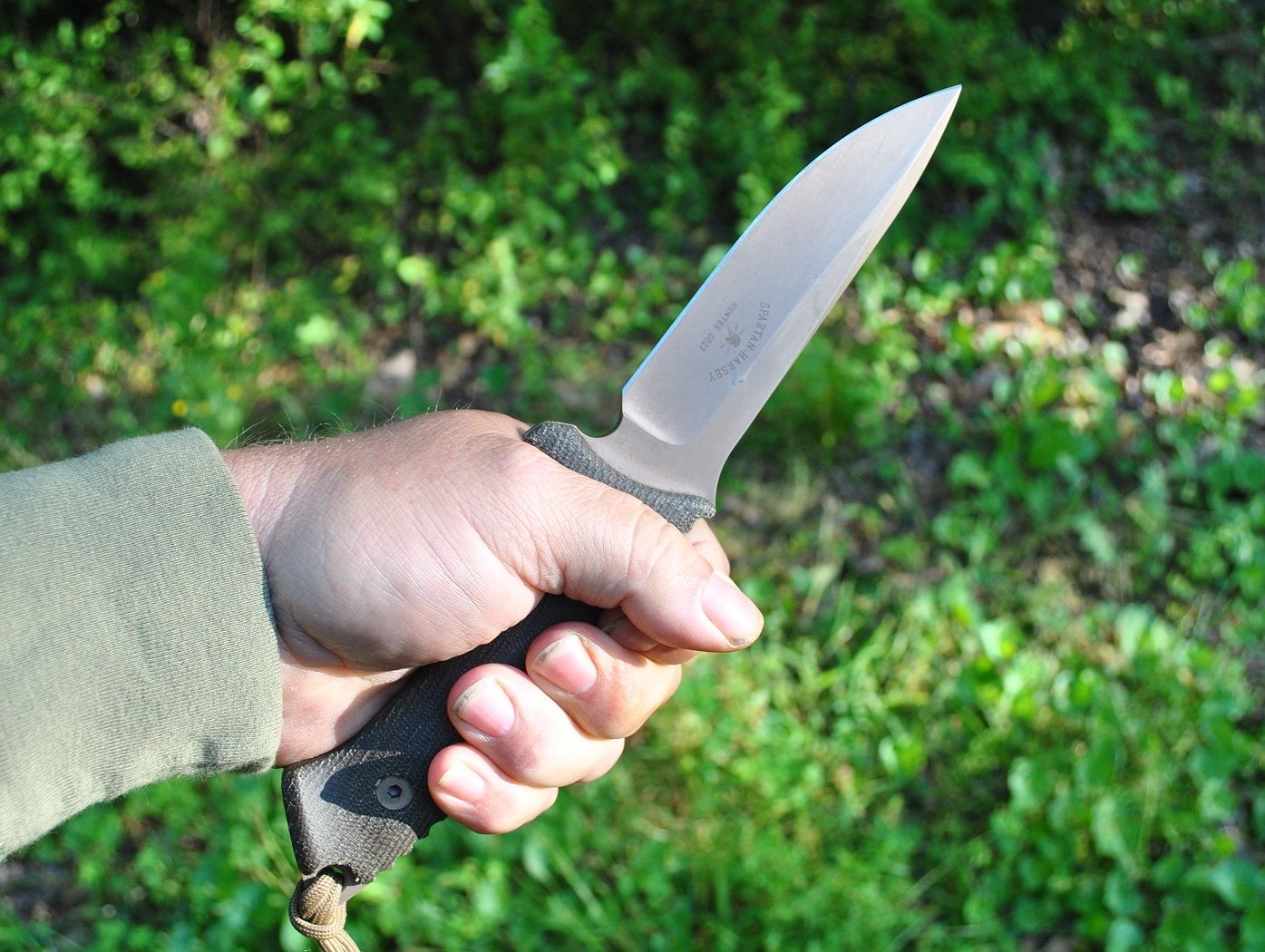

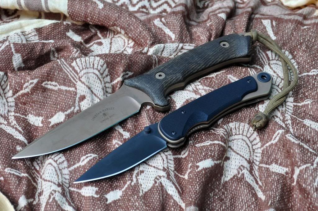

The Spartan-Harsey Hunter, pictured here at nearly two years old, has traveled a lot of miles with me. This particular Spartan Harsey collaboration has a hollow-ground blade that is hand ground by Bill Harsey himself. The grind is exceptionally well done so that it gives the 3/16” thick blade good slicing ability, but is not fragile in hard use the way some dedicated hunting knives are.
The specs from the Spartan website
Designer: William Harsey
Overall Length: 10 1/2"
Blade Length: 5 3/16"
Blade Thickness: 3/16"
Blade Steel: CPM S35VN
Blade Hardness: 59-60 HRC
Blade Style: Drop Point—designed as a sturdy combat & hunting knife.
Coating: SpartaCoat - PVD in ZrN (Flat Dark Earth)
Handle Material: 3D Contoured CE Canvas Micarta® Black or Green
Weight: 0.64 LBS

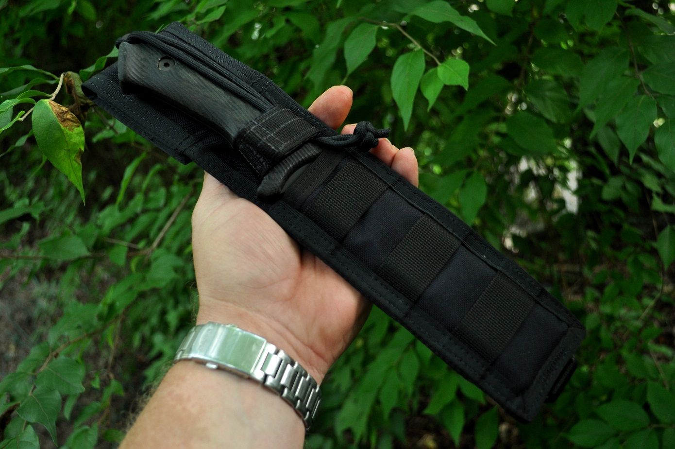

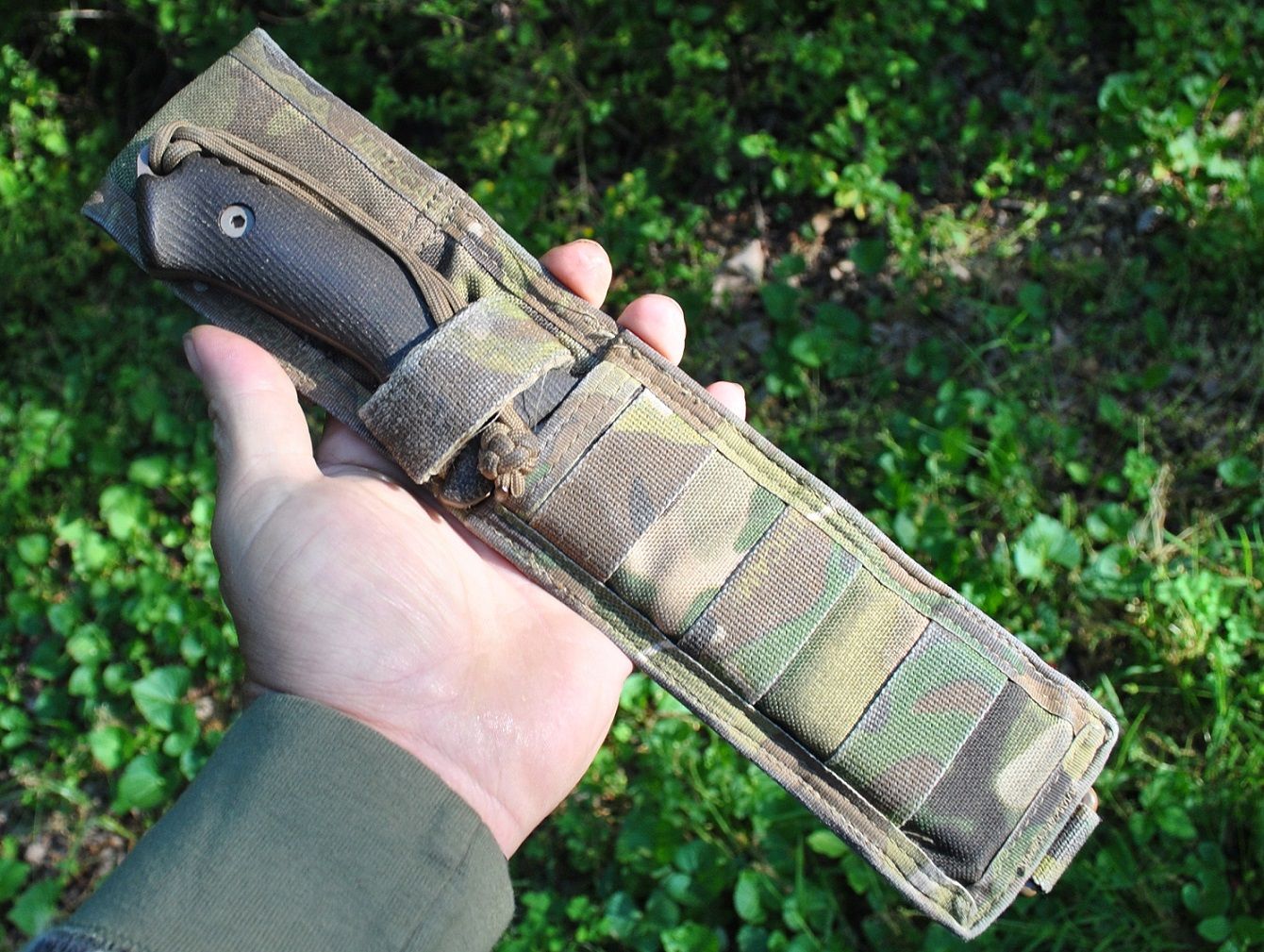

The knife arrived sheathed in a very well made, molle/pals compatible, multi-cam sheath

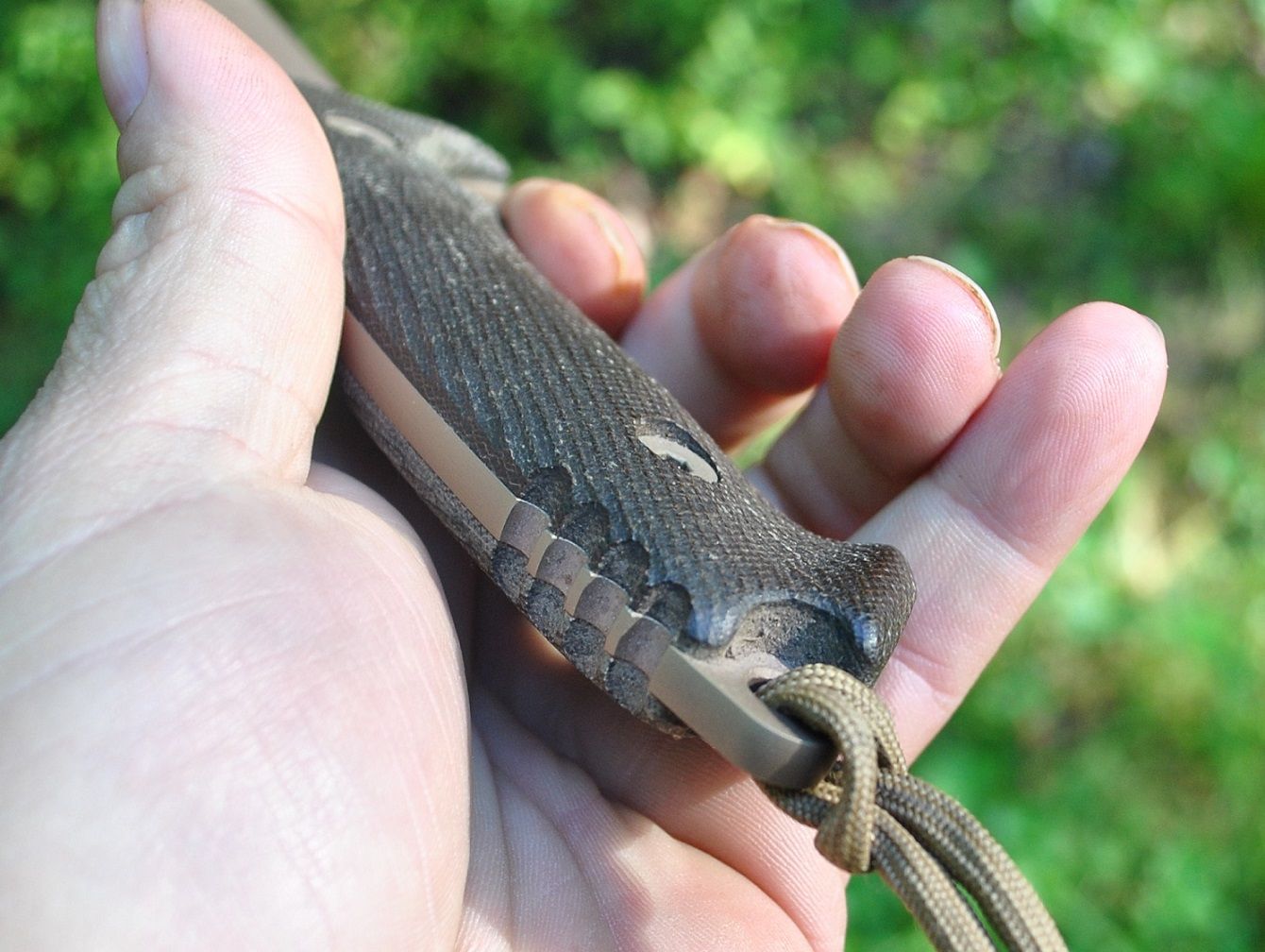

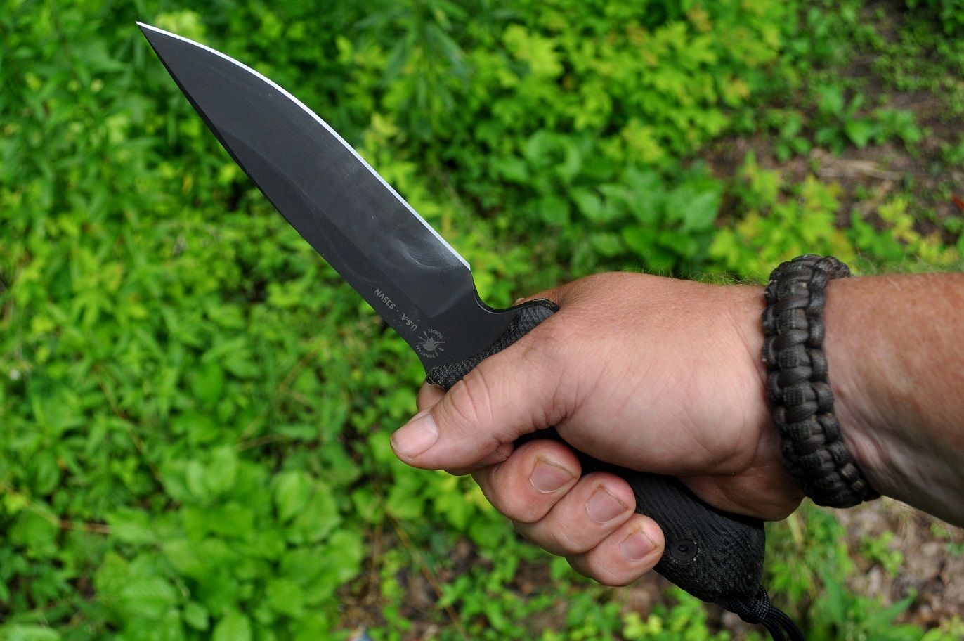

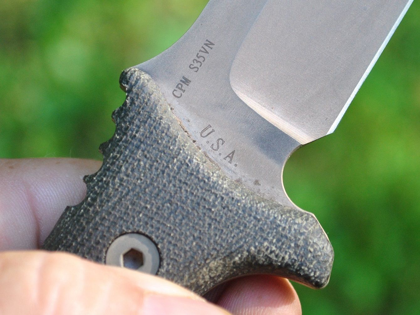

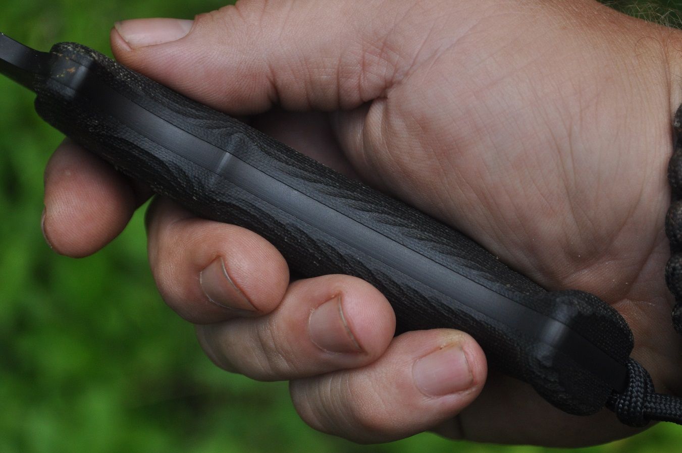

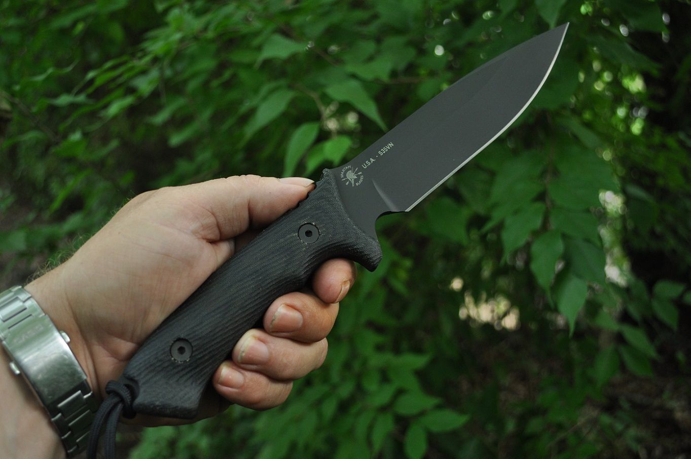

The three-dimensionally contoured handle is very ergonomic and nearly melts into the hand. It textured so that it provides a very secure purchase even in less than ideal conditions. It feels really good in multiple grips and holds
The knife arrived with an extremely sharp edge.

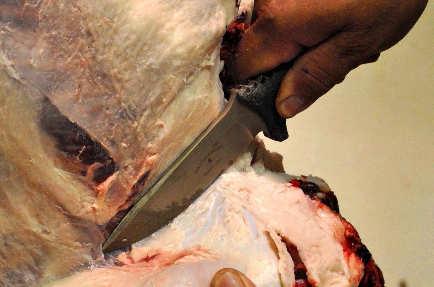

And the handle texture remained easy to grip even with greasy hands

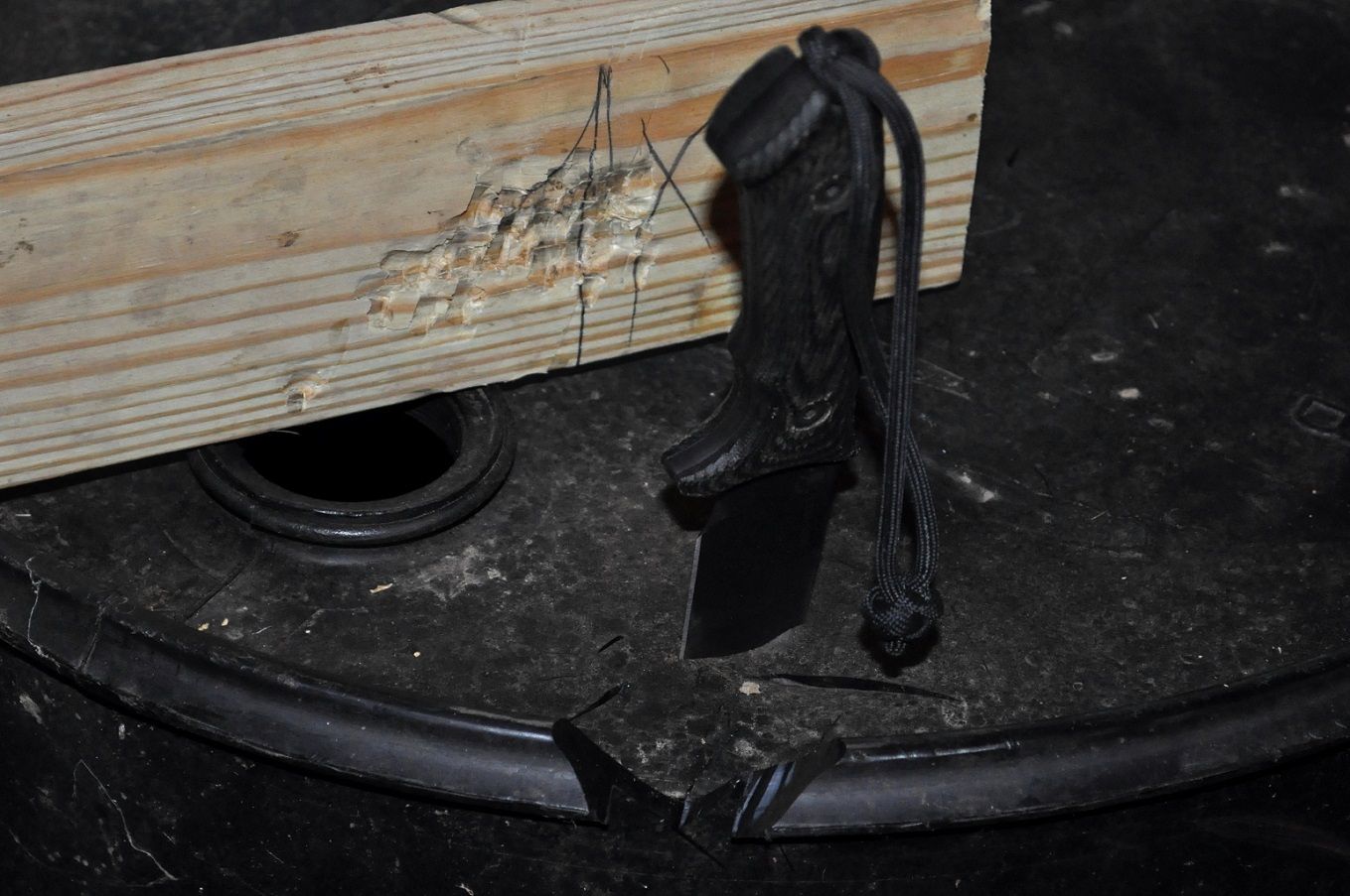

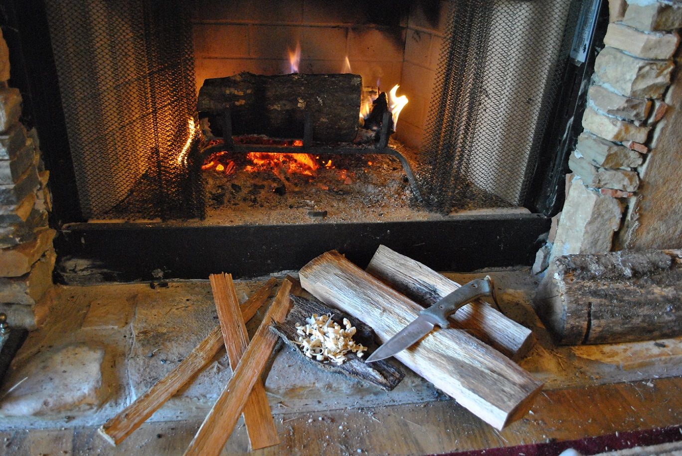

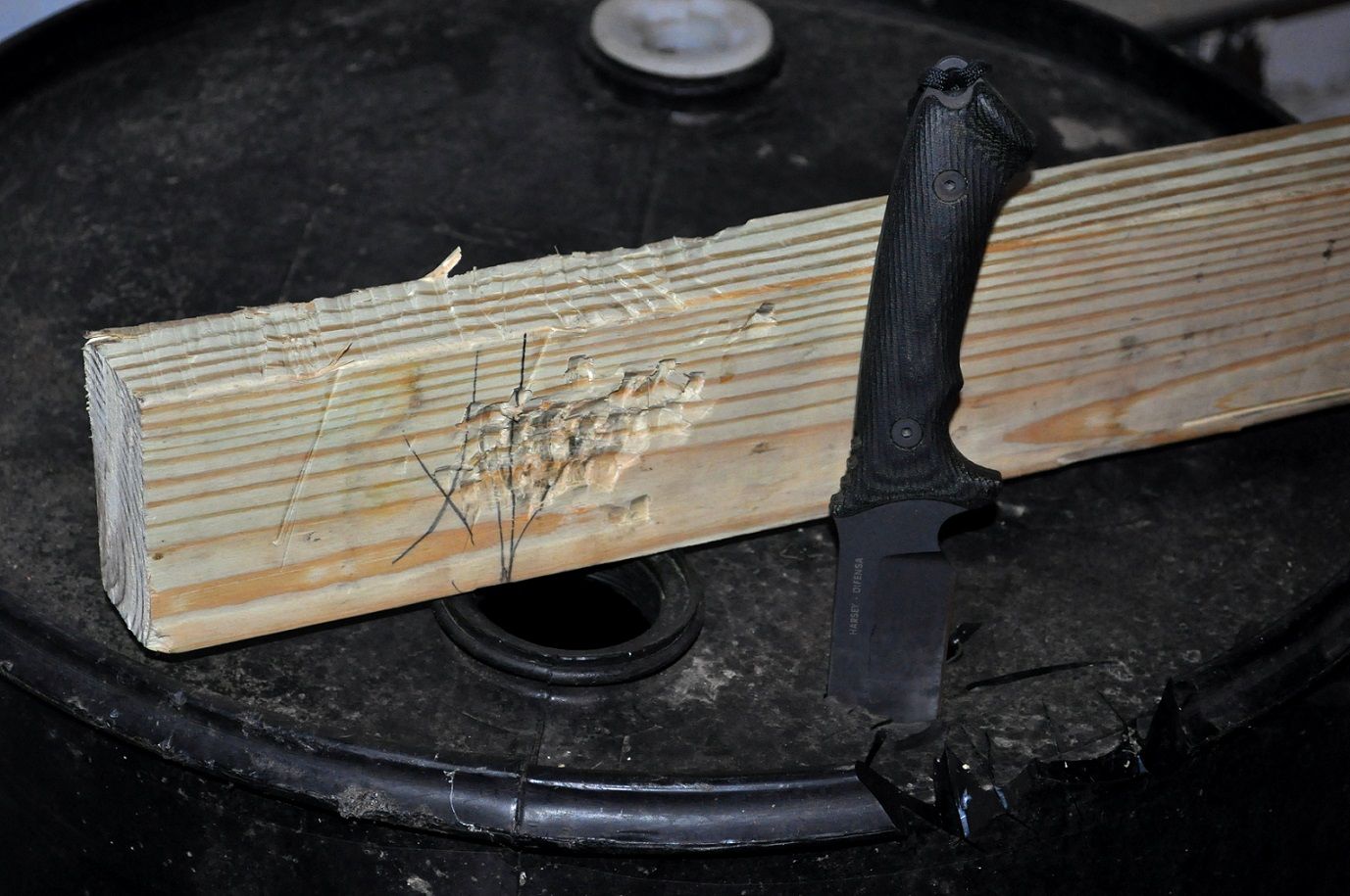

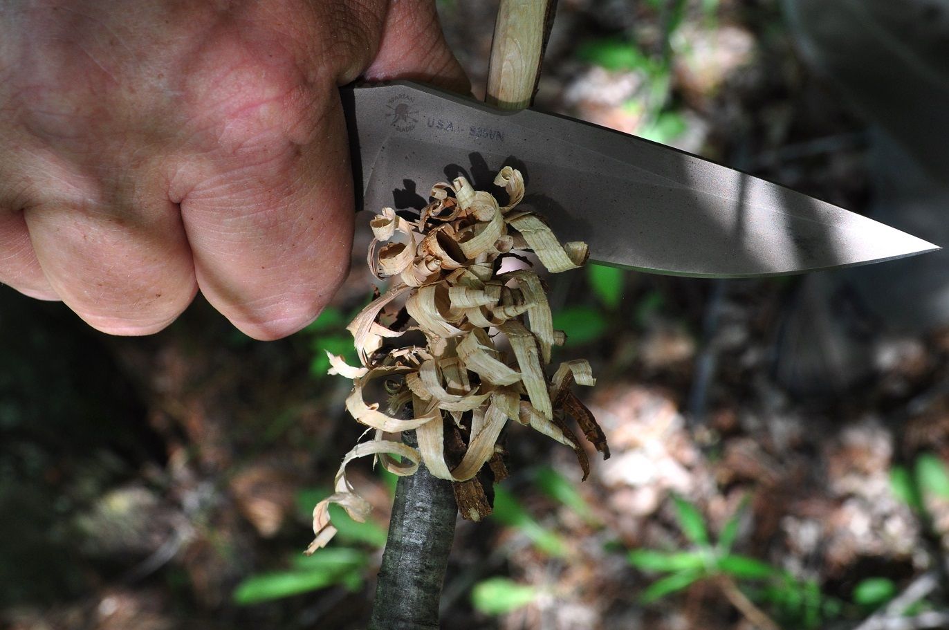

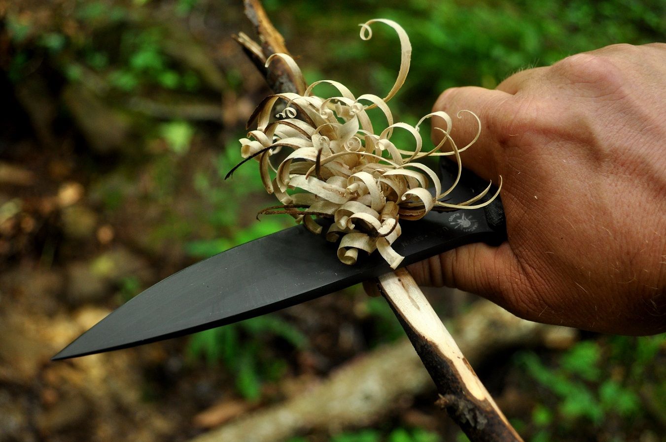

The knife got some hard work right off the bat, processing fire wood at a rental cabin that provided plenty of fire wood but no kindling or ax to split any with. So the Hunter was used first to baton wood into kindling size pieces, and second to whittle shaving for tinder, and handled both in stellar fashion. Very tough for a knife with a hollow-ground edge. What you may think is wear in the coating in these photos is not wear, it is merely the coating picking up material it has passed through. It cleans up well with some WD-40 and a rag.

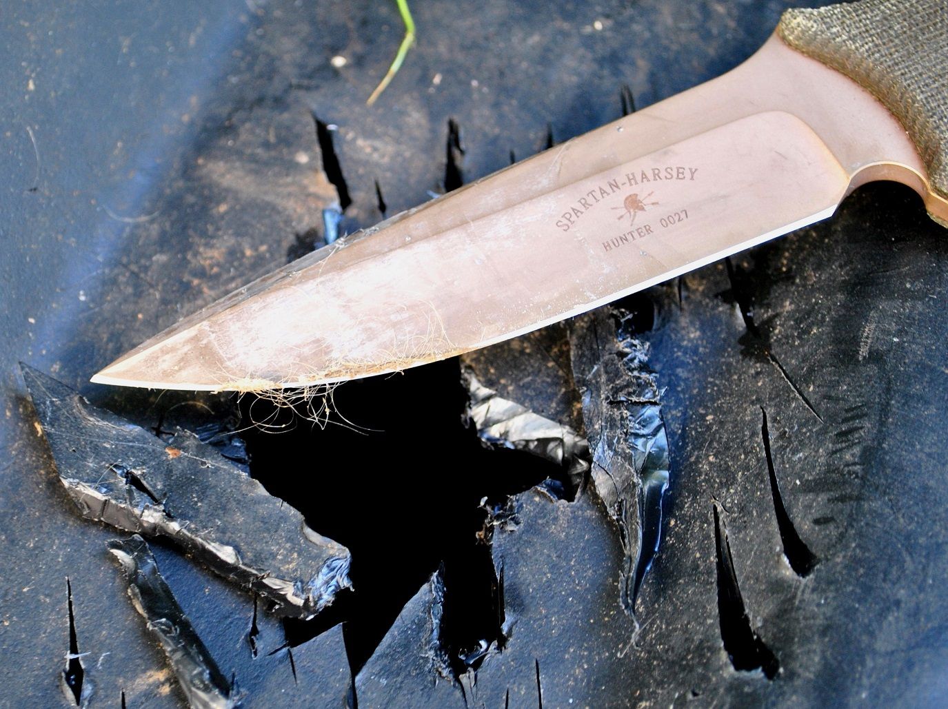

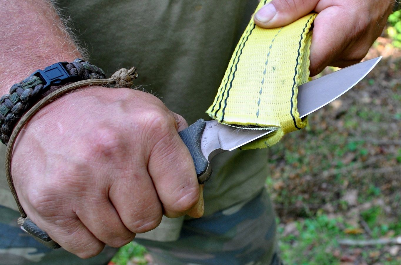

As far as toughness and abrasion resistance tests go...along with various rope and strap cutting, the knife has also been used to open cans on outings, and butcher parts of a truck fuel tank made of heavy wall synthetic material, with parts of the can and the tank caught on the coating being the only sign of use.
The knife has gone to work with me on many adventures, from swamps in south Florida, to frozen woods in northern Michigan, and lots of places in between.
It has been used to gather wild edibles for preparing meals in the field, as well as more than a few meals cooked in hotel rooms.
And the knife is still doing very well, and looking pretty awesome right at three years later

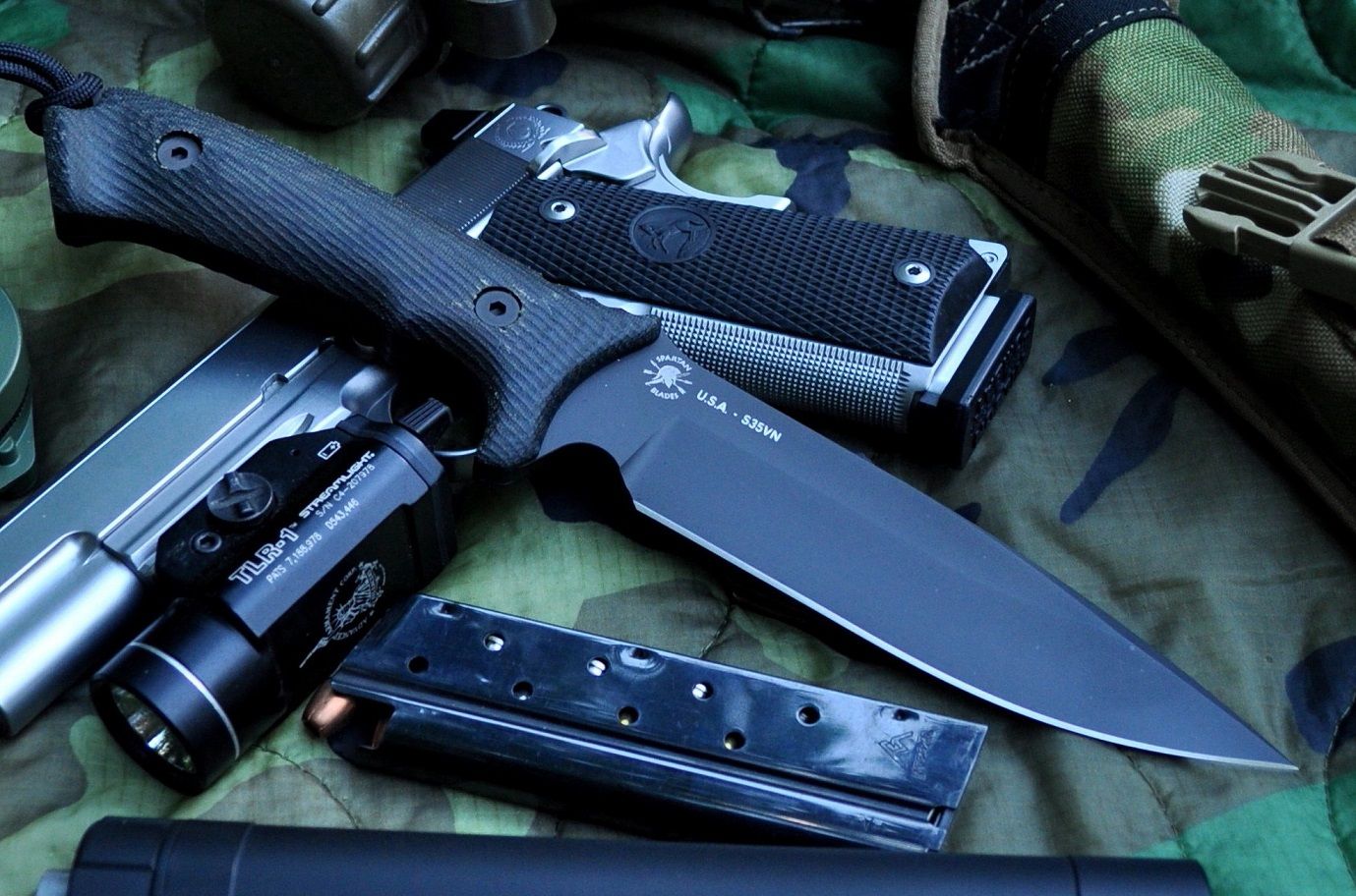

Having put the Hunter through a lot over the course of a few years, when the Difensa came out it was definitely a must have. The Difensa is another collaborative work between Spartan Blades and Bill Harsey, developed for a particular unit of the Canadian Special Forces. It has a flat saber grind rather than a hollow grind.

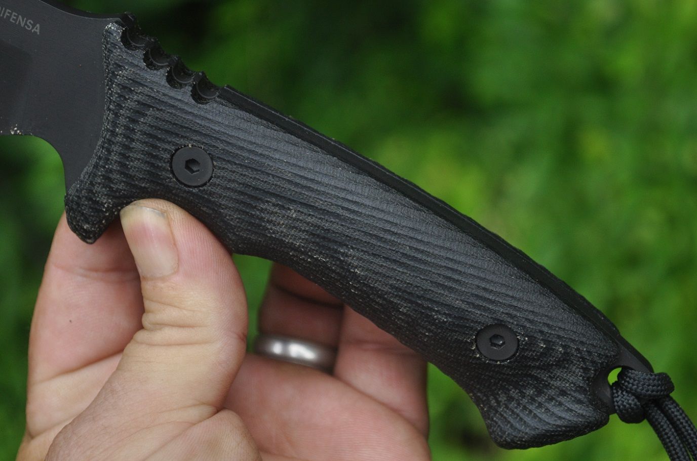

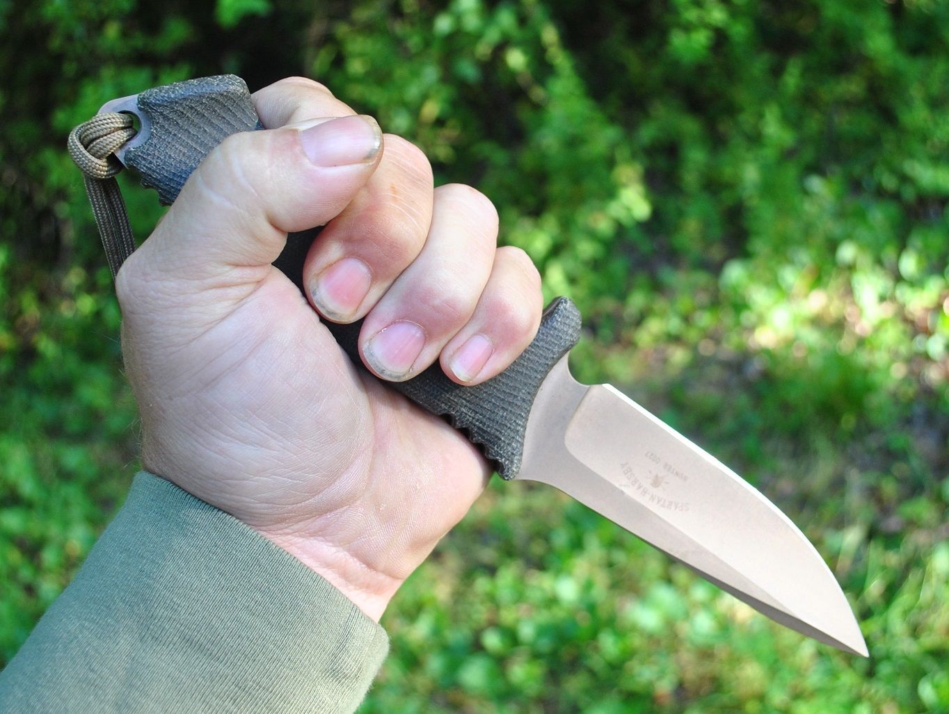

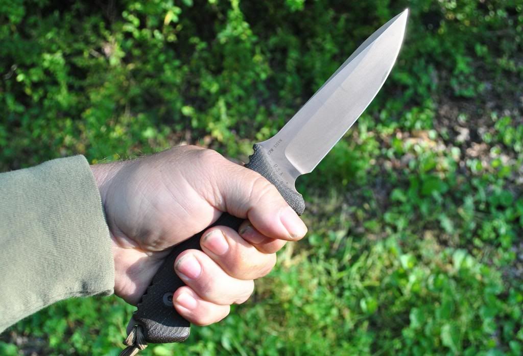

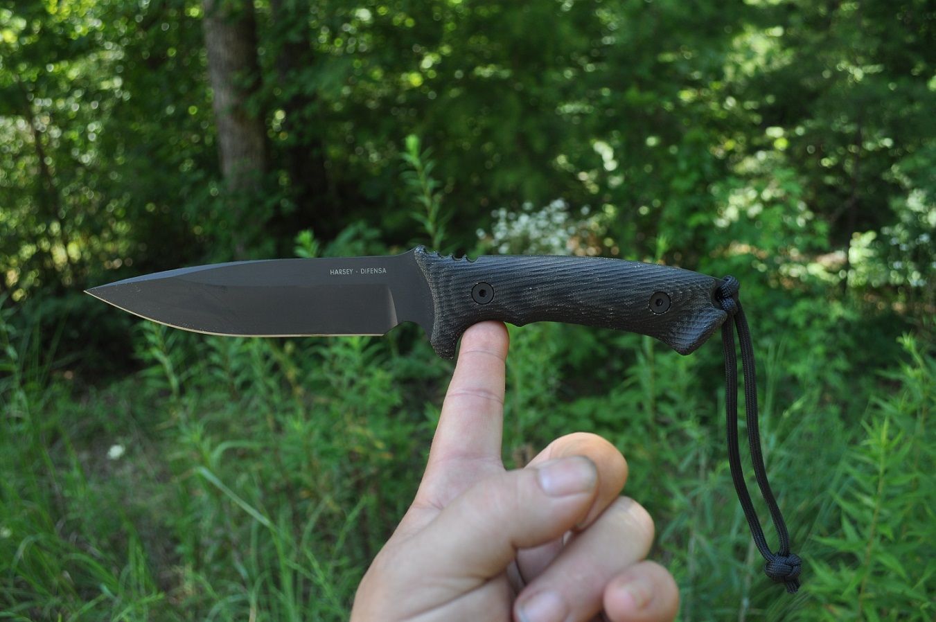

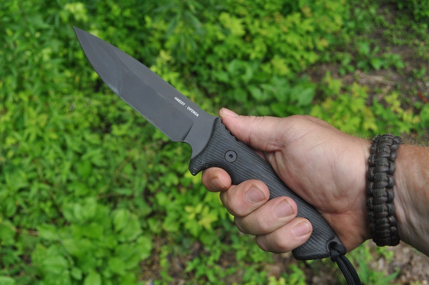

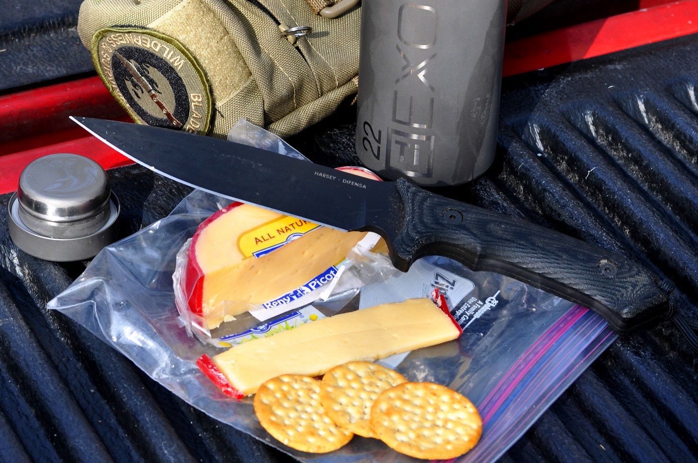

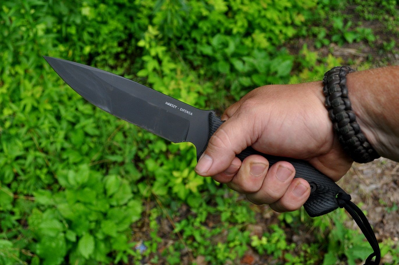

It has a similar, but not quite identical handle, but has the same secure purchase, and excellent ergonomics as the Hunter.
The Difensa has a perfect neutral balance and handles very well
It too came with an extremely sharp edge.

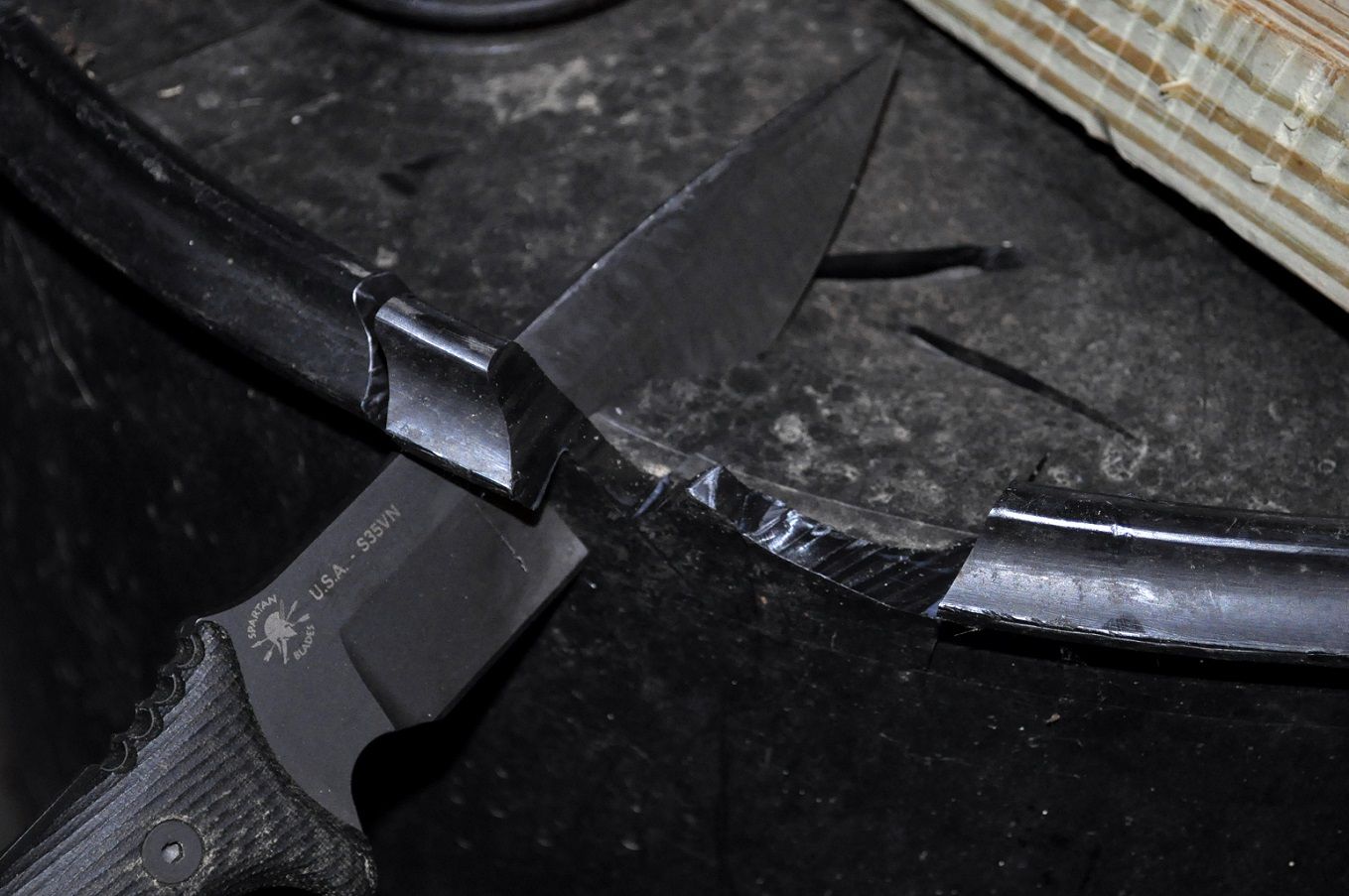

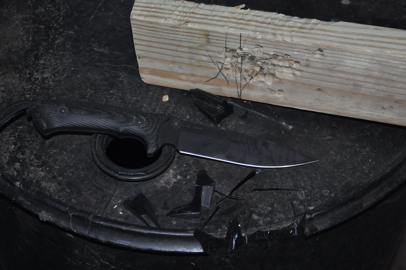

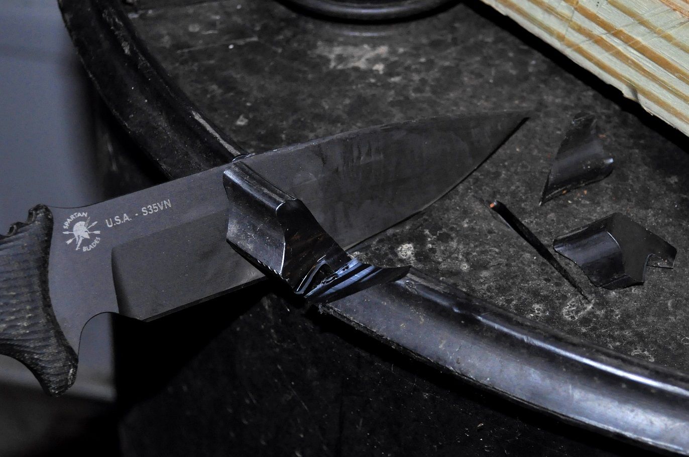

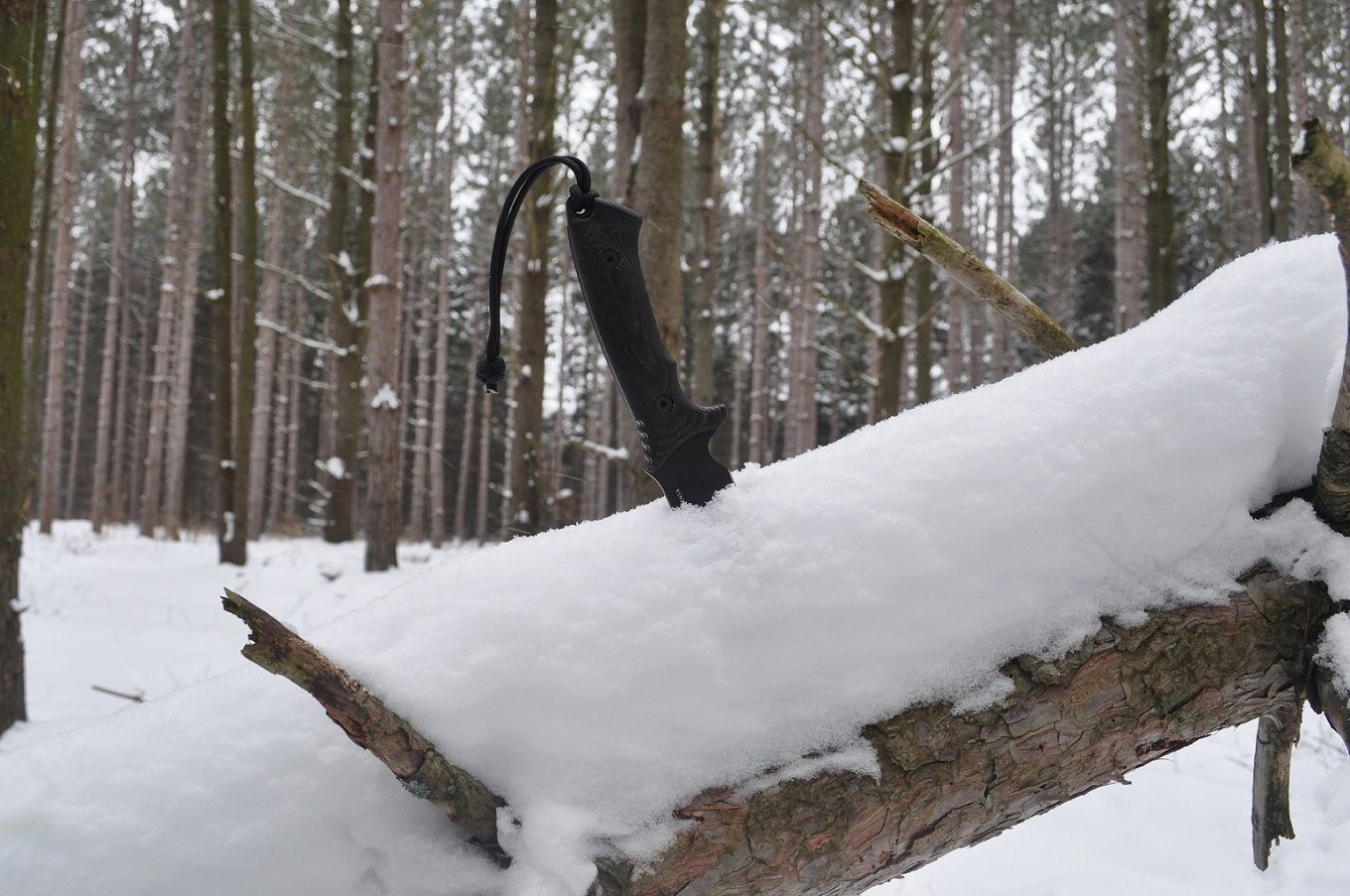

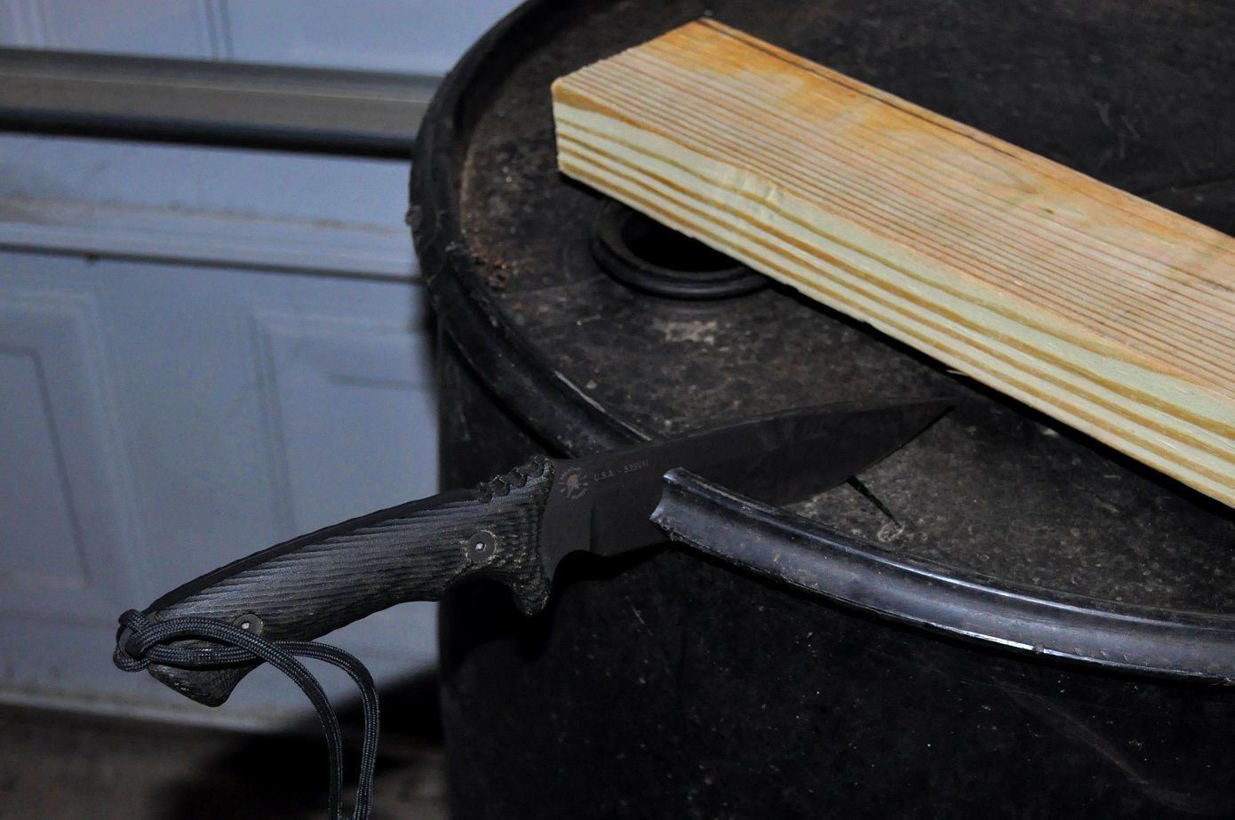

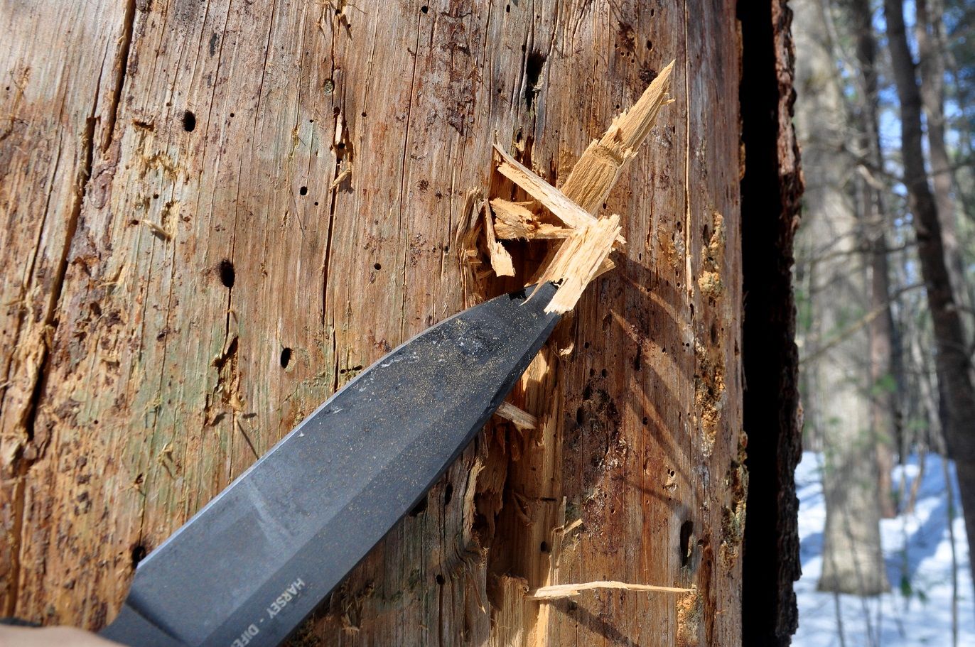

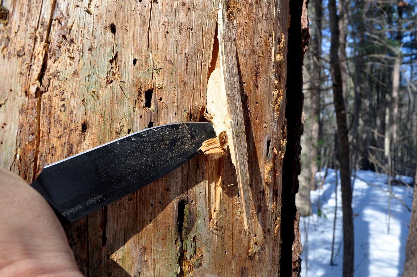

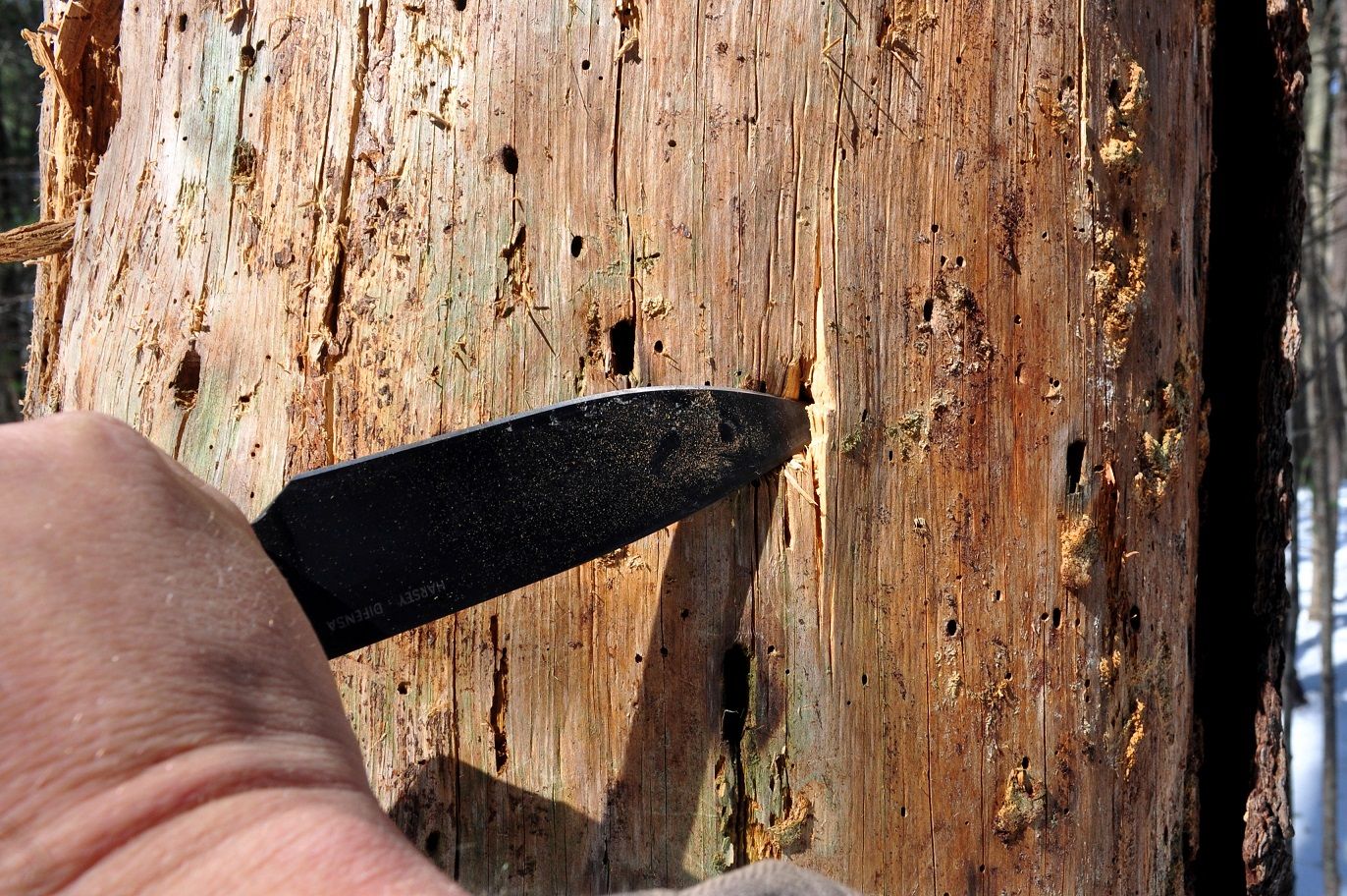

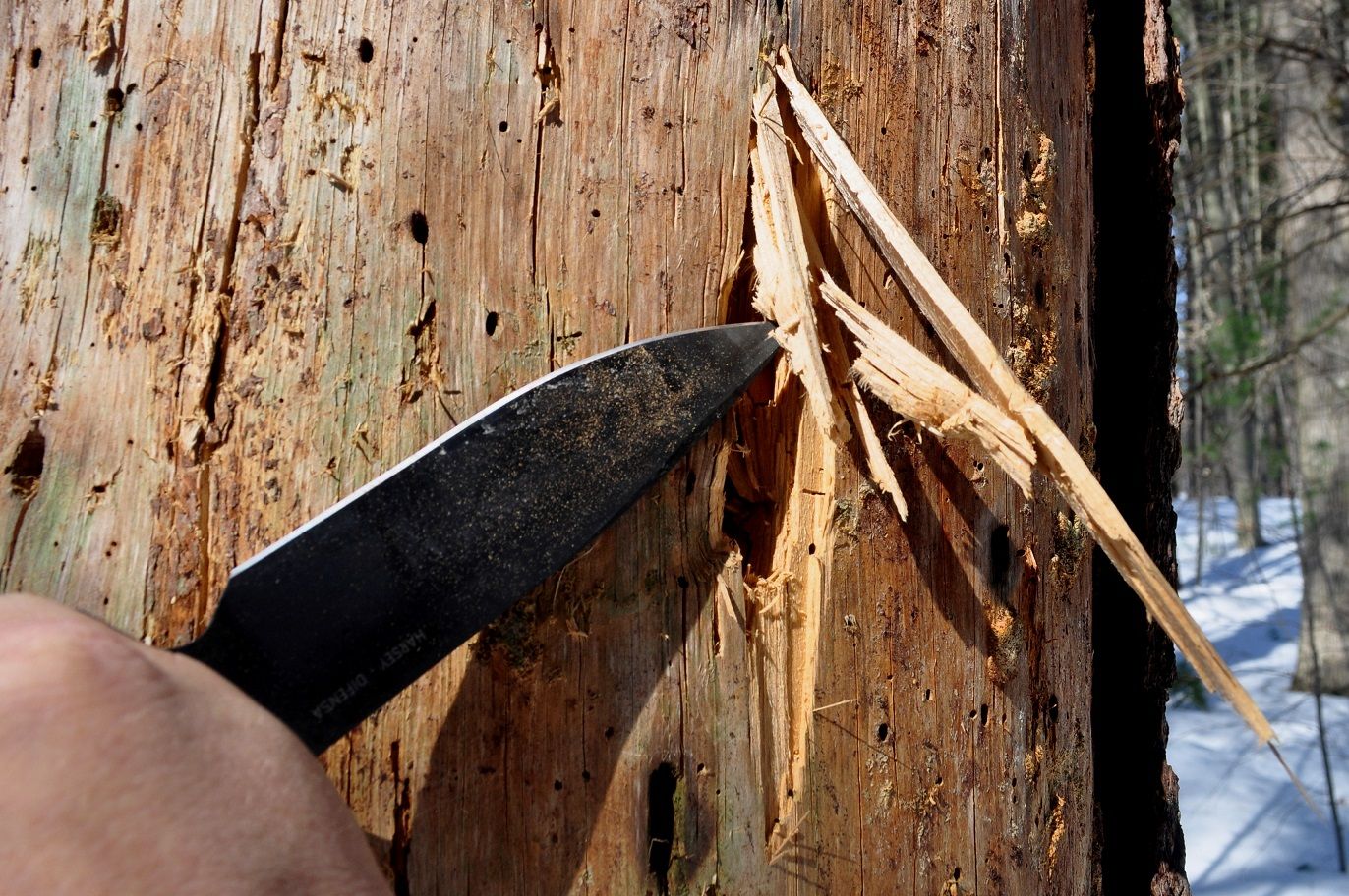

Having started lightly with the Hunter and working my way in, after initial cutting tests with the Difensa I just sort of jumped right into the heavier stuff. I used a plastic drum to test the edge and tip toughness, and if you look at the dents in the hard treated yellow pine, you can tell I wasn't exactly being gentle with it. There was some very slight edge degradation, but nothing noticeable by eye.

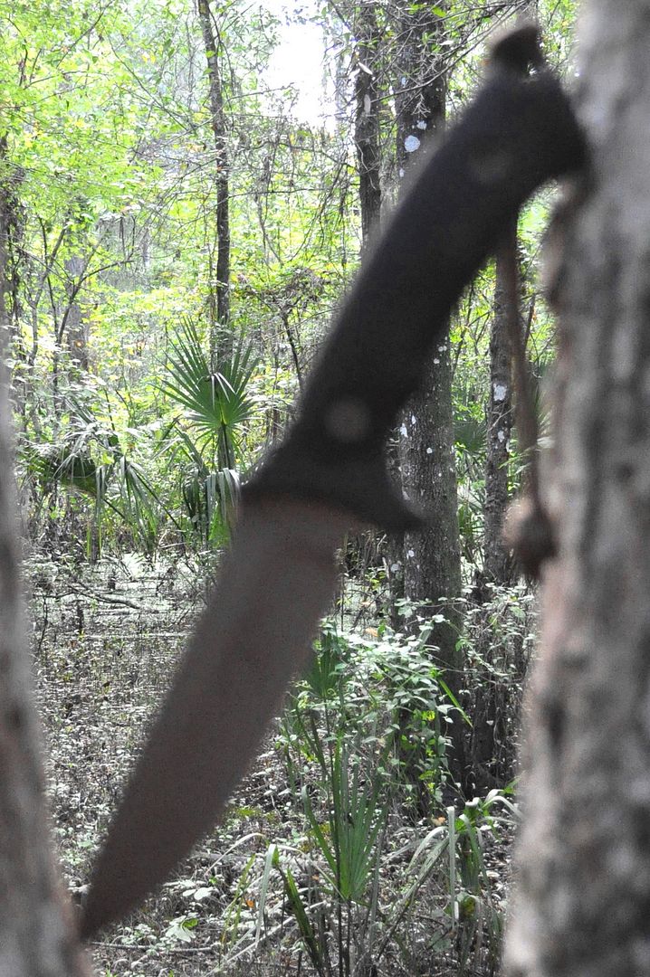

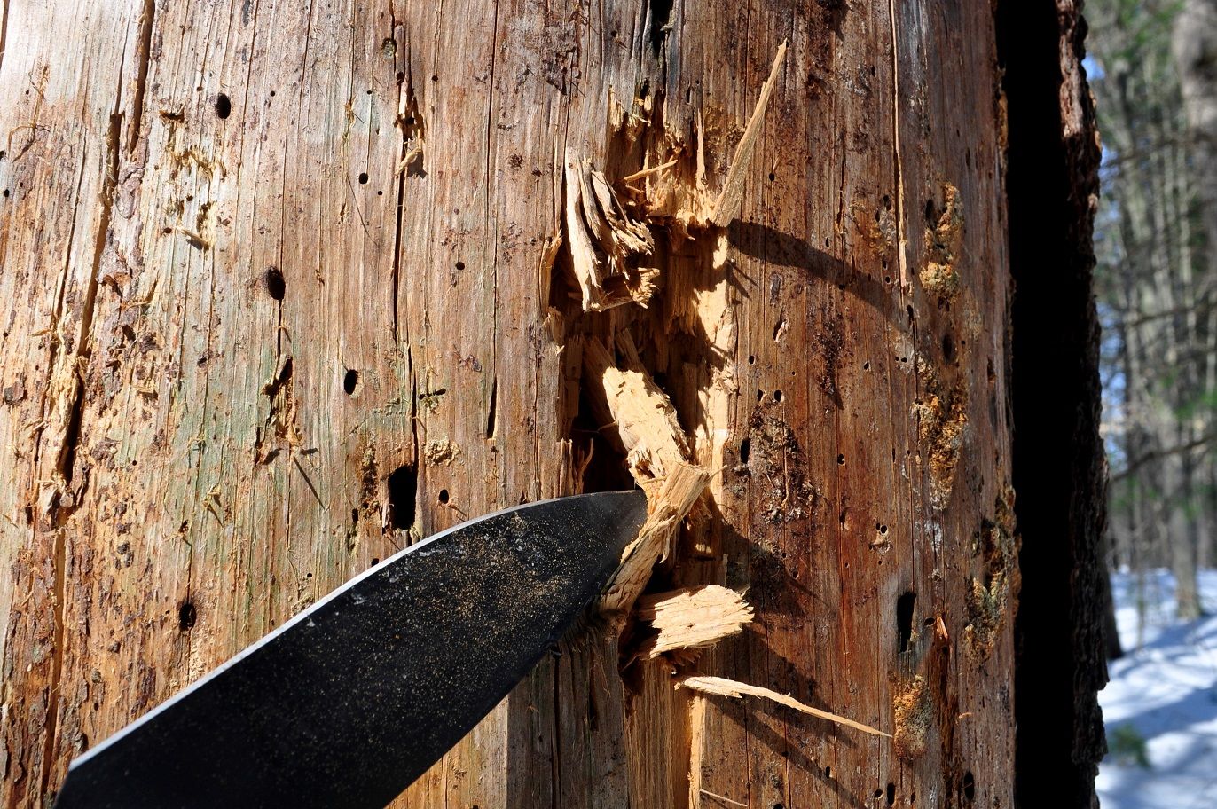

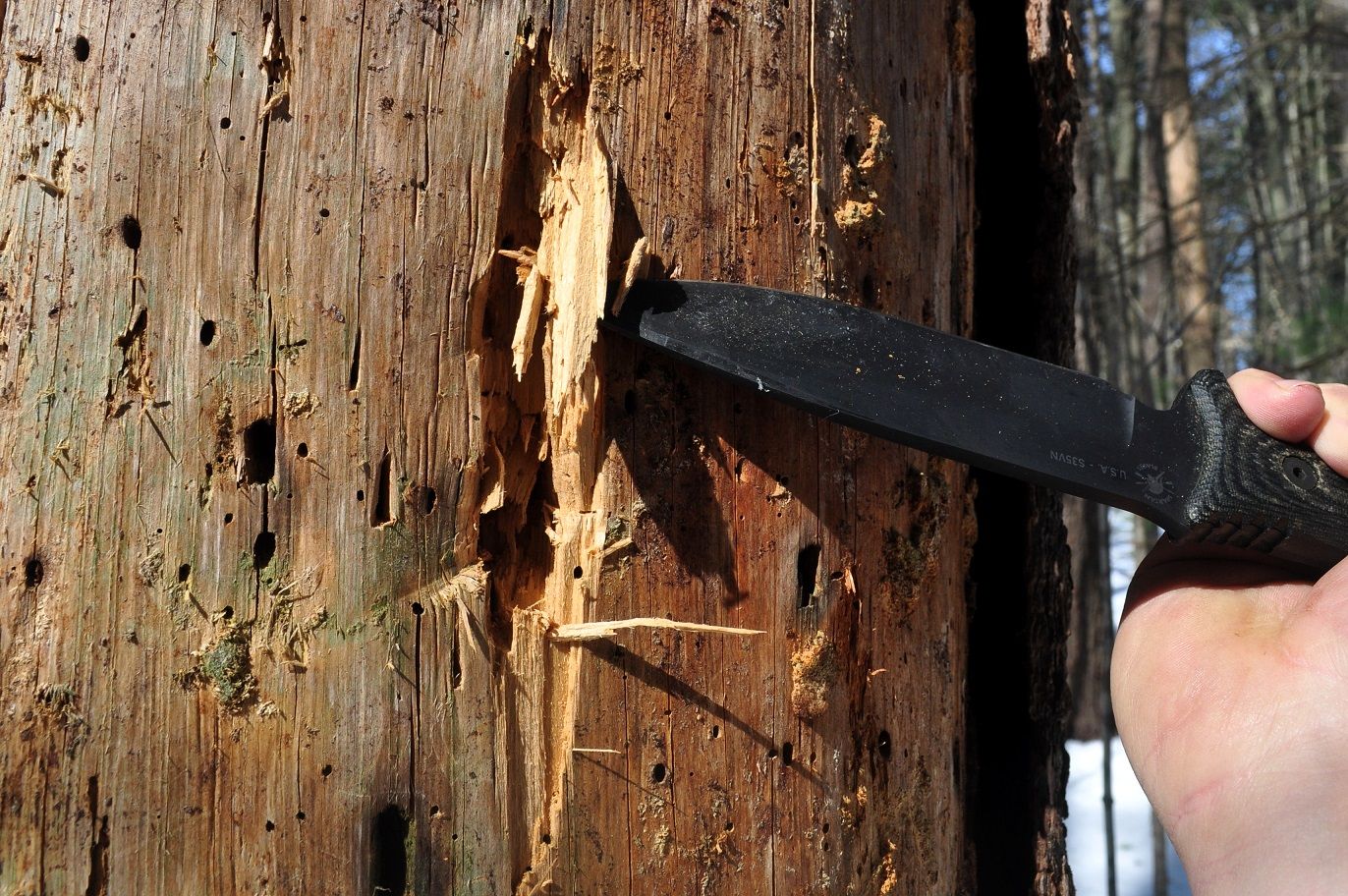

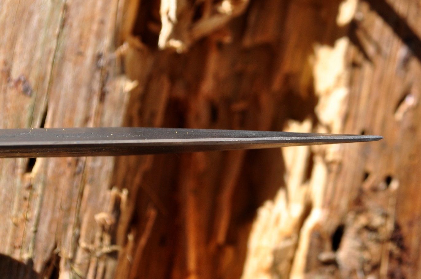

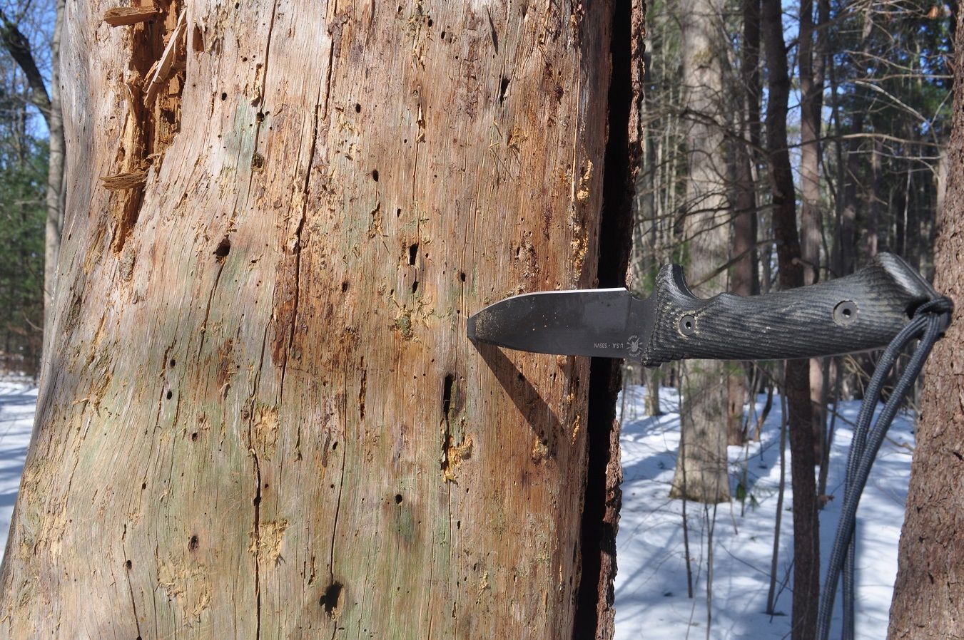

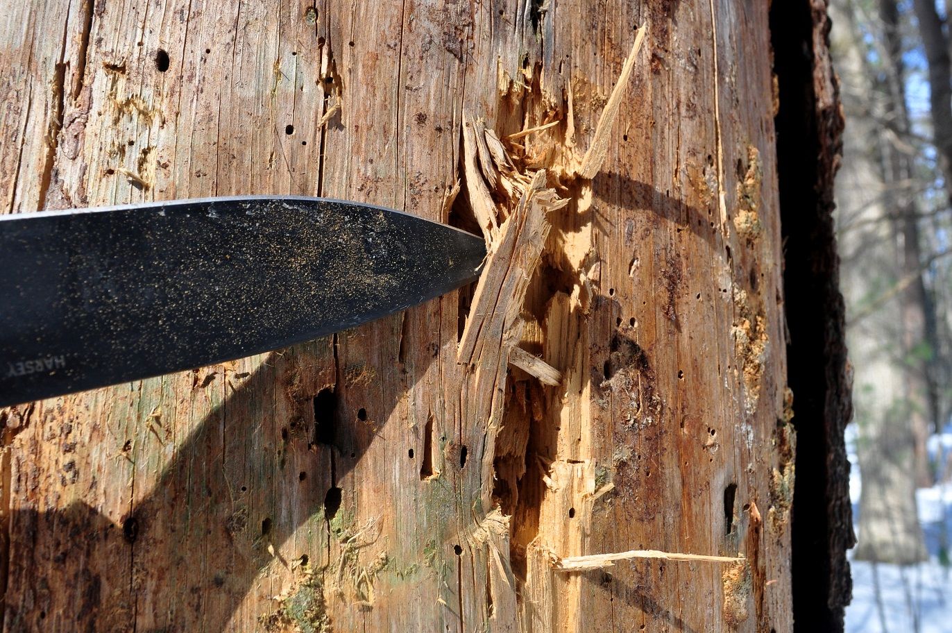

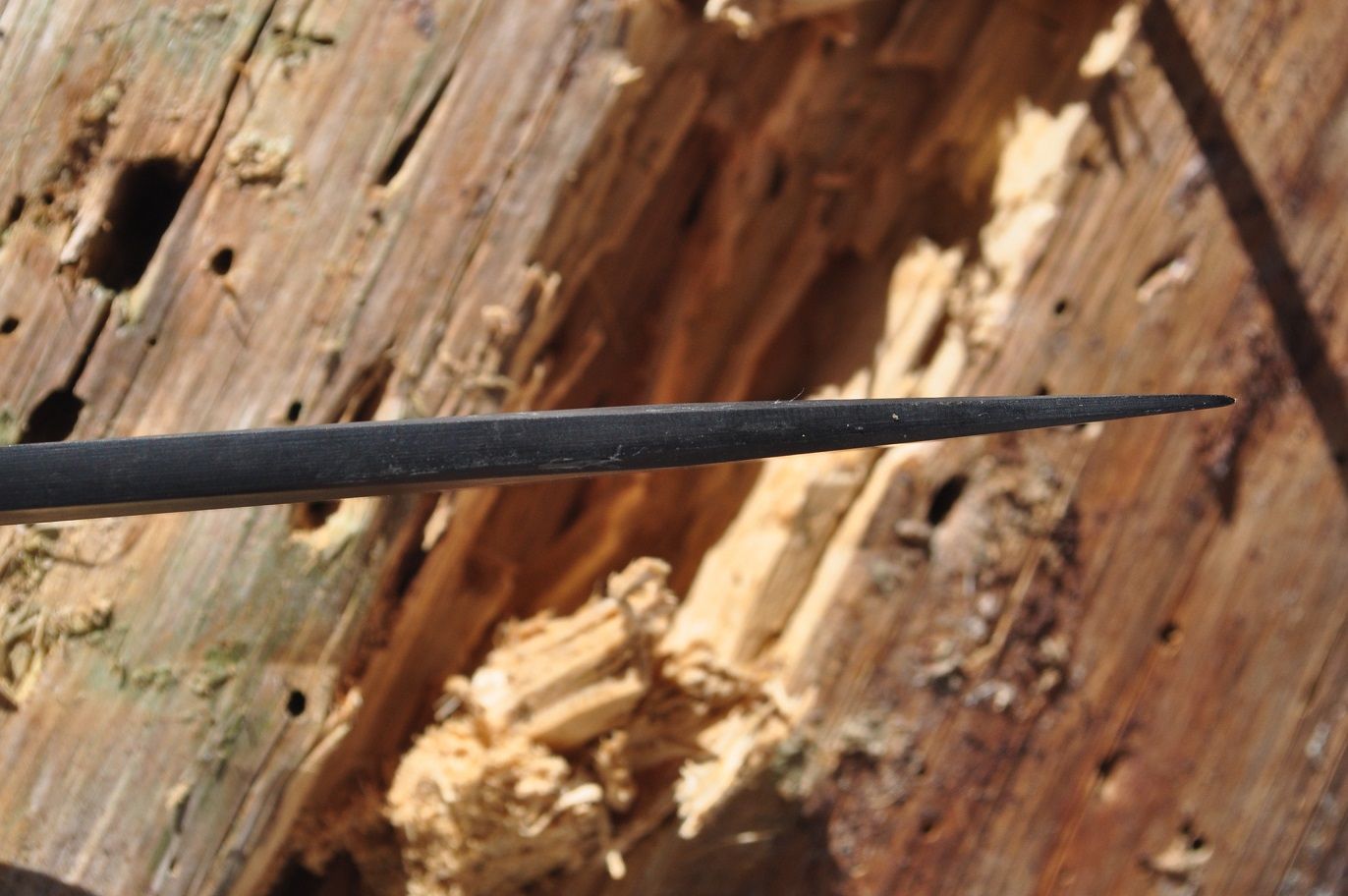

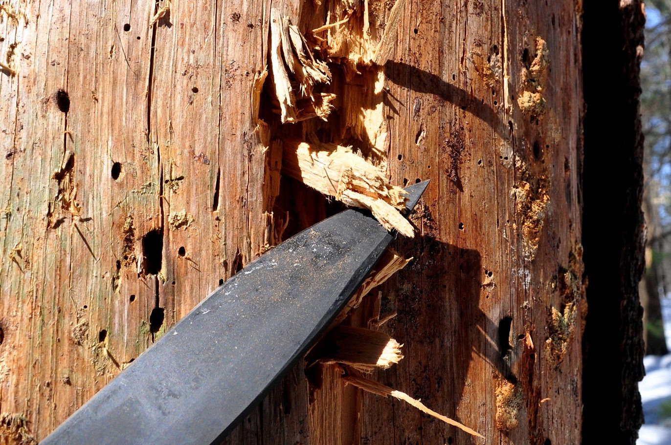

Next while I had it out on a hike this past winter I found a standing dead pine tree that looked like a good place to test tip strength. So far the only thing I know about who is doing Spartan's heat treat is that they are an older family run company in their area, but they definitely know what they are doing.
Both the Hunter and Difensa are fantastic knives, but both are a bit big for me to carry on a daily basis...and having really put these two through a lot, I really wanted a smaller one to carry on a regular basis. So the Phrike caught my attention. I haven't had it as long but am really liking it so far.

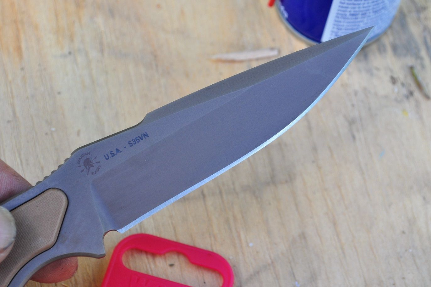

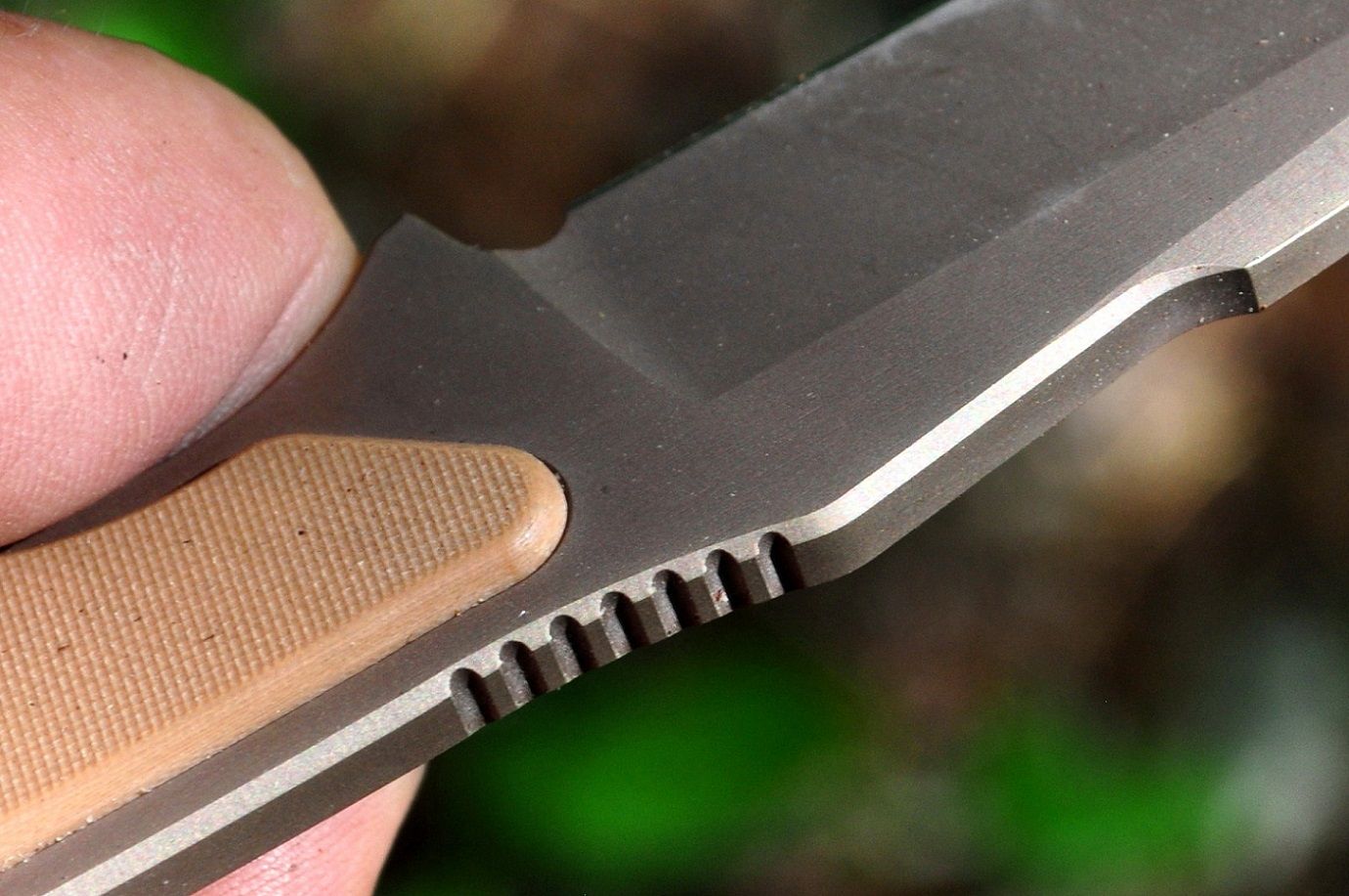

The specs from Spartan
Knife Name: Phrike
Designer(s): Iovito/Carey
Blade Length: 4.25"
Overall Length: 8.50"
Blade Steel: S35VN
Blade Style: Fixed, Swedged Drop Point
Coating: SpartaCoat – PVD – Tungsten DLC (Flat Black) or ZrN (Flat Dark Earth)
Handle Material: G10 (Black, Green, and Coyote Tan)
Sheath: Lined Nylon MOLLE sheath (Black, Coyote Tan & Multi-Cam) or Kydex w/IWB loop.
Weight: 0.244 LBS

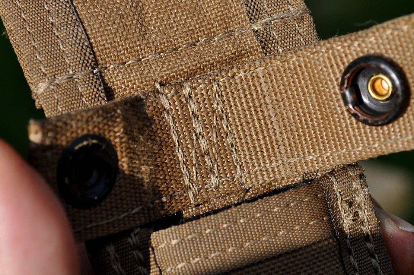

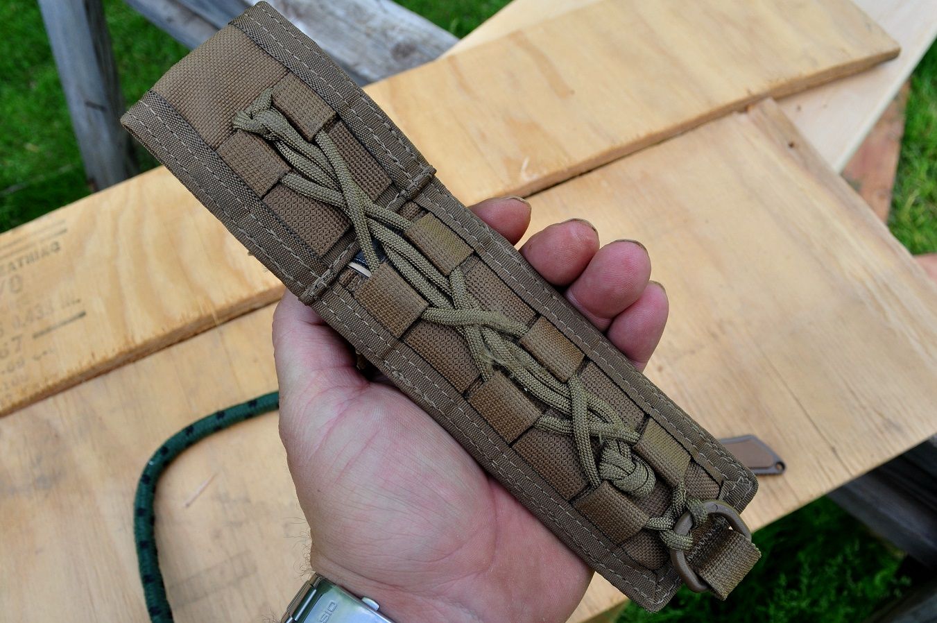

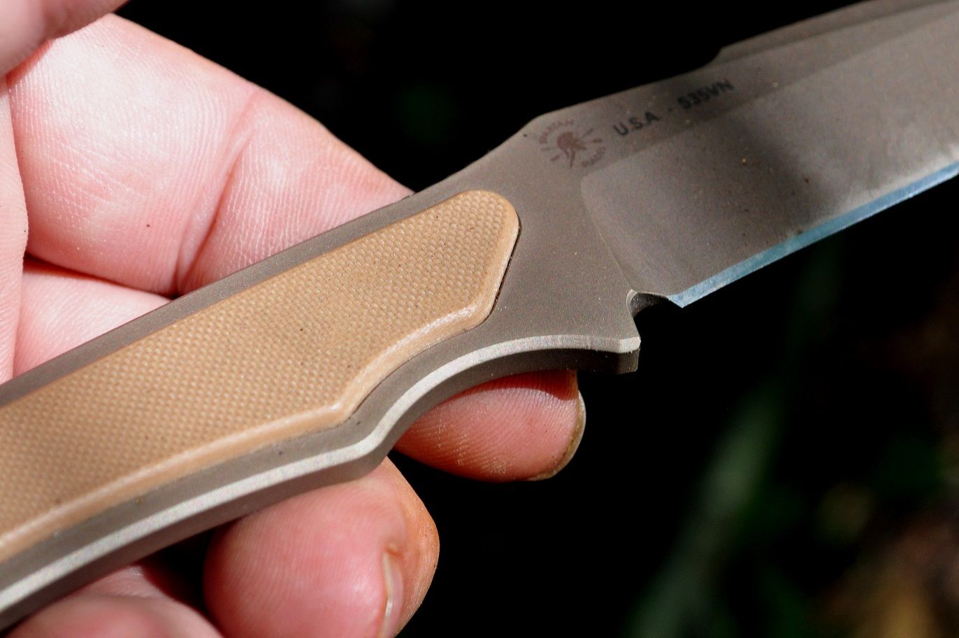

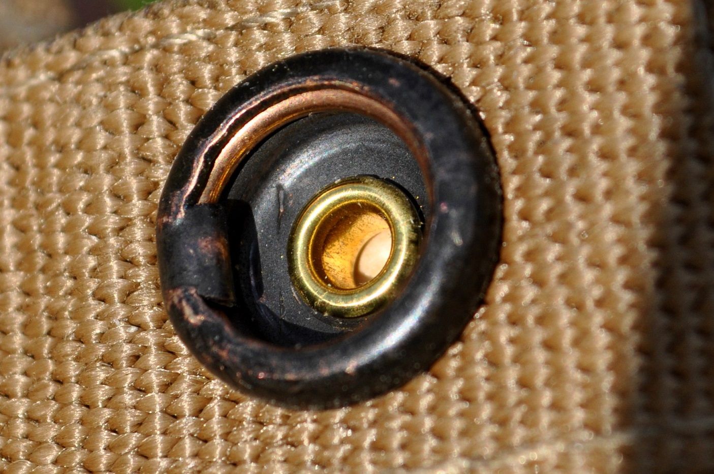

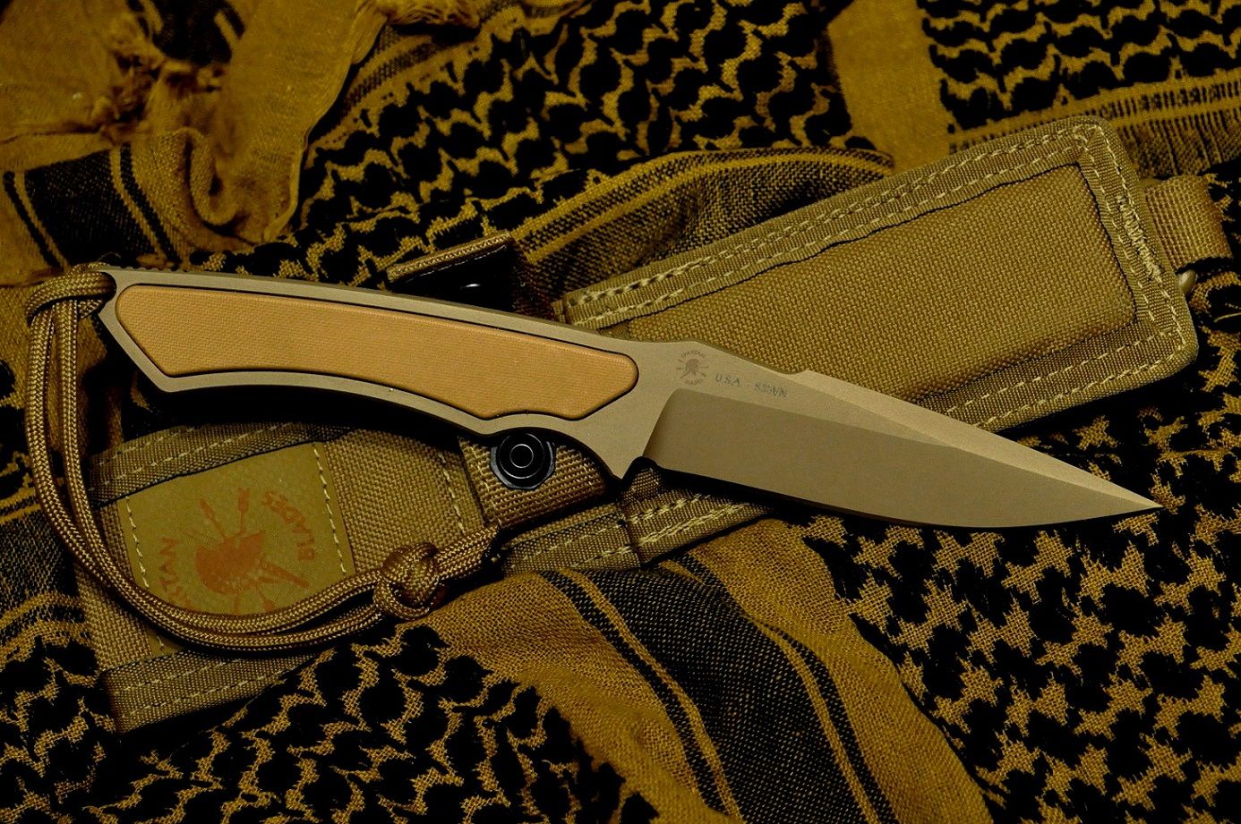

It comes in a similar molle compatible sheath, and I love the high quality corrosion resistant metal snap closures they use, as well as the heavy duty stitching.

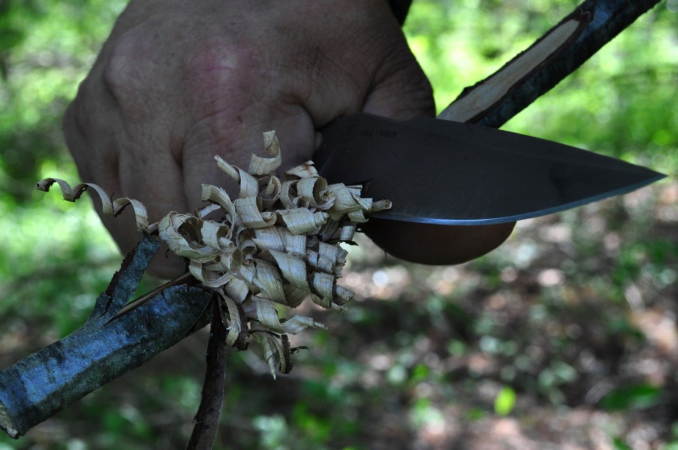

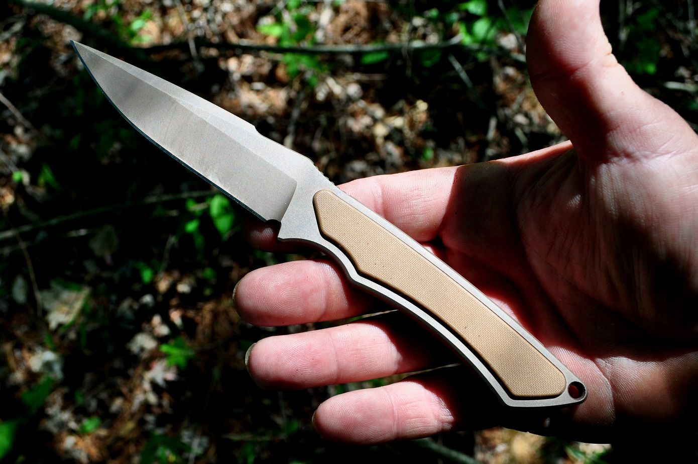

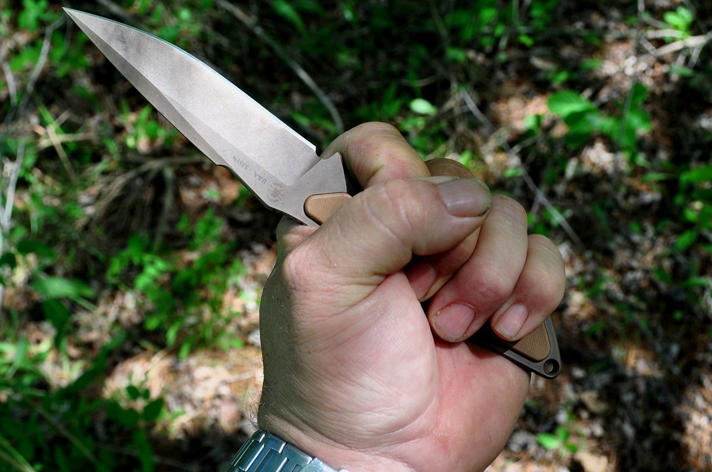

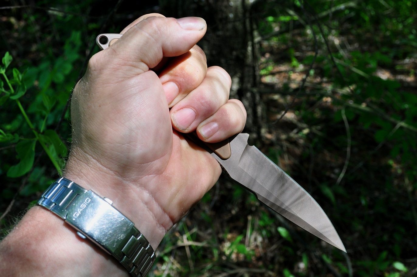

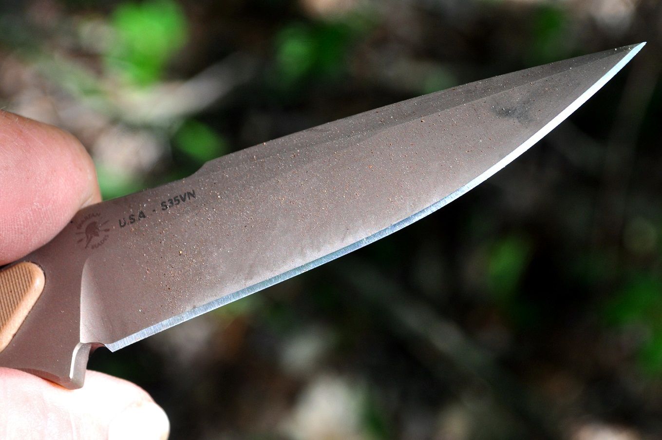

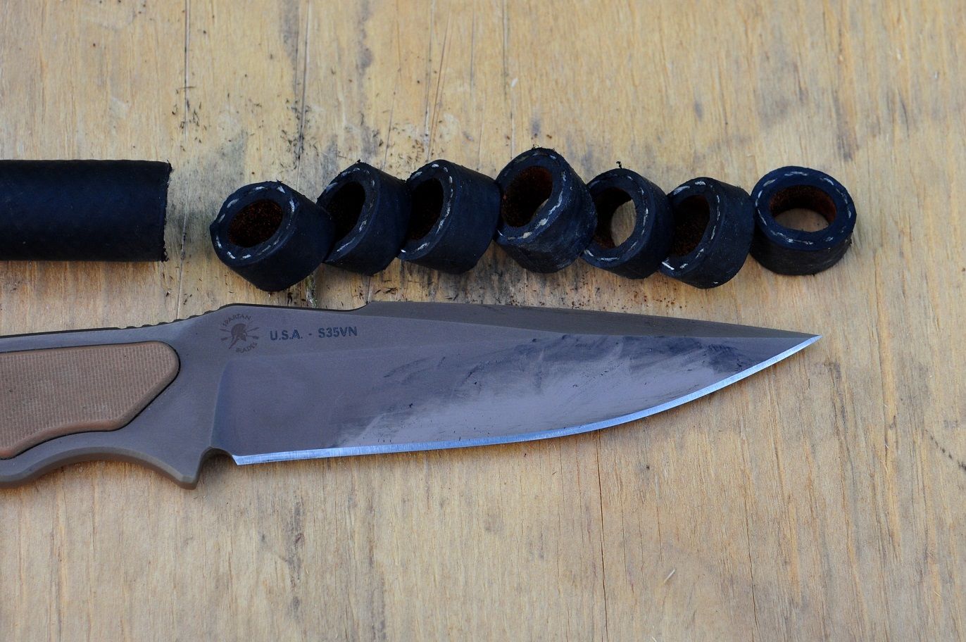

The Phrike is designed as a handy utility/”hey get off me” knife, and is a handier size for me to carry on a regular basis.

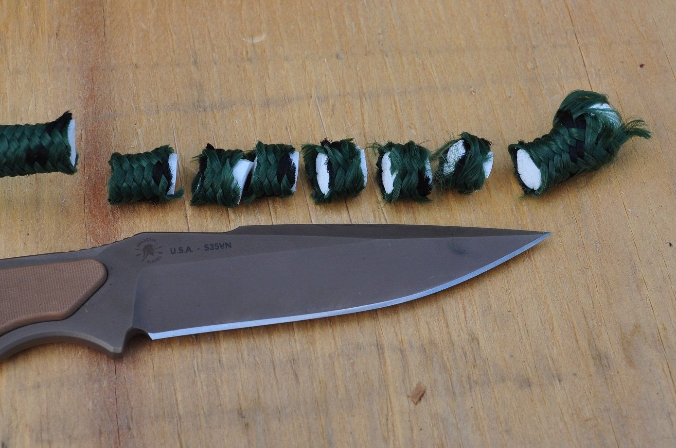

The Phrike is roughly the size of the average bushcrafting knife. It is thin and light. With the handle being thinner than some, I'm sure I wouldn't want to spend hours carving spoons with it, but with Spartan a lot is in the little details, like all of the outside corners being chamfered or rounded. The knife is not uncomfortable for me to use in most regular cutting applications even in non-gloved hands. It too came with a very nice edge.

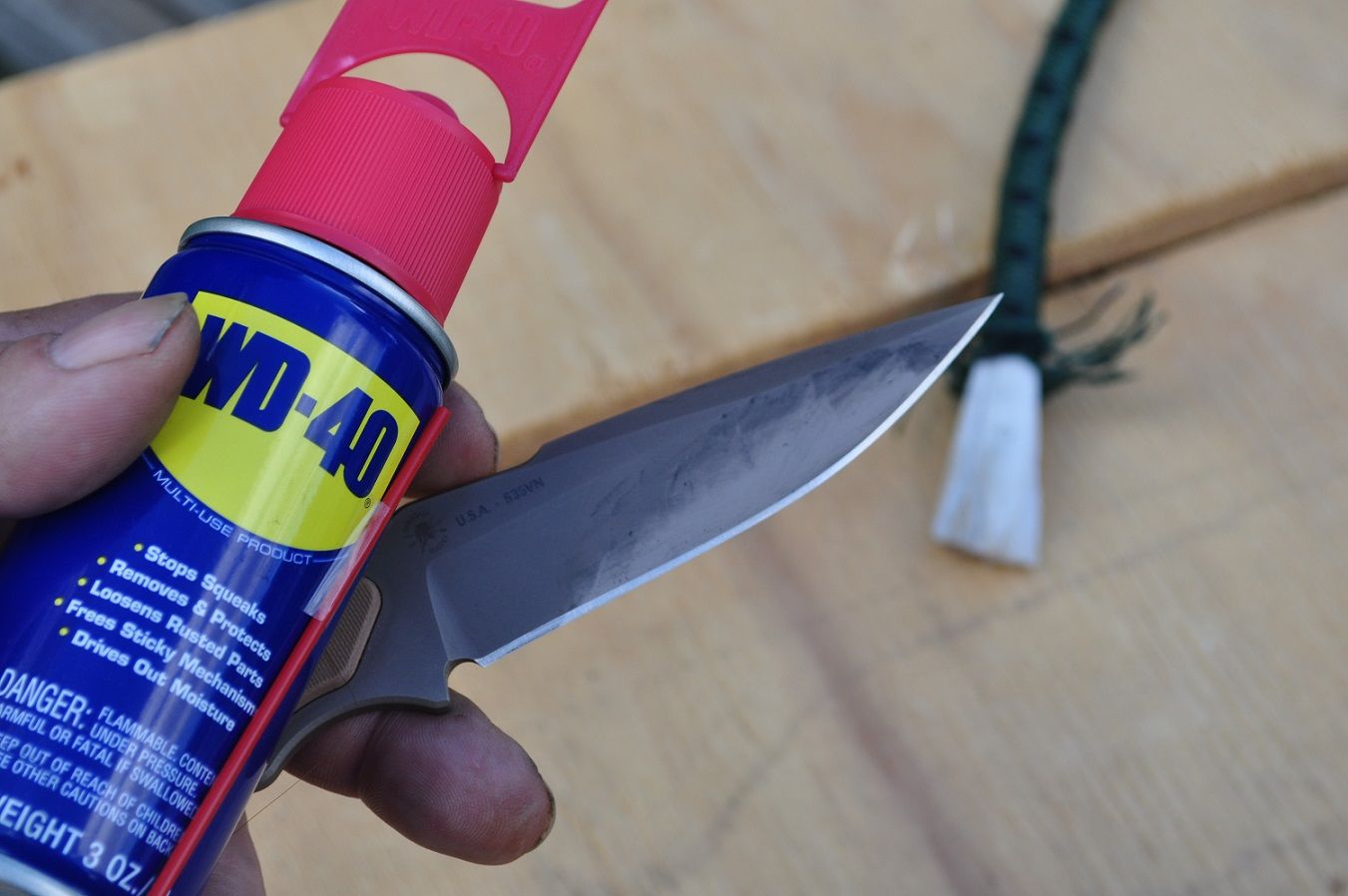

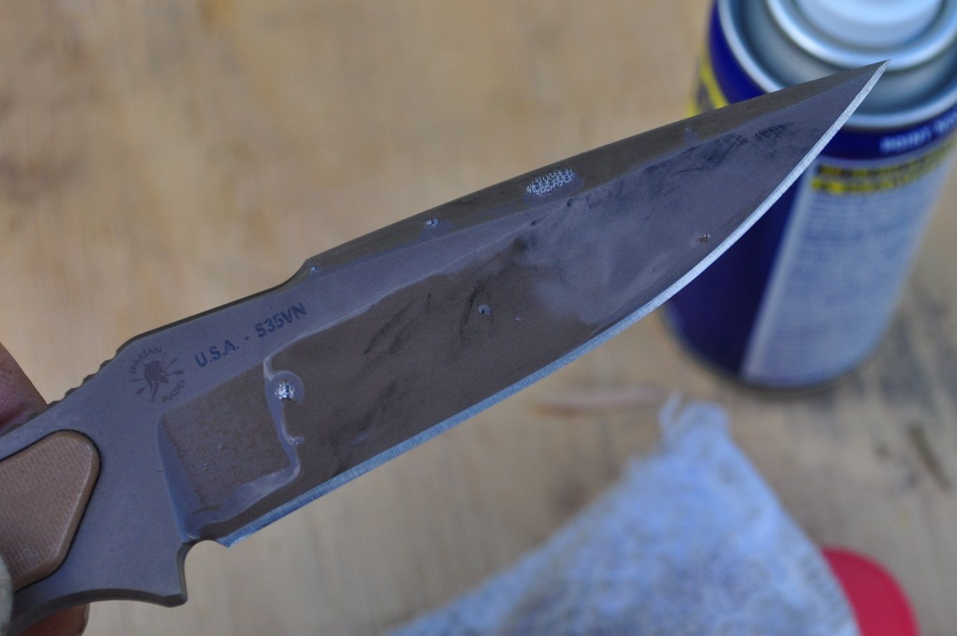

As for the WD 40 cleaning method, it is quick and easy :)

The sheaths are among the best thought out I have seen. The hard inserts are lined with a fuzzy cloth material for noise discipline and there is some friction. Not an extreme amount, but no rattle at all.

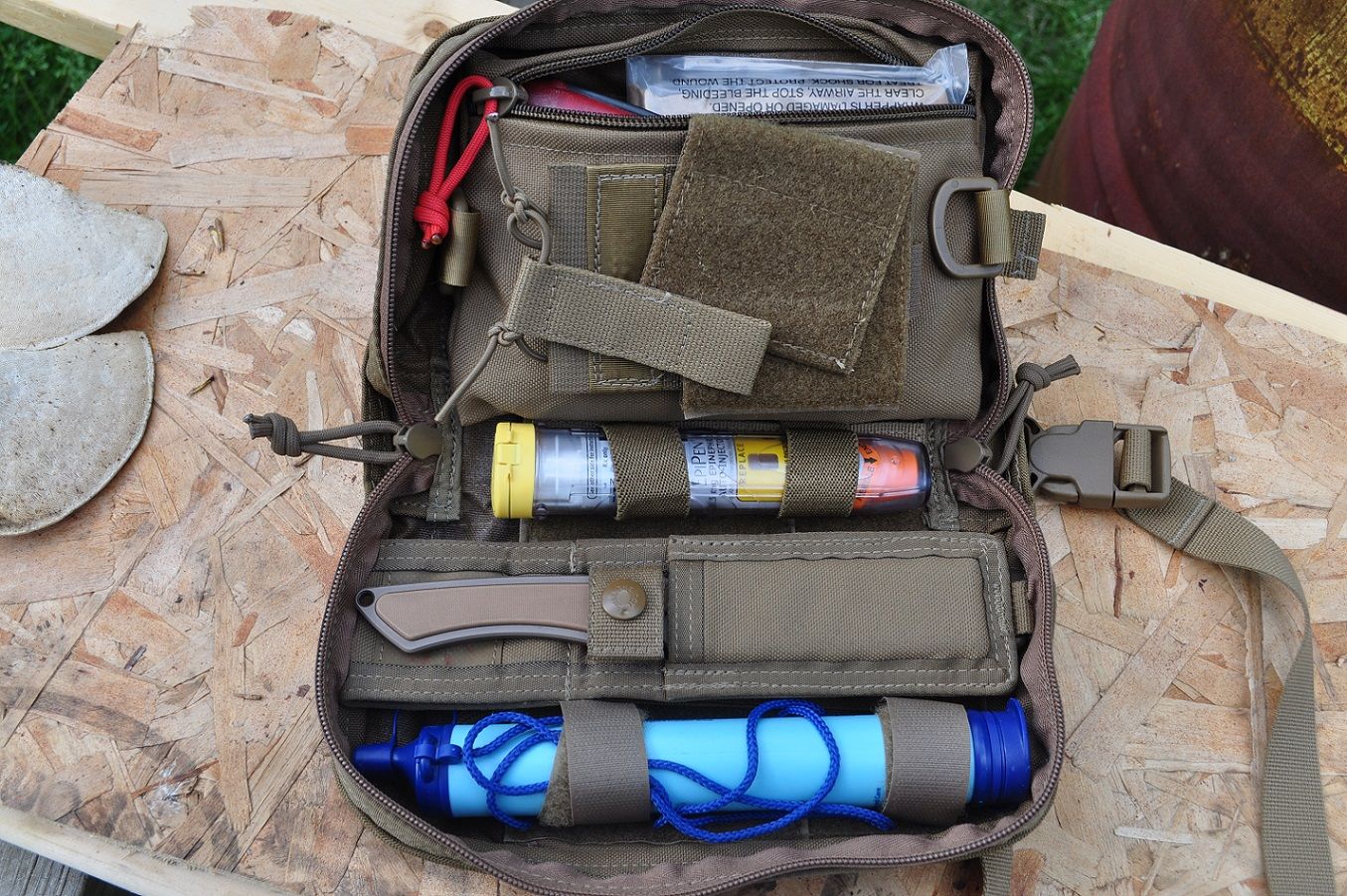

If I may ask, what bag was that you had there? Have you been up to any more urban skills or experiments lately?
That would be the Steadfast E&E pack by Cooper Expedition Gear. Really nice small pack that serves me well in the field.

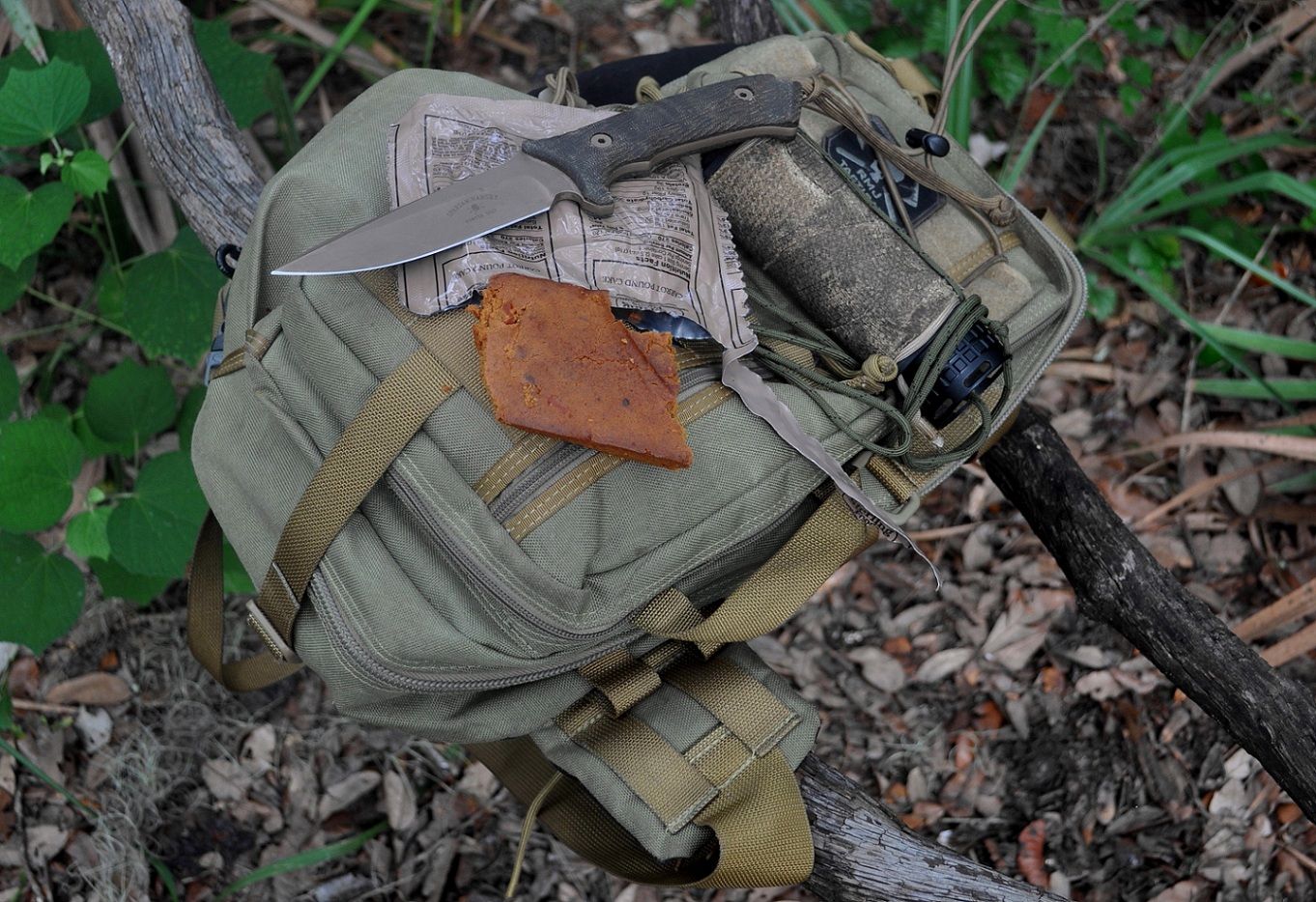

Funny you asked that. Mainly I had been really digging being back out in the country, and only occasionally venturing to the very edges of some of the larger cities here. I've really been enjoying being out away from the urban sprawl and nuclear power plants. Then recently I started on a project that has me working some in the larger cities looking into aspects like economics and infrastructure, so once again urban survival is a subject in the front of my mind. I have been taking a lot of photos for my own personal use, so a thread on that is in the future :)
