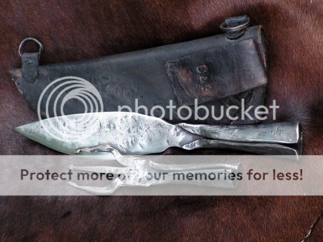

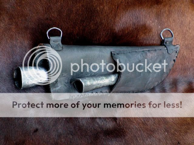

I made this set for a fellow who wanted a socket handled spear shaped knife sharpened on one side and a frog gig that all fit in a sheath that he could hang on his belt or tie on his pack.
Spear is 11″ long, it and Gig are both from plow material. Sheath is veg-tanned scraps dyed w/ vinegaroon. Rings are from wrought iron nails. Haven’t heard from him so this set goes in the drawer for awhile……….Randy

Does vinegroon-dyed leather ever damage the steel it touches (due to the vinegar)?
No, Hesparus, you neutralist the vinegar after dying with baking soda water or just rinsing it good. If you do not oil it gets pretty stiff. I like the stiffer leather so I varnish or wax after it drys.....Randy
