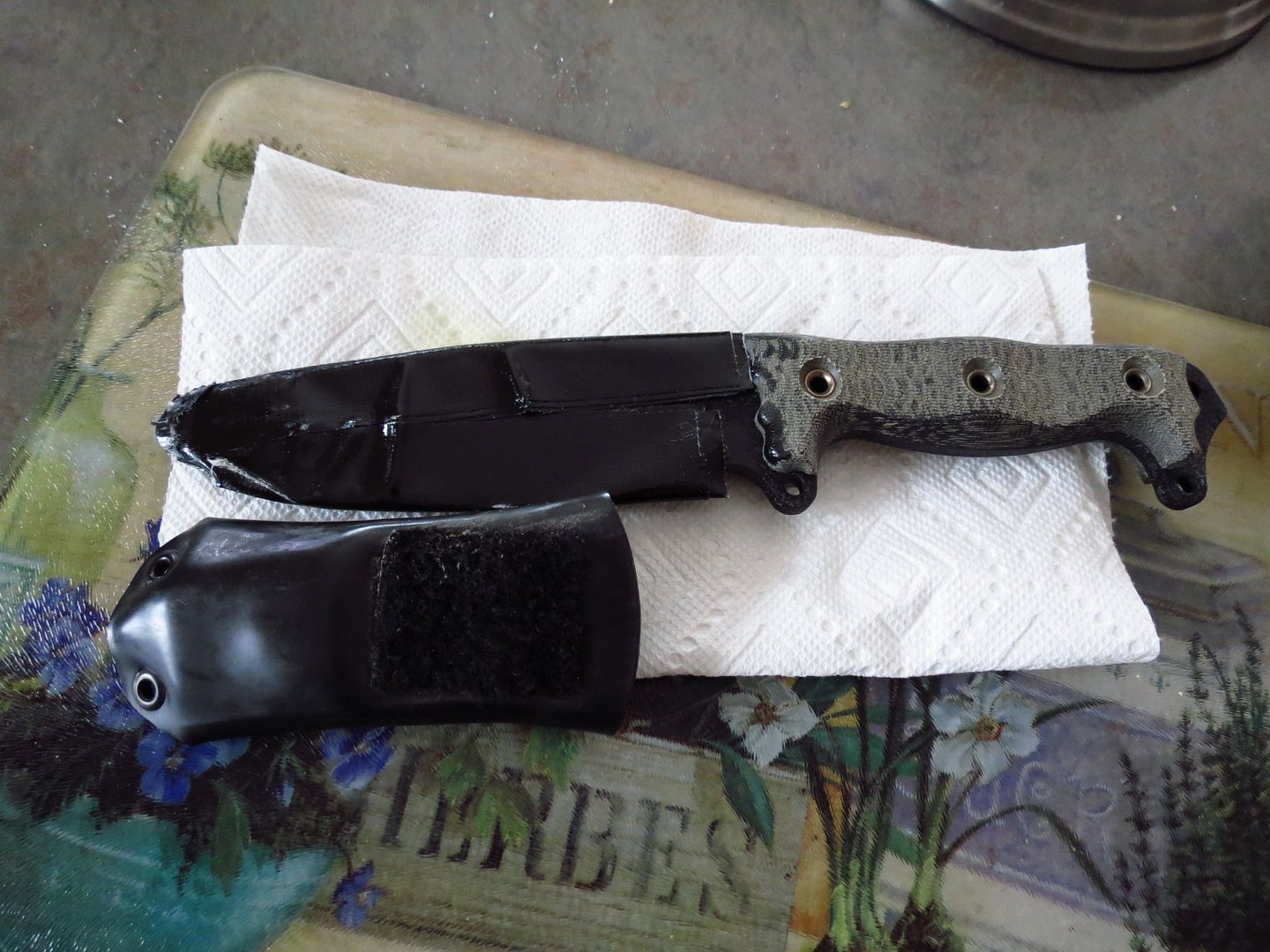

Having just received it this morning, I immediately went to forming the liner of a 6" Spec Ops Combat Master to fit it. I couldn't get a good enough mold with boiling water, so I followed one of the numerous tutorials here on the forum.
They recommended placing the liner in the oven at 375-400 degrees Fahrenheit for 5-7 minutes.
Before doing this, I added three layers of duct tape to both the edge and spine side of my BG ASH-1, and lubed it up with some olive oil.

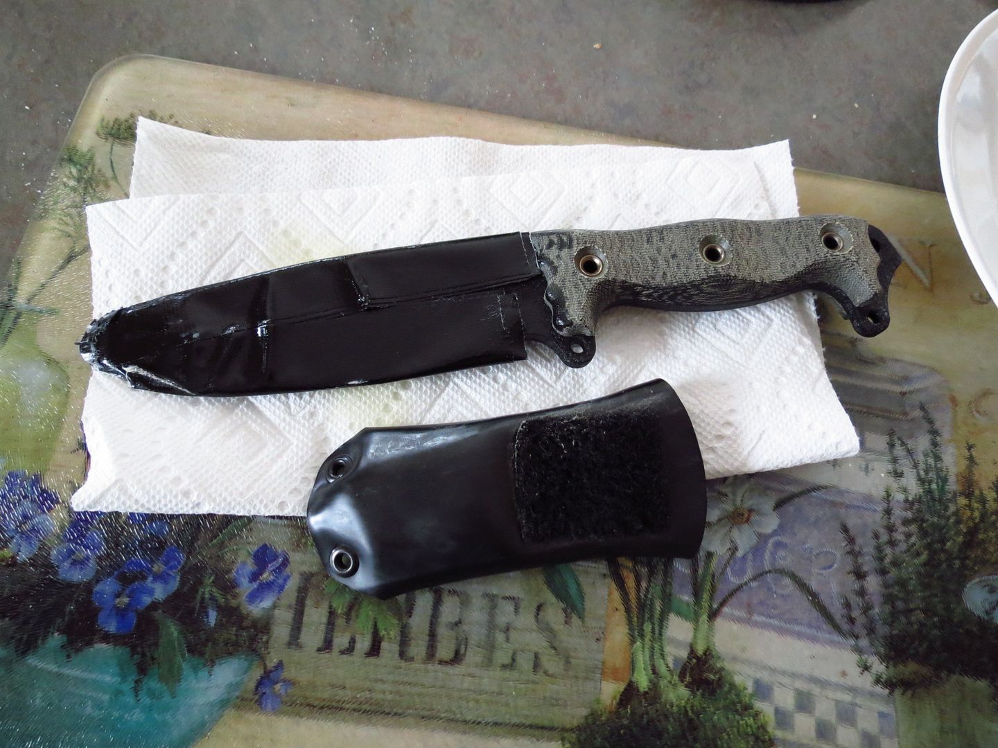

I placed the liner in the oven which was at 350 degrees, and set a timer for 3 minutes. I checked on it a few seconds before the timer was about to go off and was met with a rather shocking sight.
A shrunk, deformed liner. I tried to insert the blade and pull the liner back to its former length, but it was all for naught.
I now have a Spec Ops Combat Master without a liner, and an ASH-1 without a sheath.
Spec Ops claims their liners are made from actual Kydex, but of all the Kydex I've ever worked with, none of it ever acted like this stuff did.
As you can see, it shrunk quite a bit (close to 2").

Before I ever tried working with Kydex I did a lot of research. There's a lot of information out there but straight from the company they mention that a slower heating cycle will yield less shrink and better definition. I place my Kydex on the tray in a cold oven and then turn it on rather than placing it into a preheated oven which could both heat it too fast and heat it too much .
It's also a good idea to get a laser thermometer, again the manufacturer will recommend the ideal working temperature based on the thickness of your Kydex.

Maybe it's just me, but 350* seems way too much for the specops liner which as far as I can tell is closer to smooth inside & outside heat shrink tubing than kydex.
You might be able to find something similar to replace it with at an electrical supply store or get a kydex liner from one of the kydex guys.
For what it's worth, I do mine with my oven at around 200* and have not had the issue after my first one started to shrink at about 275* years ago.
Even molded kydex starts to demold into a loose pouch for me at about 200* when I have tried to repurpose a sheath.

I've had kydex sheets heated over 330° F and they shrink from 8 by 12 to 6 by 10.... I don't go over 315°F

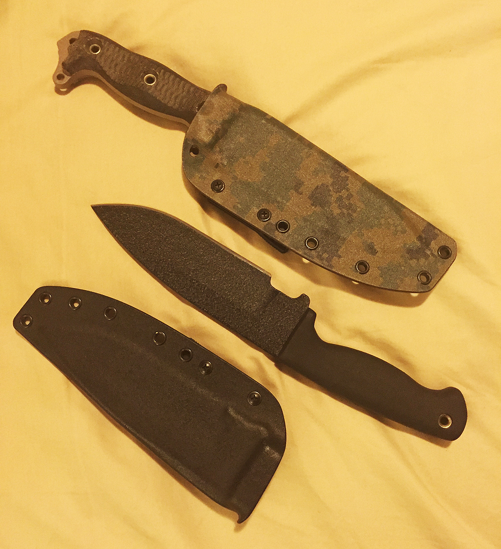

I need to buy myself a new pack and sleeping pad tomorrow, but if I have some play money left, I'll be in contact. I will certainly be needing a sheath, be it a kydex liner for the Spec Ops, a full kydex sheath, or both.
