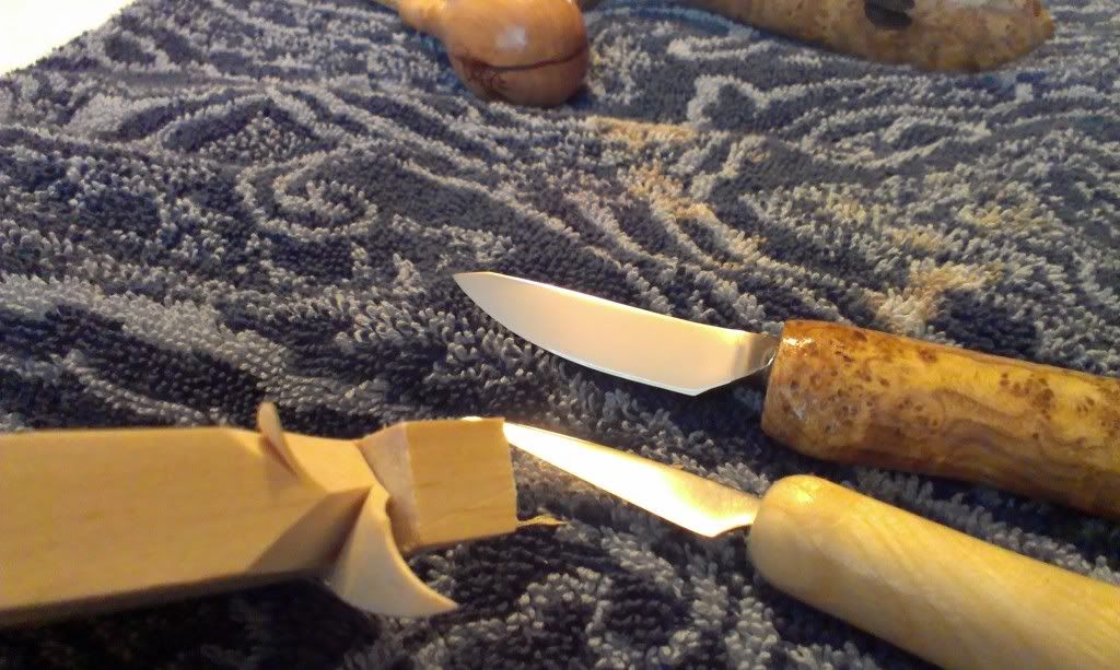

Hey guys, I want to make some wood carving knives for me and my friends. The blades will be anywhere from 3/4-1 1/2" with stick tangs roughly 1" long.
I'll be using 1084 and doing everything myself.
There is plenty of HT info, but is there anything I should consider when doing such small blades? The stock (when I find some) will be (or end up) thin and short in height.
Here's a pic of a couple of knives that have profiles similar to what I'll be doing.
Thanks!
You will be better to use W2, 1095, or 52100. Higher hardness with a very fine grain being a major gain.
The HT is the same, with attention not to overheat the blades. However, about 25°F above the target for a larger blade would be a good idea. The time between the oven/forge and the quench tank is critical...with the time being very short. A blade that small will loose its heat rapidly.
