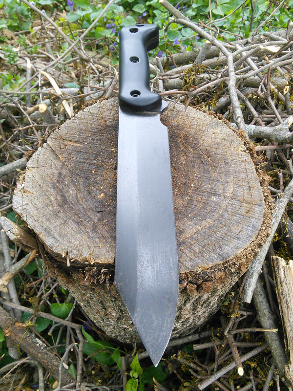

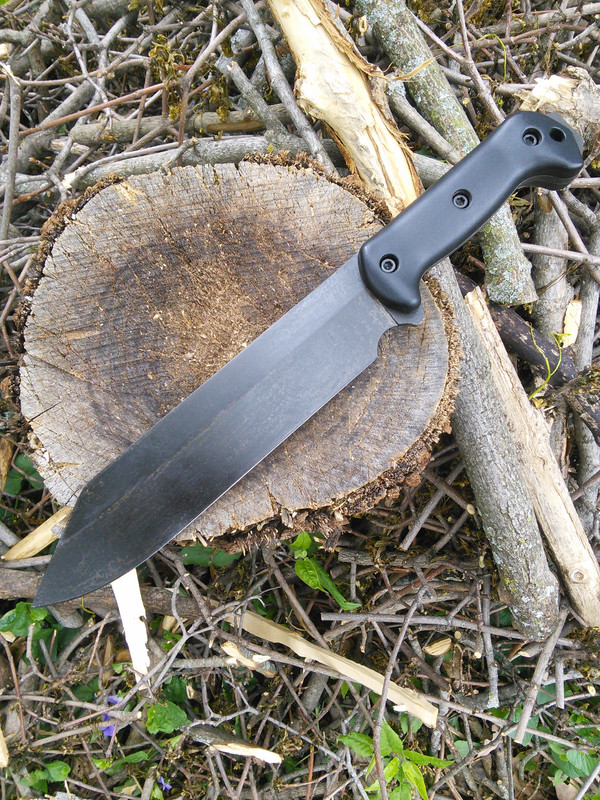

Just saw this last night - Here is a link to one thread from a while back when I did the vinegar method.
Also this one where I did the TGSE A2

Do these processes hold up to Use, like some battoning, or just to look pretty in a safe?
*Not meant to sound snarky, serious question..... I've done some old school style kinds of blueing that I've been pretty happy with.
I might practice on my 1311 which is the same steel as the TNT
The Batac I have used quite a bit and it's held up beyond my initial expectations which really weren't that high. I haven't put oil on it since it was finished and still looks pretty much the same as the photos. the TG, I've wacked a couple branches trimming limbs that hang down and annoy me while mowing - and same deal, pretty much as you see it.
I would imagine battoning would be a really good test to see how it would hold up but haven't done it.

Glad I read back through those threads. There's a couple small points in there that can make a mess of the job such as heating the blade up to remove ALL moisture from the steel. It's not a job you want to do in high humidity. That part reminded me of how much reading and science I went through to get where I did.
The one thing that can be an issue is heating a big stew pot up on the stove just to boiling of vinegar - Wife was out of town a few days so it didn't bother me. Actually, it's no worse than when the wife runs vinegar through the coffee pot to "clean" it.

I actually just microwaved some in a mug and ladeled over the blade on a large plate and let it sit switching sides each go, re microwaving it in the mug between washings and it worked just as good as a full on soak
