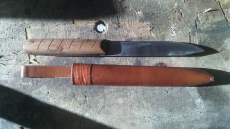

After admiring all the knives on the board and interweb I went back with a ruler to measure my old knives thicknesses. None of my knives I had growing up were more than 3mm or 1/8 inch thick. Also the 3 knives I have made my self measure 3mm or less. Now this begs a question.What is to be gained by a knife 6 inches or under to be made of more than 1/8 inch steel. I have never broken a blade but also I do not baton wood with a knife so maybe ive answered my own question
Hacksaw blade knife. First knife I ever made as a kid. Very thin and flexible
good question that I'm interested in seeing people's opinions of. I've never made any really thick blades 5/32 is as thick as I've gone but I've also never made anything very large either. I see 3" blades made from thick steel and it just seems like clunky overkill to me. My personal preference is slim and sleek so that's how I like to make them.
