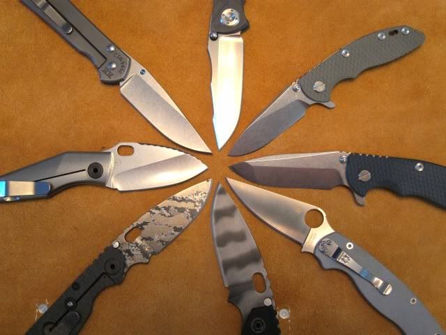

Yes but looking at most all modern knives, folders in particular, I usually have an almost uncontrollable urge to grind the spine / blade (including the behind the edge thickness come to think of it now ) to half of what the blade is from the maker.
Spine from 5mm down to 2.2mm or 1.9mm ( I did that to those dimensions on some knives)
and behind the edge from 22 or 20 thousandths down to a more useful 10 thou or so.
but what is a person to do ? Without getting a custom we are stuck with these idiot proof knife shaped objects.

Here is a couple old photos I whip out for these sorts of discussions.
As far as cutting meat . . . meat is squishy stuff that easily conforms to the shape of the blade / edge. No reason fatness shouldn't cut squishy stuff with little effort.
It is when one gets into firmer stuff, think carrots, that the thin blade and edge shines.
Of course if one has lots of horse power I suppose one can drive about anything through about any material.
What I enjoy in edge tools (fine knives in particular) is the relatively effortlessness that a superior edge tool displays.
