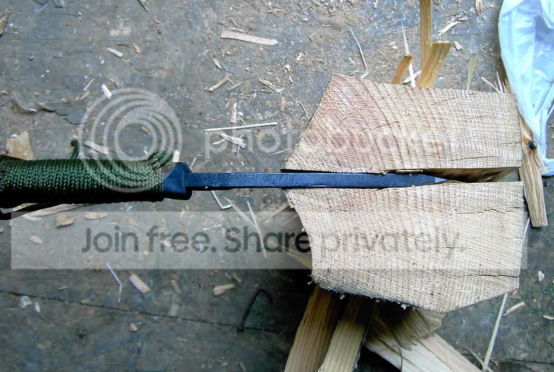

Splitting 6"+ wood with a 5" blade !!!
Apr 13, 2007
12,294
Many people often say that the size of wood you can split is governed by the size of blade you have !
This is not true and this is how I get round the problem without bothering with wedges etc.
This is our problem....
So I just start to batton about half way into the wood( can you believe it split on the other side, when I want it to it never does !)...

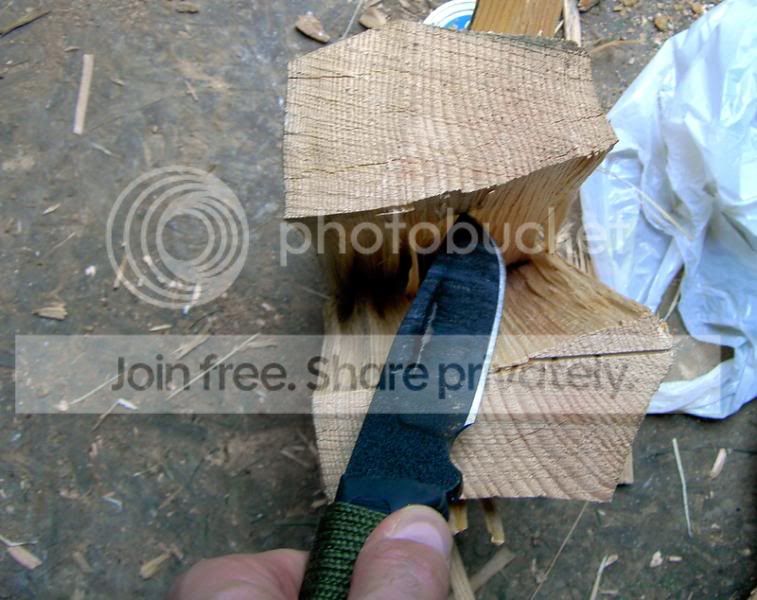

I then tapped my knife back out and did the same from the other side...
With the knife removed again it's just a case of prying the two halfs apart....
With it now in a more managable size it is only a matter of minutes before you have your bundle of kindling !!!

Splitting a 6" with a 5" or even 4" can be done in a different way, without prying.
Start splitting from the outside in. You already had a square piece of wood, so baton off the "corners" and repeat until you have a small piece in the middle.
Instead of parting 1 to 1/2 to 1/4 to 1/8 etc. you take out a 1/16, then another 1/16 from the outside in.
