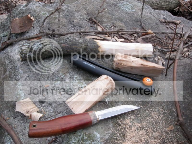

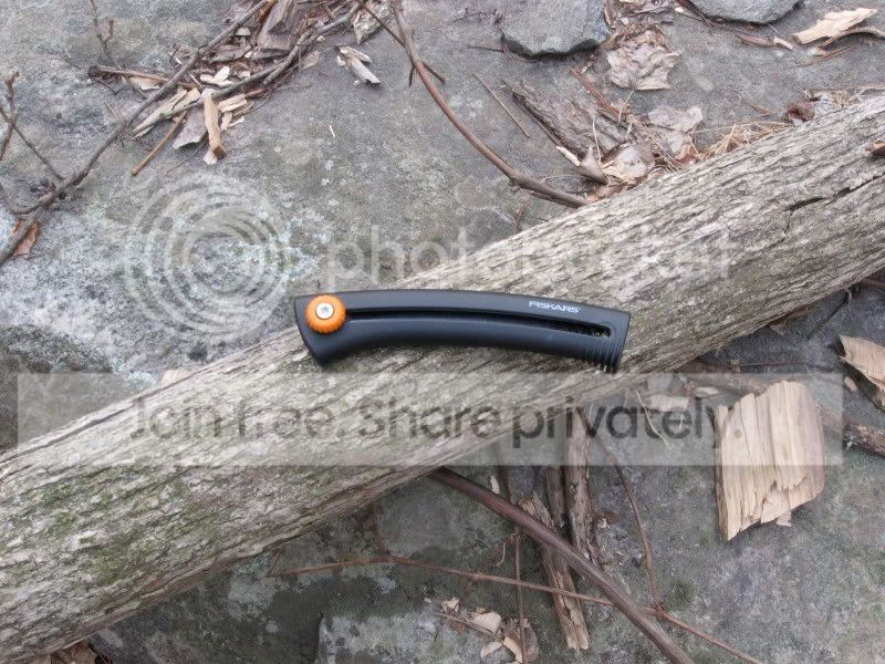

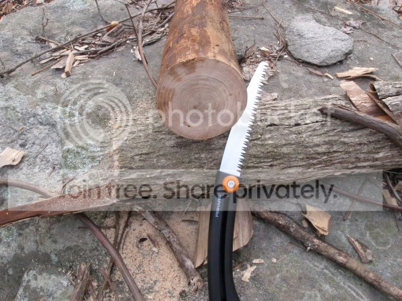

I took my fairly common dayhiking setup out in the yard with me: Fiskars slide saw, Puukko style fixed blade.
I decided that I was simulating needing to gather some firewood, and for some reason needed to split it.

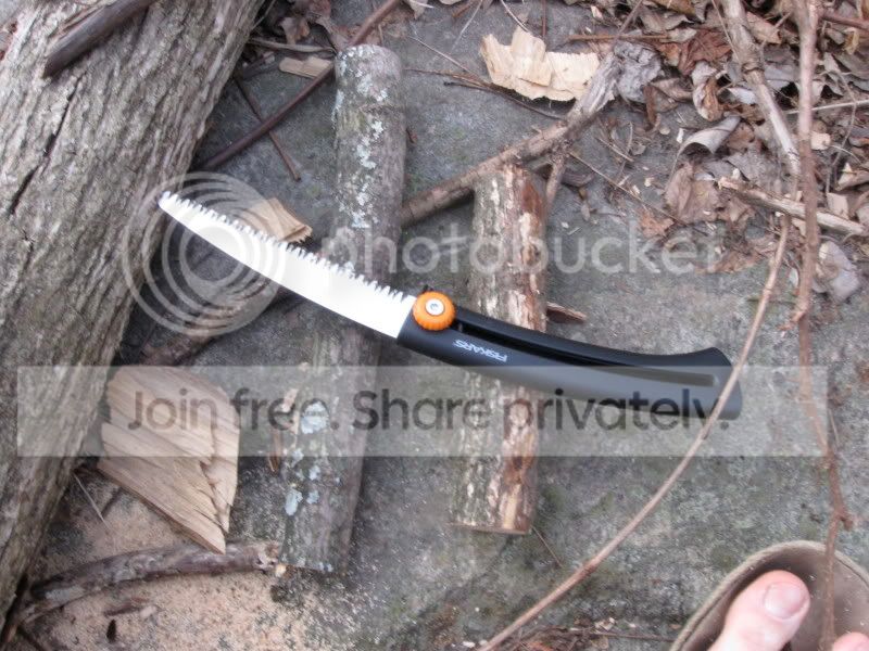

First I cut a piece of a hickory log that was suspended off the ground, but still damp on the outside. The piece was about 4.5" diameter, about maximum capacity for this saw.

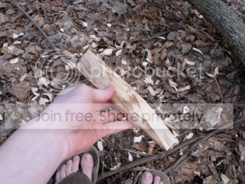

Once the piece was cut, I then went and found a stick of hard, dry hickory that was convenient, and cut off about a 10" piece, maybe 1-1.5" diameter. I also fetched a baton to use.

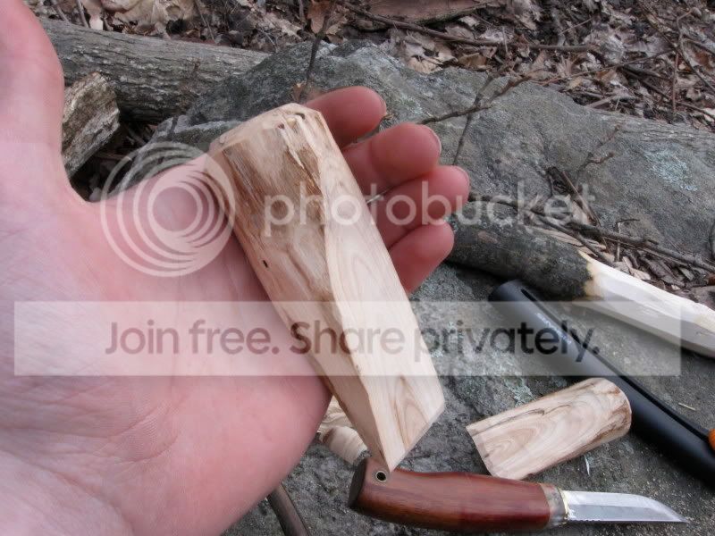

Whittled a couple of wedge-shape edges on the end, nicely tapered. Aim for flat or slightly convex sides. Make the front edge fairly thin, maybe 1/16" wide, and apply a small bevel at the edge.
Using the saw, I cut the wedges off. I chamfered the edges to help prevent splitting.

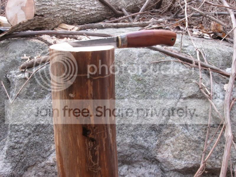

Pound the knife into the end of the log, starting a split. Make the starting split go all the way across the top. You don't need to go real deep, I only went to about the spine of the knife, less than an inch.

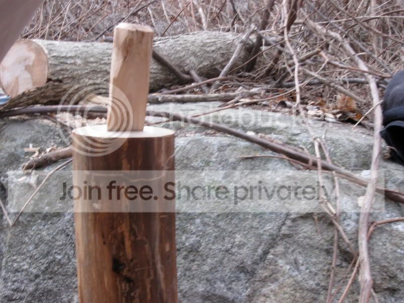

Set the knife aside and set a wedge into the split. Pound away! :D Beat it in until the split opens up enough to fit a wedge in on the side of the log. Insert the wedge and pound that until it goes no further. Move the first wedge (should be loose or have fallen out by this point) farther down the split, and pound in. Lather, rinse and repeat until the log is split.

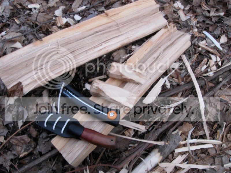

Once the wood is split up this way, you can simply straight baton the pieces down into kindling or other smaller pieces. :thumbup:

I wonder if the log could be as easily split if the saw were used to cut a slit in the top for the wedge to fit into. Some people prefer not to baton at all, even to start a split (I'm not one of them ,though ;))
rather than using the knife to make the initial cut, you could use the saw. seems like it might be easier that way. all in all, good demonstration and pics.
this saw in particular is decent at rip-sawing (most saws with this teeth style are) but I personally find it simpler and eaier to swing the baton a couple of times instead of doing more sawing...
the biggest issue with a saw notch is that the bottom is flat and doesn't keep running down the log like a knife split (which is what makes it great for other applications). you would have to make it deep enough so that your wedge could pry the wood apart before it hit the bottom of the notch (not necessarily difficult to do).
