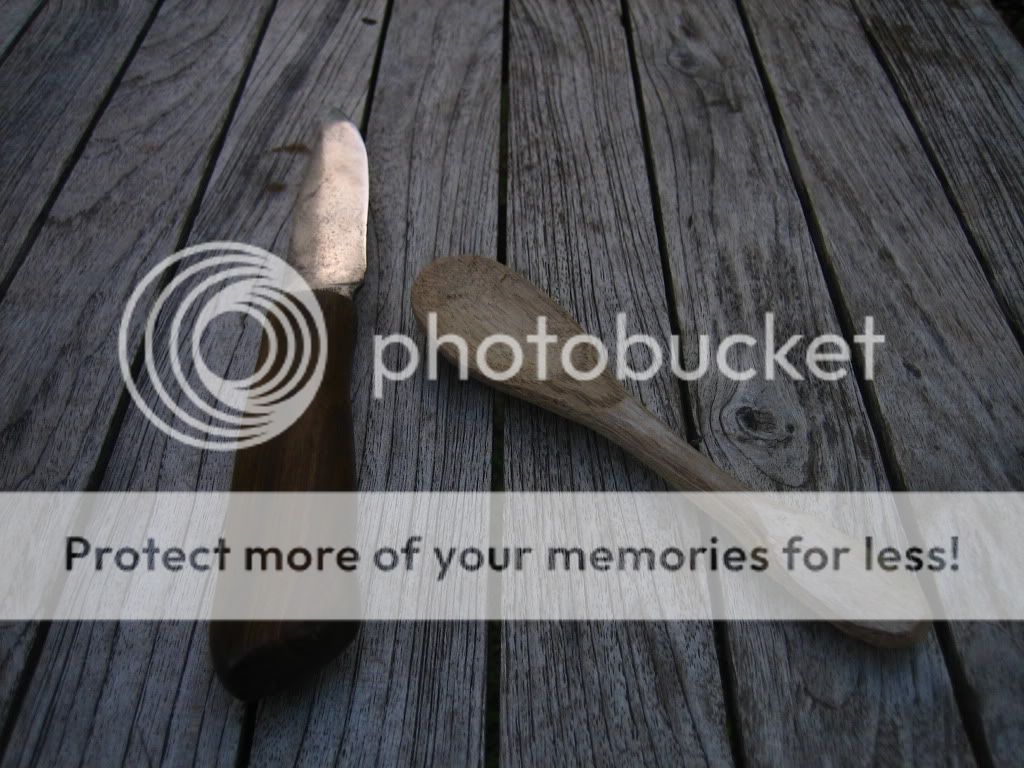

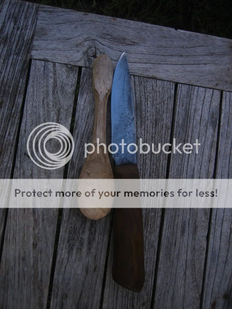

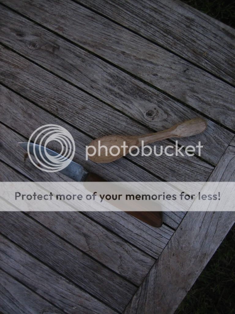

I also found CS's Trail master in San Mai 3 a little too brittle. It does work good for skinning game i've found.
thats a nice one mokes, i'll be joining you on that beer now !!
Thanks, lol! My wife wants me to sand it up and use it. I'm not sure if I can use an Ash spoon though. Maybe I need to seal it somehow? I actually think carving wood and woodworking in general would be a good hobby. I should try another spoon with my Buck 110.

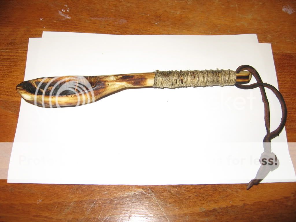

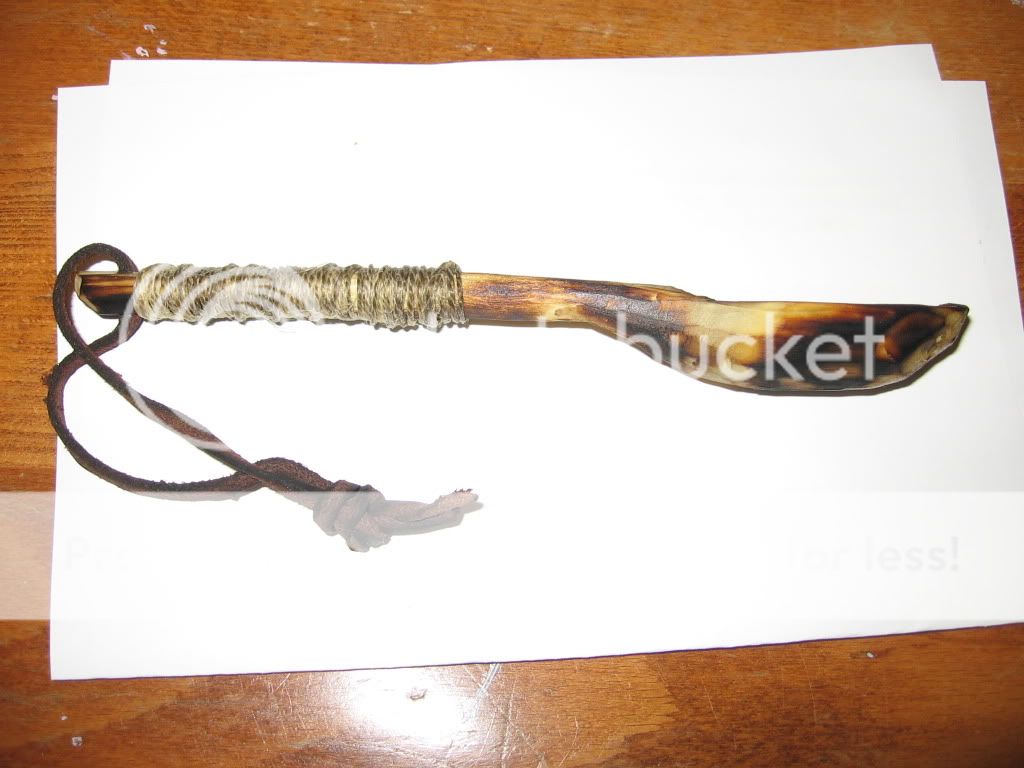

I made this only with a red handled more knife...i soaked it in olive oil, then burned the outside with a torch , then wrapped the handle in hemp and added the leather lanyard...
