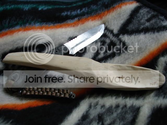

I'm having all sorts of trouble on this damned spoon :thumbdn:
Is there a finese to carving these things, or do I just suck? Granted the wood I'm using is hard as iron. Should I be starting on something nice and soft like pine or basswood? I have... erm. I guess something that resembles a spoon-ish like thing. It has a wee little bowl to it. I can't dig any deeper than about 1/2".
Now I make a mean handle. Curvy, nice and thin, a beauty for sure. It's just the bowl part that is giving me troubles. I have to push so damned hard that I refuse to do pull cuts for fear of ramming my bent knife through my stomach. Is it just the choice of wood? Is there a secret to keeping the wood soft? Soaking it in water or something maybe?
If I can't figure this out then I'm going into business making one of a kind hand made spatulas :D
Thanks!
keeping the wood wet while carving (i have read soaking it in water with a bit of bleach to keep away the mold) will make your life easier.
you should be starting with a softer wood though...pine or basswood would be good just to get used to the motion of the knife, or even some green birch or something.
another thing is that your knife may be dull...is it a mora crook knife or a different company/maker? i think i read somewhere that the mora crooked knives tend to come a bit dull and need some honing...

I think I'll pick up a hunk of pine or something and try again. I have no idea what wood I'm using but it has to be hickory or something. I'm telling you it's like concrete. I have the world's first tactical spoon going here. Bring on that Mors knife test where you see if it can support your weight. I guarantee this spoon can pass it :)
Ohhhh it starts.;) I'll try and help a little.
  1. Use green wood when possible. Dry wood soaked in water dosen't really work. Once it's dry the cells collapse and soaking it will only help to a point. Iv'e tried it :(
  2. If your using dry wood, go with a soft one. Basswood is great for beginners. Also... butternut, and Tupelo are good ones. A local wood supplier might be able to set you in the right direction.
  3. Buy a blank. If you go to www.pinewoodforge.com Del sells all kinds of spoon blanks. Good place to start.
Don't get to frustrated. It takes time. Green wood will be like carving a butter stick compared to what you're hacking at now. And Basswood will be like a bar of soap.
Get some proper wood and you'll be surprised at what you can do. :thumbup:
Edited to add: since you hang out here in W&S I'll assume you have a sharp knife to carve with. ;)

Here's what I have so far on the first spoon. It's very rough:
I don't think it looks bad at all. You hacked it out of what looks like some very dry, seasoned, dense grained wood. That would be hard for anyone.
In the pic below the top spoon was carved out of dry as a bone white pine, the middle was carved out of green spruce (lots of knots) and the bottom spoon was carved out of dry Butternut. The Spruce was by far the easiest to work, but all carved well.
Keep at it with some proper wood. You'll be pleasantly surprised.:thumbup: Also, if you have a sharp SAK, give it a try as well. They are great carvers.
