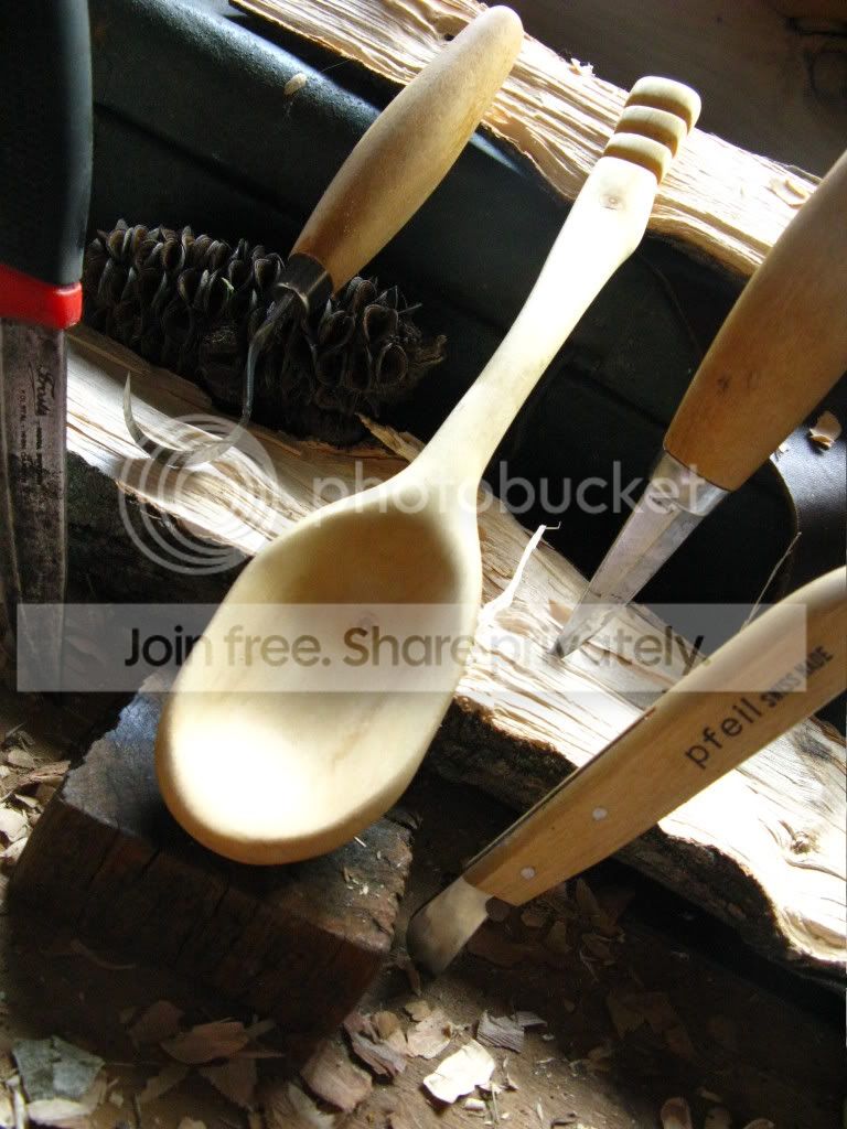

Combination chopping board / long dish..
Egg scraper/stirrer...
Both of these and others carved with the GB mini...

Awesome guys! Those spoons are beauties...they make my spoon look like chewed cud :D Qrt, did you sand your spoons down to get them that smooth?

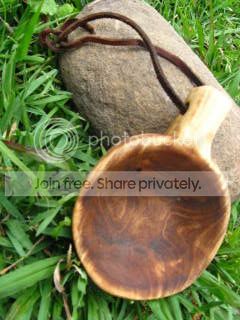

Marcelo, how did you and TonyM get your bowls so nice and wide?
And +1 on TF's question. I'd like to know too. :thumbup:
With those curved carving knives one can make the bowl as wide as the piece that one is carving. Tony got the tight and the more open hooks. I prefered the more open hook. There is a bit of a learning curve to using them.

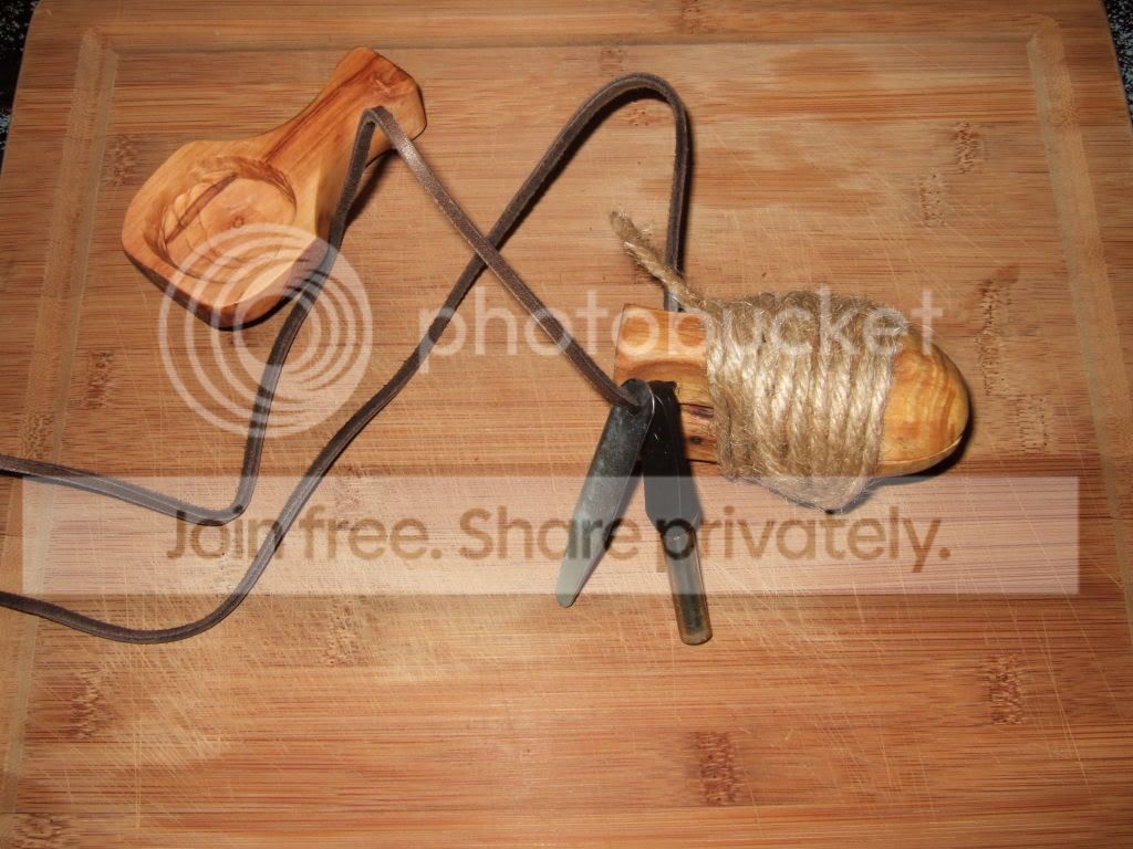

Mneedham, those neck spoon pendants are nicely carved. Love the color too :thumbup: Is that part of a fire kit?
Good to know, thanks! :thumbup:
Yeah, I was fooling around when we were doing KGD's fire project. I made it for my son...

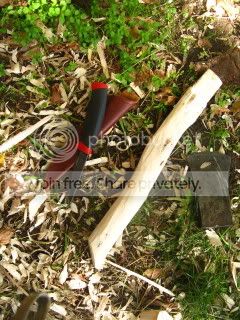

Sorry to bump, just wanted to put some pics up of the progress i've made on the spoon. Still no bowl carving knife here, so I've been continuing to work on it with the F1 and Izula. I love working with the Izula, great tip strength, keeps an edge well, and small enough to manipulate the tip and edge with really fine control. Love that little knife.
Thinned out the shape a bit, widened the bowl a bit, and took some 100 grit paper to it; it's coming along :D Still need to work on widening and smoothing out the bowl further. Hard to do with only a knife, for me anyway. I apologize for the dark pics, no time to set up better lighting.
Feel free to post new stuff up :)
ETA: Forgot to mention that I started with a 1.75"x1.75"x10" piece of basswood.

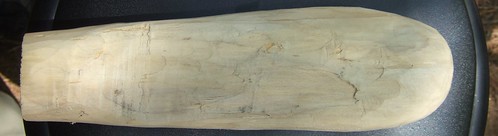

Here is a work in progress I started at PWYP. We had a, *ahem*, spooning session. It's like Fight Club, we just don't talk about it.
As for a size comparison, the stool it's sitting on top of is one of the folding stools you see in Wal-mart. It started out as one big chunk of wood and it's not come down in size very much length wise as you can see.
I chose to whittle my spoon instead of cutting it up in bits like I've seen others do. I just prefer to take my time. This is the first spoon I've ever attempted to make. Forgot to add, I'm using a Fallkniven F1 for carving currently. Joezilla was impressed by the amount of shavings I had taken off of it as he had used a big pile to help stoke a fire.
