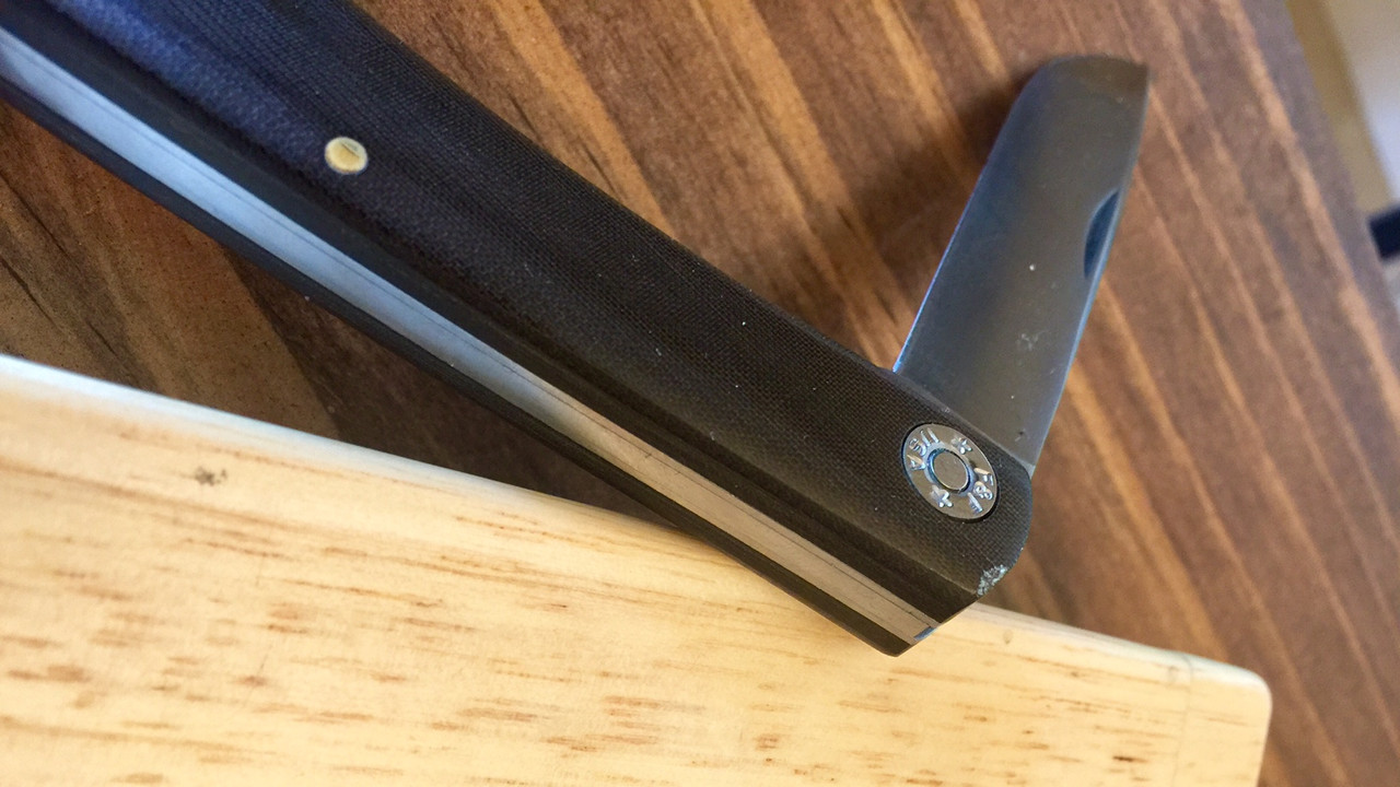

Spring position?
I think there are definitely some patterns where it is not possible to be flush at half stop.

Flush halfstops indicate an attention to detail that gives me confidence the maker / manufacturer also paid attention to detail in areas that I can't see, like heat treat. If a halfstop is too proud, it can make the knife more difficult to open / close. Flush halfstops can be engineered by factories, as mentioned Case swayback jacks are flush, GEC 15s are usually flush or close.
How does a proud half-stop make a knife more difficult to open or close?
Stretches the backspring further than it needs to, more tension. More noticeable on smaller knives with shorter backsprings.
