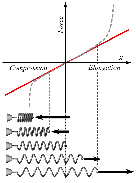

If a spring is properly tempered and the knife is properly designed so that the spring is not over-stressed, the spring should not "soften" if the knife is left open.
If the above conditions are met, the spring will be within its elastic response zone when the blade is in the partially opened position. Within that zone it will completely return to its original shape. Springs eventually fail due to fatigue, which is repeated stretching and returning to shape many thousands of times.
I borrowed this picture from Wiki. It depicts coil springs, but the graph applies to straight springs as well.
If the spring is properly tempered and stressed, the response will be on junction of the linear red line and the dotted line. It will be completely elastic and will not soften. If the spring is not tempered properly, or the knife is designed such that opening the knife deforms the spring too much, the spring will be outside that linear response and it can be permanently deformed.
https://en.wikipedia.org/wiki/Hooke's_law

Correct, as Knarfeng said. If the spring is not properly heat treated it will fail very quickly. That's when you still have RA, but that's also what happens when someone thinks to lighten the pull by overtempering...all you get it's "sagging", because you narrow the proportional range of stress-strain.
When a spring it's stiff the only correct thing to do it's grinding it thinner in the flexing portion.
As Frank said, the metal itself doesn't soften by keeping the blades open but the springs can deform.
Perhaps I did not word my post correctly. The force required to move the spring does not lessen, IF the spring is properly tempered and the deformation is within the linear response area. That is intended to mean that the metal does not soften, nor does the force needed to move it change.

If it's working well it is because of something wrong with the steel HT. Either (or both):
1) there is retained austenite and that structure is soft and will contribute to take a new set
2) The temper has been drawn too high and the yeld point (Knarfeng graph) is too low; exceeding it out of the proportional range leads to permanent deformation.
The problem is, when exceding the yeld point, your spring will continue to loose its shape eventually loosing the necessary preload to have a nice action.

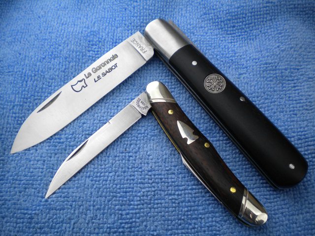

Yes as our esteemed moderator said. I have one of Le Sabots' nailbreakers shown below with a just about polar opposite Nortwoods Norfolk, i left the Le Garonnais at about two thirds open for a couple of weeks with no improvement, i am thinking about getting a sheath and using it as a fixed blade. ( no seriously i have put it in the "Not likely to be used again" ) coffee can.
