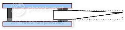

I find that in most "off centered" Spydies, it's not the pivot that's the problem. The primary grind of the blade tilts more on one side compared to the other, making things uneven.
Here's a really badly done and exasurated drawing of what I mean:
So in this case, even the most perfectly designed and manufactured pivot will look "uneven."
EDIT: In my case, we're talking about 1/50 inch of unevenness in a blade grind that's almost 3 inches long. I say that's pretty damned close to perfect.
