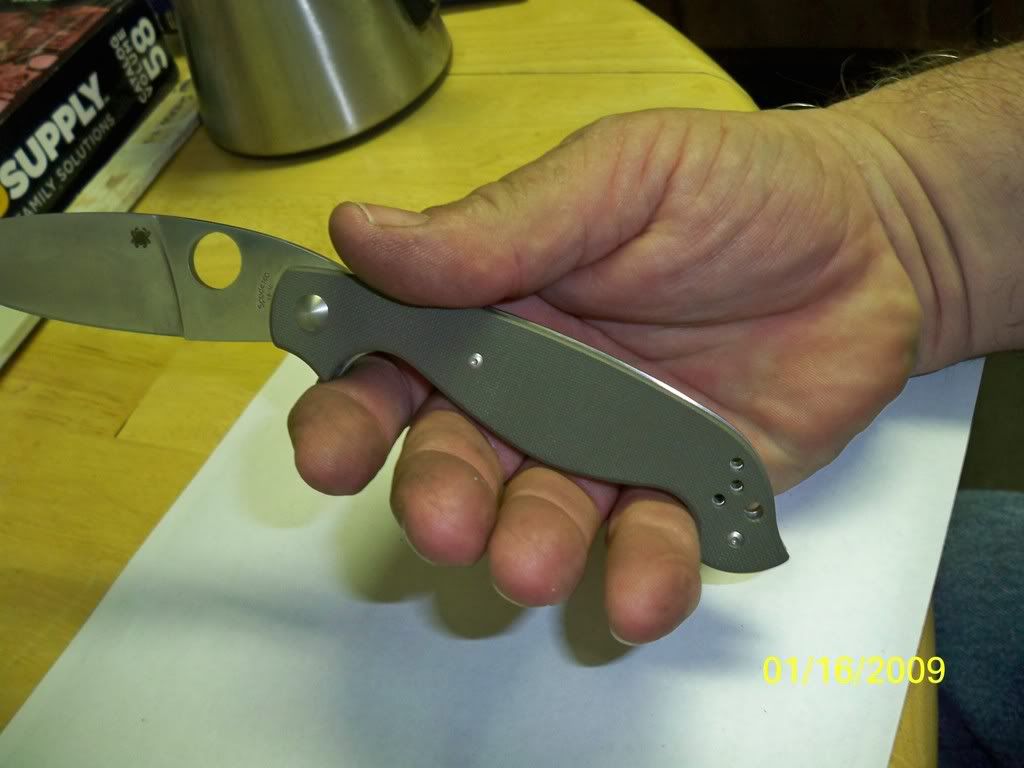

I was glad to see this passaround come along. I had seen pictures of the Barong, and I liked the shape of it. I didn't care much for the grind of the prototypes, and the slight angle of the production model is not much of an improvement, but in spite of that, I was willing to like the knife. After all, it wouldn't be the first knife to have the grind changed to suit me.
The first time I opened the knife, I saw why so much of the blade was left unsharpened.

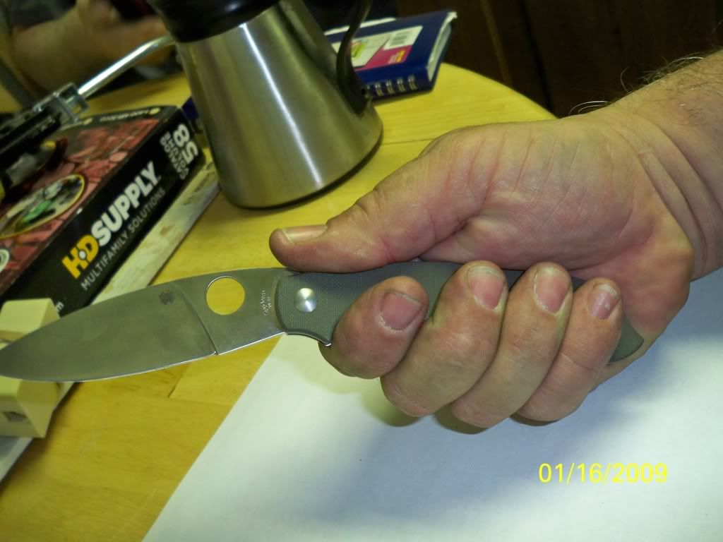

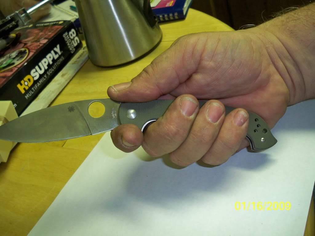

My index finger fell naturally onto the finger rest portion of the handle and overlapped onto the unsharpened portion of the blade, a grip that I like to have as an option, but which I find annoying as a primary grip. When I tried to correct that to what I would consider a normal grip, well...
My fingers felt crowded, and the grip felt very awkward. The area between the horns of the handle is simply too short for my hand, and puts the edge too far away from my hand to make me happy.

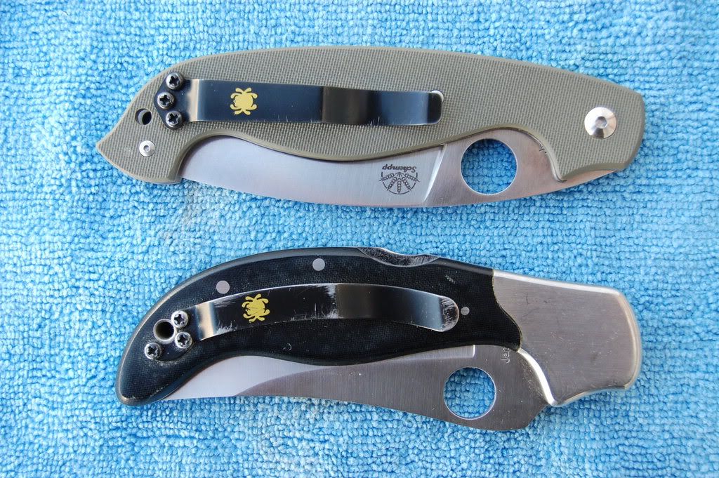

I have much the same problem with the Persian, another Schempp design with more than a little similarity in the handle.

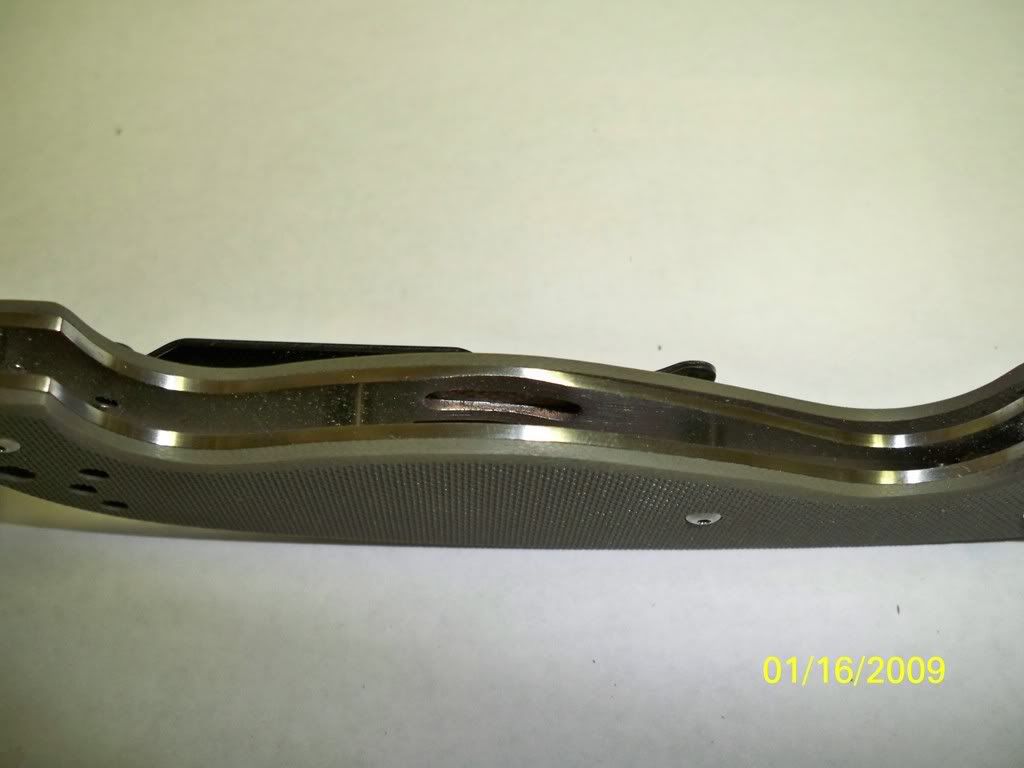

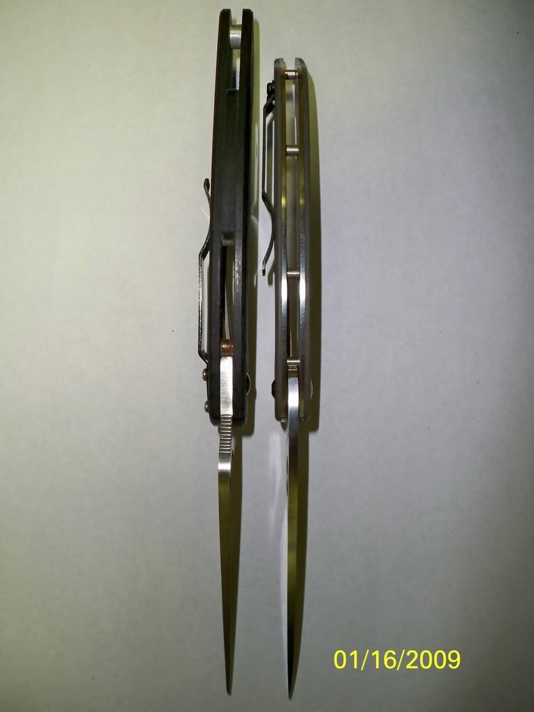

On the plus side, the fit and finish are excellent and the action is very smooth. Lock-up is positive and very solid, with no play that I could detect in any direction. The sound of the lock is a bit more subdued than the resounding clack of the CF Military. The locking leaf is even thicker than that of the Military, which should please those who think the liner must be thick for the lock to be good.
But compared to the Military, the stop pin looks a bit puny.
The small groove machined at the point where the rounded tang meets the stop pin did not fill me with confidence, either.
I don't really think it would happen, but it looks like the rounded tang would act like a cam and pop the stop pin out under a heavy load or hard impact. I don't condone chopping with any folder, and I'd avoid it even more with this one.
