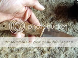

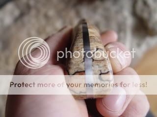

Anyway, regarding handle thickness on the Spyderco, not sure if this has been posted so will do so again...

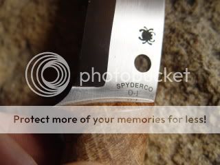

I am dead envious! The ones I have don't come with the blade markings and that little bug makes all the difference!:D

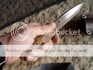

Hey! I can just see the "fugly" sheath in the edge of frame!

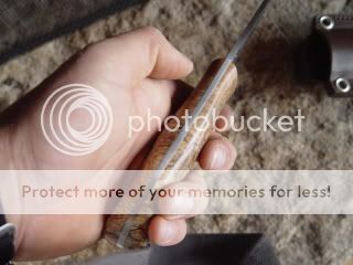

Joe- since you have been able to handle the spydie... have you had a chance to work in different grips with it? And have you used the BCNW? I am curious whether the thumb scallop on the BCNW actually makes the knife more comfortable in extended chest-lever sessions? And whether the swell at the blade end of the spydie makes the forehand grip a little more comfortable?

My only criticicism of the Bushcraft NW is from the pics it appears to taper at the front too much.
When I cut something seems like the first inch or so of the handle exerts the most backward force on my palm. The wider that can be without compromising the manueverabiltiy of it the better.
That has been my problem with a lot of bark rivers, actually. I haven't had this issue with the BCNW, it makes a good pocket for tucking your thumb into without digging into the web of your hand. But that's me.
