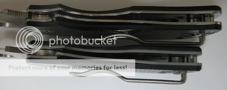

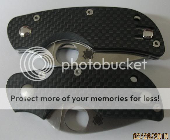

Here's my Cat with some polishing up: (along with my stock Chicago for comparison)
I'm sure it's personal preference, but I really like the polished look better.

I did leave the visible part of the blade alone, since this knife is a user. Also, heat treated s30v is hard to polish. :) I really would hate to lose the Spydie logo. I did smooth out the area around the pivot to improve the opening.

Nice job! That does look really nice, particularly the scales.

I think the first question to for me. Yes, I disassembled the knife to do the polishing. Like all linerlock folders, it's very easy to take apart and put back together. There's a good amount of gunk left over from the factory so it's a good chance to really clean it out. The only things to be careful about are to heat the screws to loosen the threadlock compound (or risk stripping the screws) and to make sure you tighten the screws while making sure the blade is centered.
