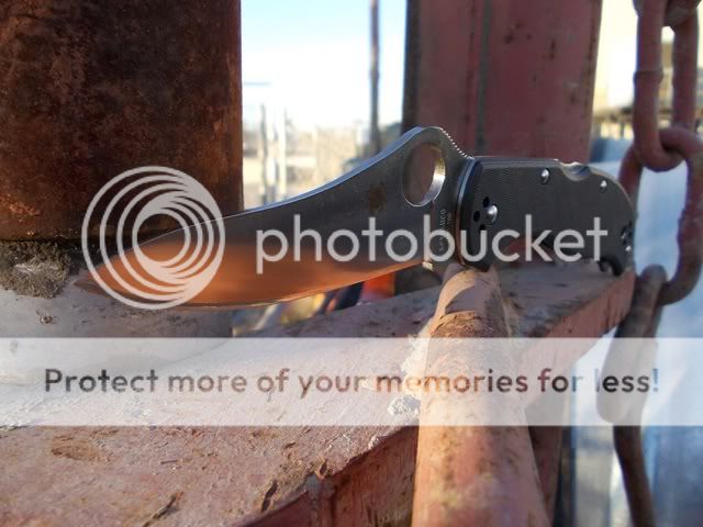

I received the knife with a good edge, but it did seem to bind in the pipes I sometimes cut.
Relief edge was applied at around 10degrees per side and I left a micro bevel of the previous edge. The knife's performance has increased significantly. At least, it feels that way.

I sharpened on a 600Grit Lansky diamond paddle, then used a Spyderco UF benchstone to polish the relief edge. The micro bevel remains a 600grit finish and only stropped to remove the burr if there is one.
No chipping issue at all.
I have a DMT D6FC 6-Inch Dia-Sharp Double-Sided Fine/Coarse Bench Stone on the way to do any future reprofiling/relief edges. I am currently away from home so I had to make due with what I have with me.

It is a type of high pressure hose pipe used for water cooling.
Here is a side view:
After the relief edge was applied on the knife I experienced it required considerable less force to pierce and cut through the pipe. Hand fatigue was also a lot less while cutting compared to the first cuts. Dont worry about the sound. I dont say much and all you hear throughout the video is the machinery running in the background. :)
