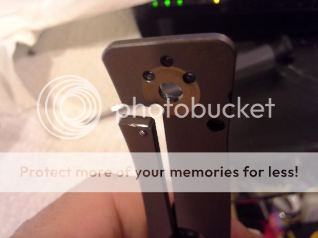

Hello...........My Chokwe has been smooth as silk since the day I have got it. I haven't used it much at all. It has seen very light duty. The hardest I have used it was a few days ago cutting through some thick, tough cardboard. I would say I used moderate pressure. Shortly after that the lock has been very sticky, and gritty feeling. (I don't know for sure if the cardboard is what caused it but it is the only thing I could think of that I used the knife for lately) Anyway it has been quite noticeable and annoying so I decided to break it down and have a look at the lock face and blade tang. (Anyone who feels the need at this point to tell me how I voided my warranty please save your energy. I break down all my knives to clean and lubricate them to my liking) Upon closer inspection I noticed some wear on the inside edge of the frame lock. I only have two other titanium frame locks so i am not sure if this would be considered normal wear. The other two have seen much harder use and have no signs of wear like this. Any constructive comments would be greatly appreciated. Thanks.[URL=http://s524.photobucket.com/user/slimman222/media/20140223_232637.jpg.html][/URL]

btw, my chokwe also has that "steel insert" (in your pic it's the shiny part of the lockface) and I do think Spyderco does that to their R.I.L titanium folders, as my Spyderco Techno (sold it long ago) also have that. it is normal, i think.

On the Chokwe it's simply a hardened lock face. As to if that's normal or not I can't answer that, my only Ti frame lock is a Sebenza and it isn't like that.

Yes have tried both the pencil trick and sharpie trick..even tried a small dab of grease I use on my firearms. I have only had this knife apart once when I first got it to clean it and lube it, and there was no sign of wear at that point. The lock was super smooth. It just starting developing this gritty, grinding feeling as of late.
I have both the Chokwe and the Techno..neither one of them have a steel insert. That shiny spot it where the titanium lock face has worn down. The Techno shows no signs of wear.

I never heard the Chokwe lock was hardened like the techno, and wished it was. Can someone with in for sure on that? Is the flat/shiny area in the op's pic definitely a hardened area or could it be wear?

I was carbidizing a while ago and had the Chokwe apart but the lock face looks hardened already so I left it alone. The OP's picture looks like there's some galling though. Maybe some tungsten carbide wouldn't hurt after all.

I've been keeping an eye on mine and it's not wearing much at all. Just a little shiny on the contact patch.
Tungsten carbide applied on the lock face of the softer titanium makes it more resistant to wear against the hardened steel blade.

Mine has the same wear. The pencil and sharpie are only temporary fixes to the "grabby" bar. My Techno doesn't do this.
