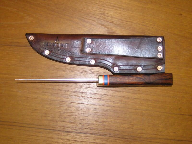

Do you have any pics of your 10V knife?
Funny you should ask... ;)
There's nothing wrong with the edge, those are artifacts from the digital camera...
Very nice, thanks for sharing. How do you find the corrosion resistance of 10V?
It's fine, but I live in dry Colorado, and haven't taken it hunting yet. So take that with a grain of salt. I store it (like all my other knives) in it's leather sheath, no problem.

Sodak, that's a beautiful 10V knife from Phil. Just what I want right there. I've heard it's noticeably more wear resistant than S90V. Will it take thinner edges due to the higher hardness? It should be a bit tougher too. Can you give your opinion?
10V actually doesn't have a higher carbide fraction that some other, less wear resistant steels. I know it has more of the evil, *"devil worshiping" vanadium type carbides though, so it more than makes up for it than some other steels. Thanks, Joe

Yes, the edges and primary grind are quite thin. I've never put it on my edgepro, because so far, I haven't needed to. I keep the actual angle around 30 or so, but the primary grind is so thin, I can completely re-set the edge in 5 or 10 strokes on a dmt blue. Sharpening this takes 30 seconds unless I stop to check things. I've never dulled it dead dull, so maybe it would take 15 strokes, but man....
I had some micro chipping the first time I cut cardboard, but I wasn't being careful. The were very small, and sharpened out easily, and I haven't seen it since. I can't comment on the toughness, as I'm reluctant to put an expensive knife through something that might damage it. Plus, it's a one-off, I don't know if Phil will go this hard again for anyone, you'd have to ask him. It's a shame, I've got a Ferrari, and an autobahn, but I'm afraid to take it over 150. :D
